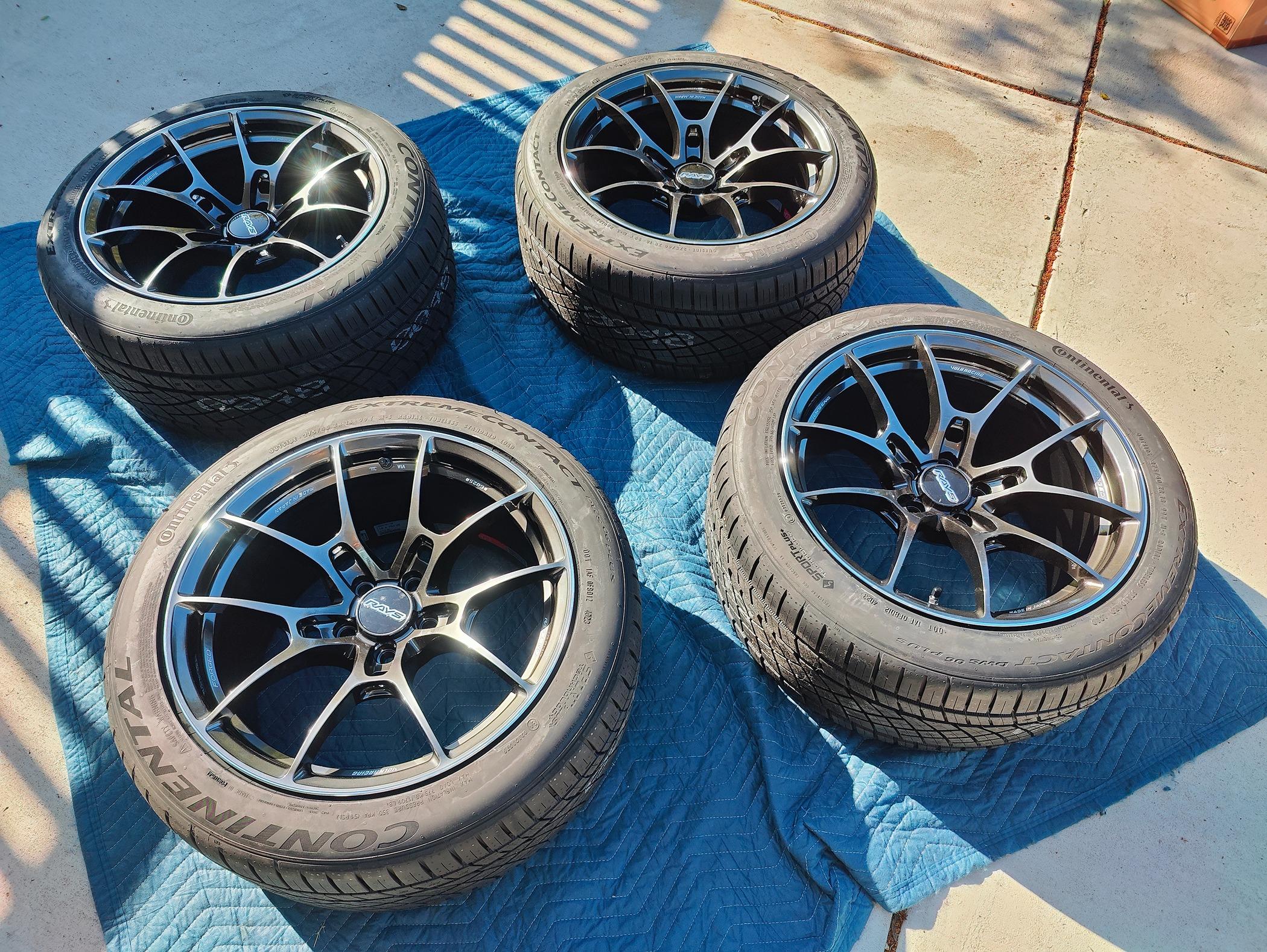

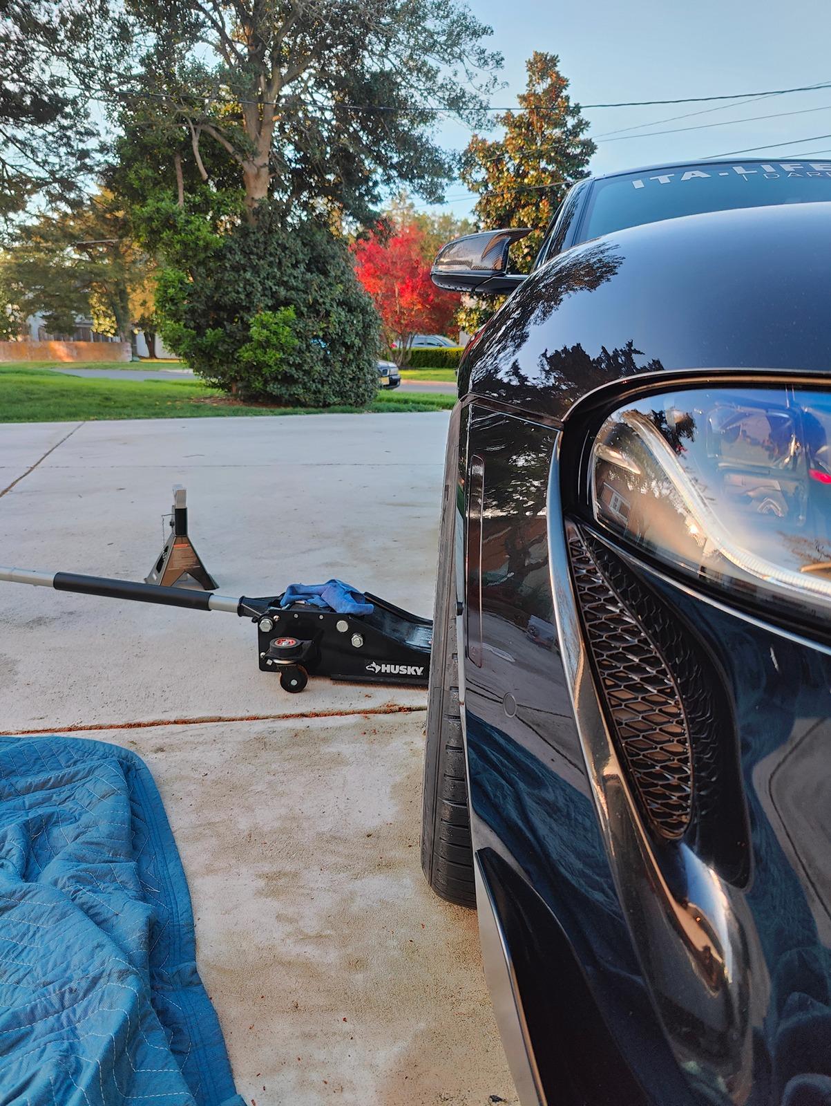

Alright first update of my first post. Starting off the aesthetic journey with some new wheels. Bought a beautiful set of Volk G025s off another member here.
Specs are 18x10 +35 squared.

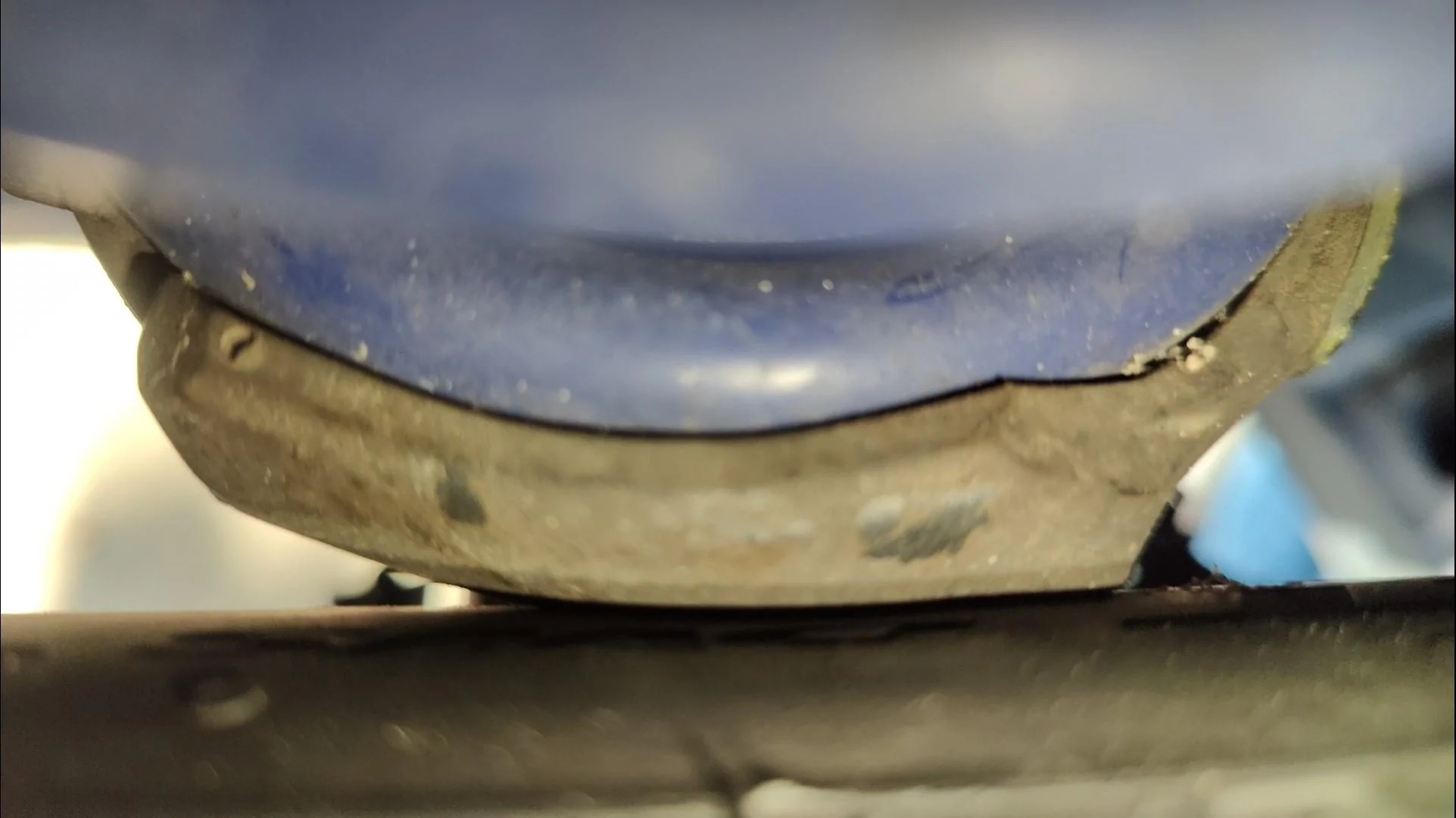

Mounted some Continental DWS 06+ in 275/40/18 hoping that it would fit with the +35 offset compared to the 18x10 +30 wheels referenced in Apex's wheel fitment guide
Sadly it was just touching the spring perch. I probably could gotten it to fit with just a bit of filing but I already had some HKS springs on the way.
Decided to test fit the wheel with the 13mm spacer still on and from the front the poke fitment isn't too bad tbh.

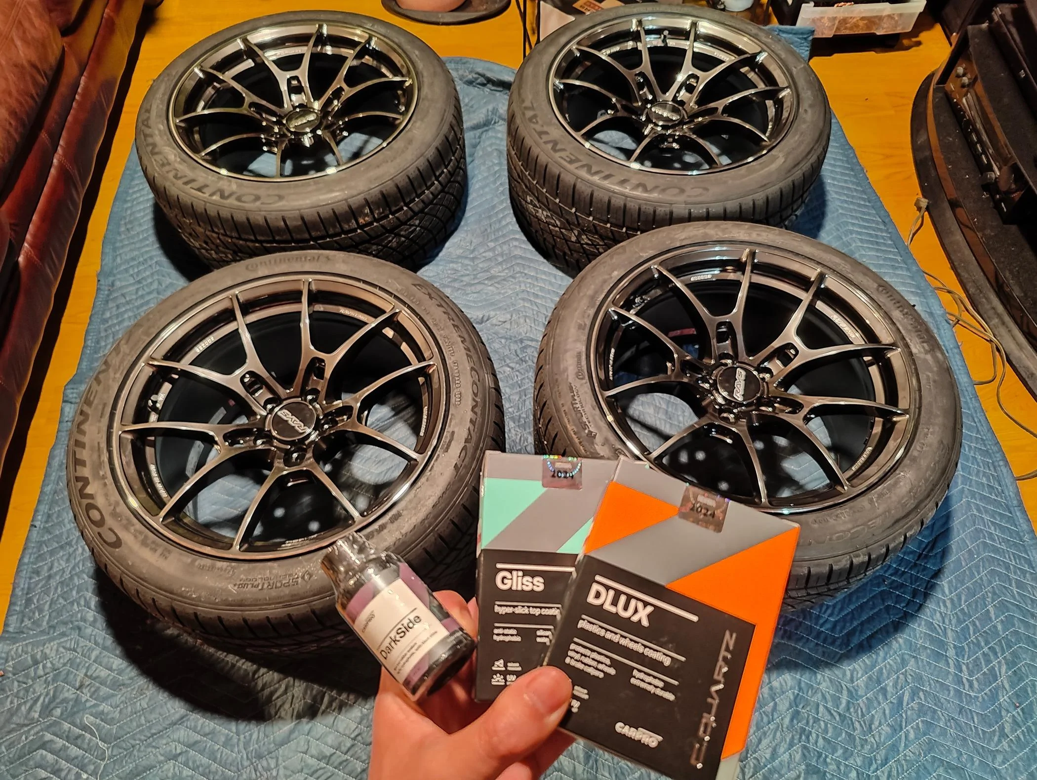

I'll probably do another test fit later at some point with the G025s and 15/13 spacers but my carpro DLUX and Gliss came in so I'll be coating them this week.
Thats all for now. Adjustable springs come in next week and met a local photographer thats eager to do a shoot. Can't wait to share what the full set looks like on the car!

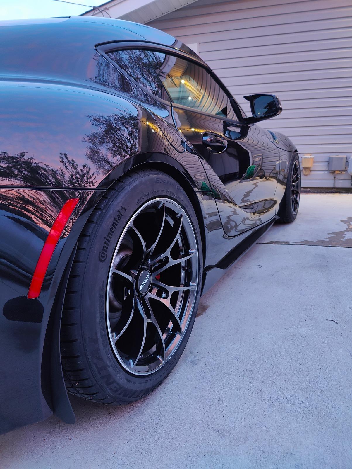

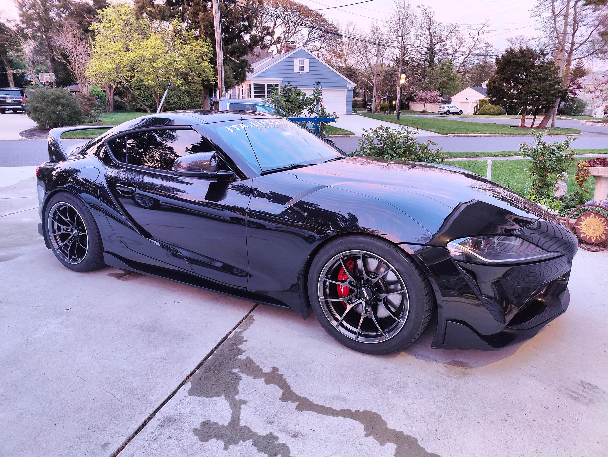

Been a bit busy but got them put on at the beginning of the week. Haven't had the chance to get my hks springs on but running them with the 13/15mm spacers on still and the poke fitment goes pretty hard.
Slight amount of rubbing on the fronts where the tread meets the sidewall and the corner of the hood that makes up part of the wheel well. Might try a combination of raising the front slightly and a 10mm spacer instead of 13.
Got a shoot planned soon but this is how she fits now.
