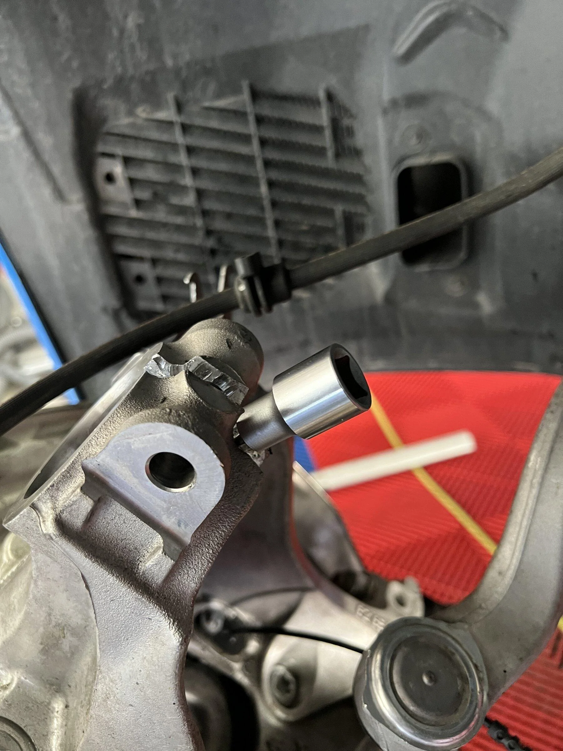

I was wondering if you guys use a knuckle spreader tool when removing the front struts? And if so which one do you use?
Callabrator
Feb 26, 2021
46
50
DFW
2021 Refraction Blue A91 Edition Supra
I used the Schwaben Spindle Spreader Tool (mfg #scw3435). But, be advised I had to put it in exactly this position or it wouldn’t spread the knuckle enough!

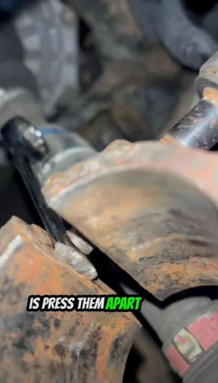

I just discovered this video that uses the knuckle threads as a press. never tried it but makes sense.
screenshot in case video goes down
