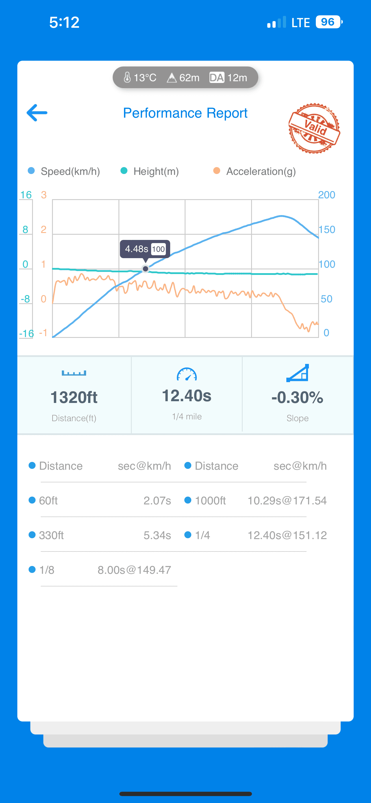

here are some stock numbers with semi worn tyres :
As you see I am running a solid 12.4 1/4 mile as a baseline to all my work the current mods in the Supra are

You only trapped 93mph stock? :-/
Yes ! Car is stock no tune , no JB4 and stock tyres and wheels and it was done on the street as well on less than perfect conditions

Hahha didn't even notice that. Yea, must have slammed on the brakes or something before the 1/4 mile.
I deff did , it was on the streets ! A little sketch after winter Iā€™ll try again without letting off when I lower it car should be a bit faster prob gain .2 seconds

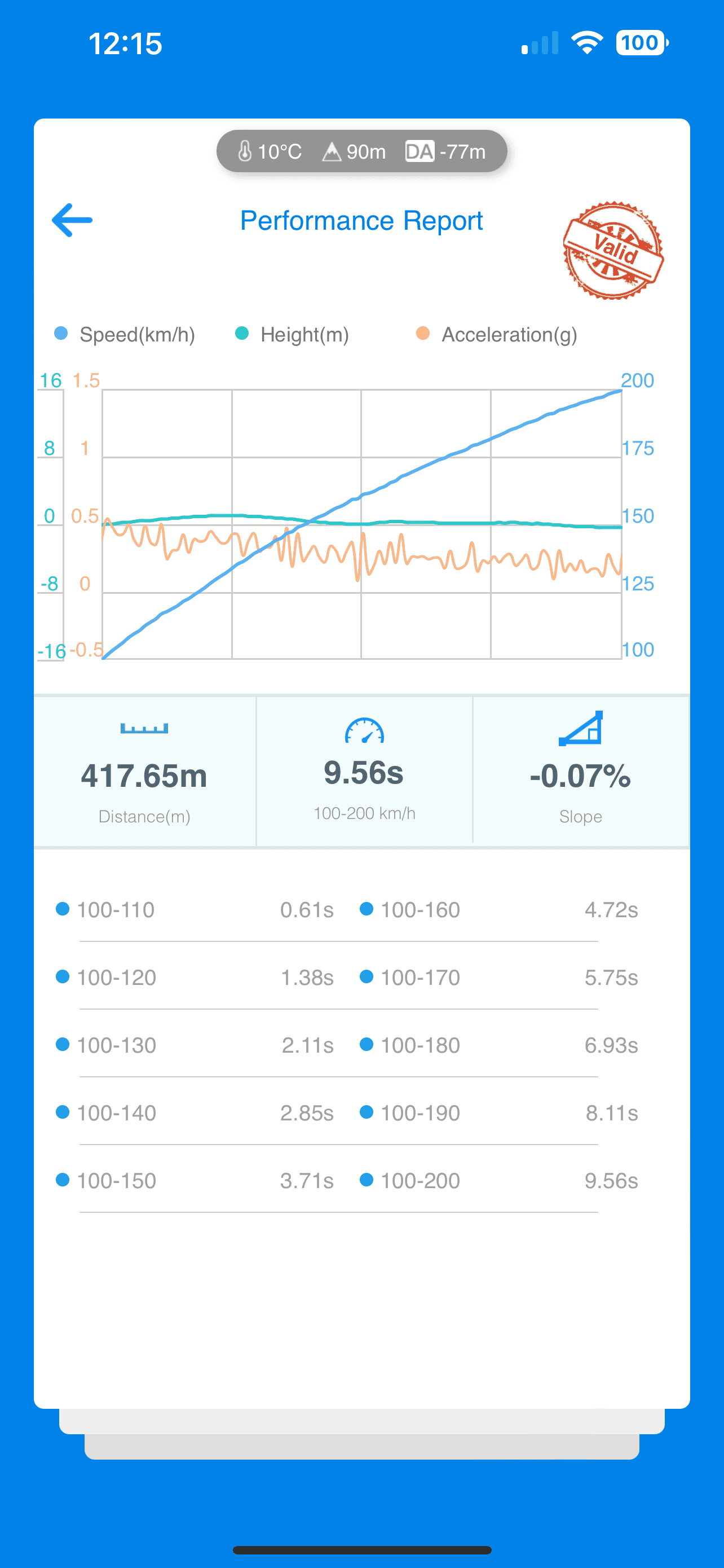

Update : here is also a 100-200 Draggy run in less than ideal conditions as well temperatures are low .
