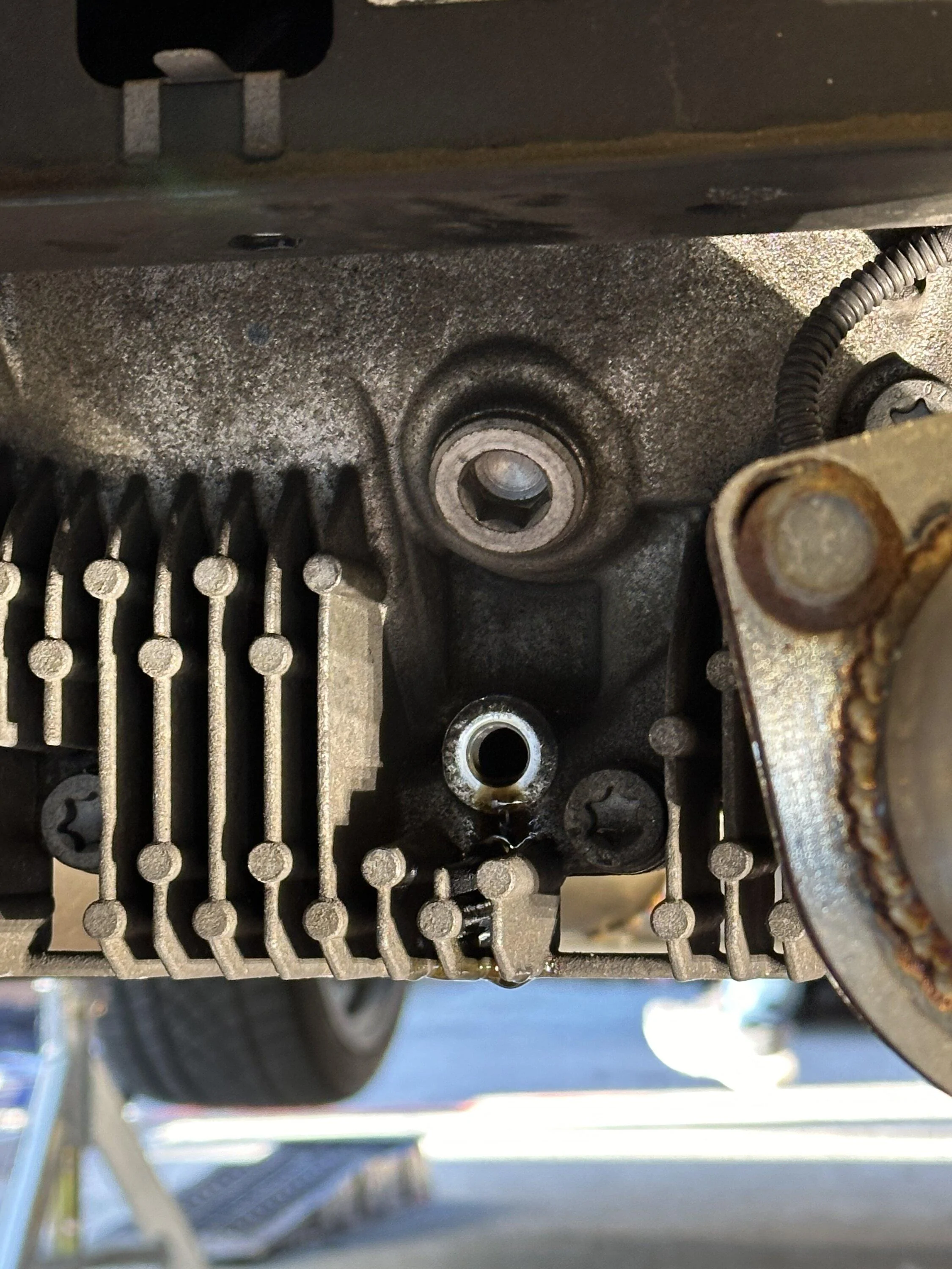

I did two diff fluid changes, on my car and my friend's car. Pretty quick procedure, give or take 10 minute job. I pour back the old fluid into the quart bottle and seems to be a little over half a quart upon inspection. I hit 40k miles last week, 2 track days last year and this is my first diff fluid change.

Thanks for the photo, Kevin. So, the fluid capacity is a bit over 1 liter, meaning half of that is left behind?

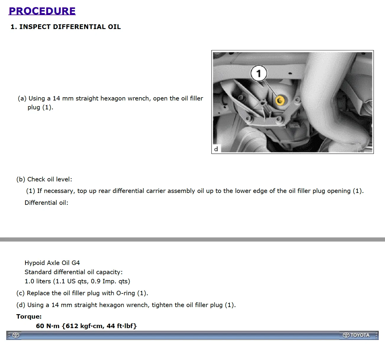

I’ve not read pages 2-19, but is this a 20 page thread on a diff leak where no one has yet taken out the diff plug to see if it’s over/under filled? (Toyota/owner/anyone?)
Seems like something simple you would want to know before continuing to drive the car around, but sure I have missed something from pages 2-19. 😀👍

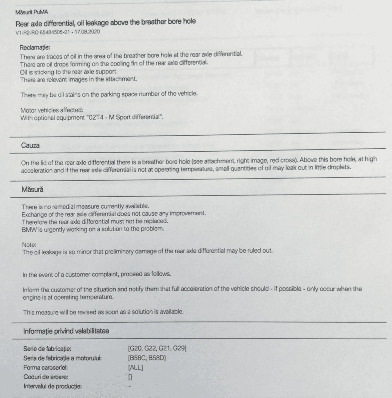

I spoke to a BMW shop tech with many years of experience with ZF transmissions. I described to him exactly what has and is happening regarding leakage of diff fluid.
He told me to keep an eye on the leakage rate. The amount that has leaked is probably 1/2-ounce.
Apparently, that is no cause for alarm. I will check the level, soon.

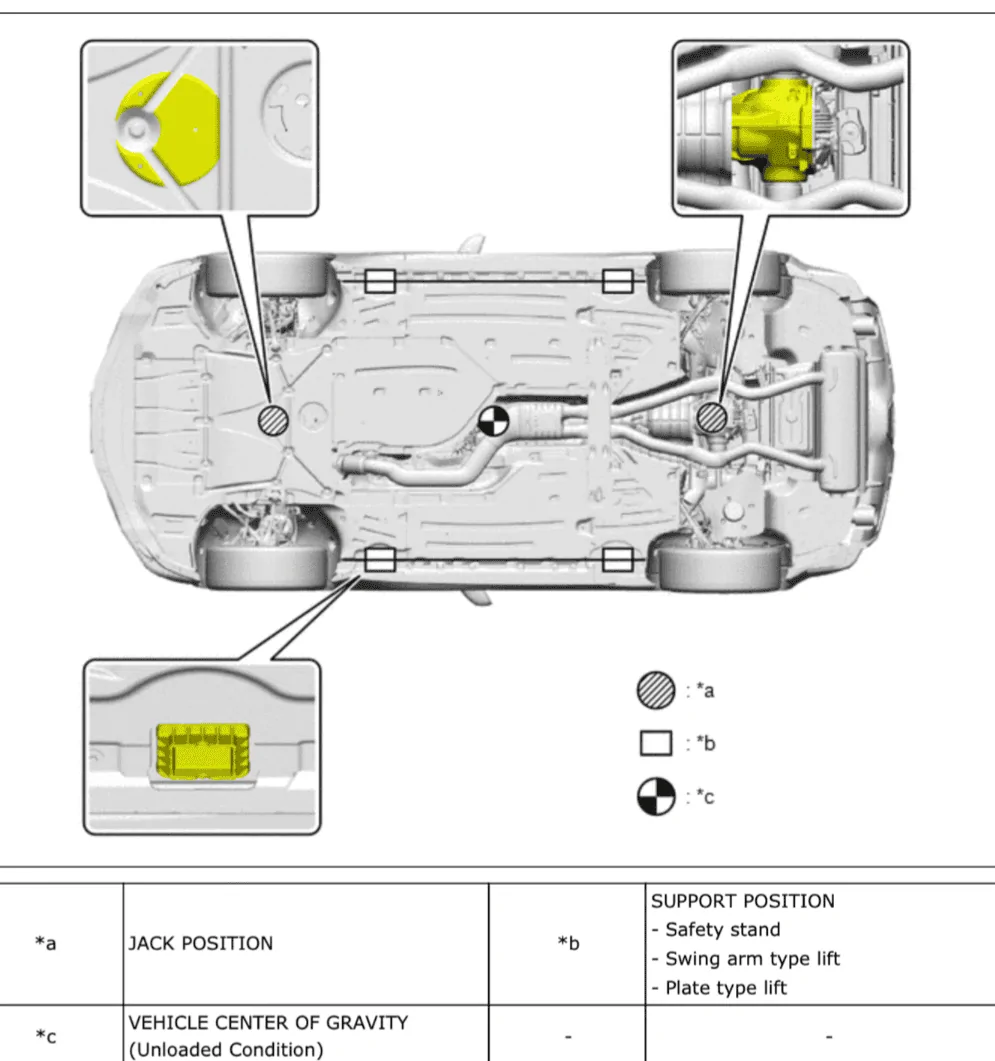

Question: I believe the rear central jacking point is the diff. Is that true? I plan to buy the tools I will need, drive the car up on home-made wooden ramps, then jack up each end before sliding a Rhino ramp under each tire.
Supra_UK_
Apr 6, 2022
669
793
Skyrim
Ex-Owner '23 GR Supra 6MT
Yes.
