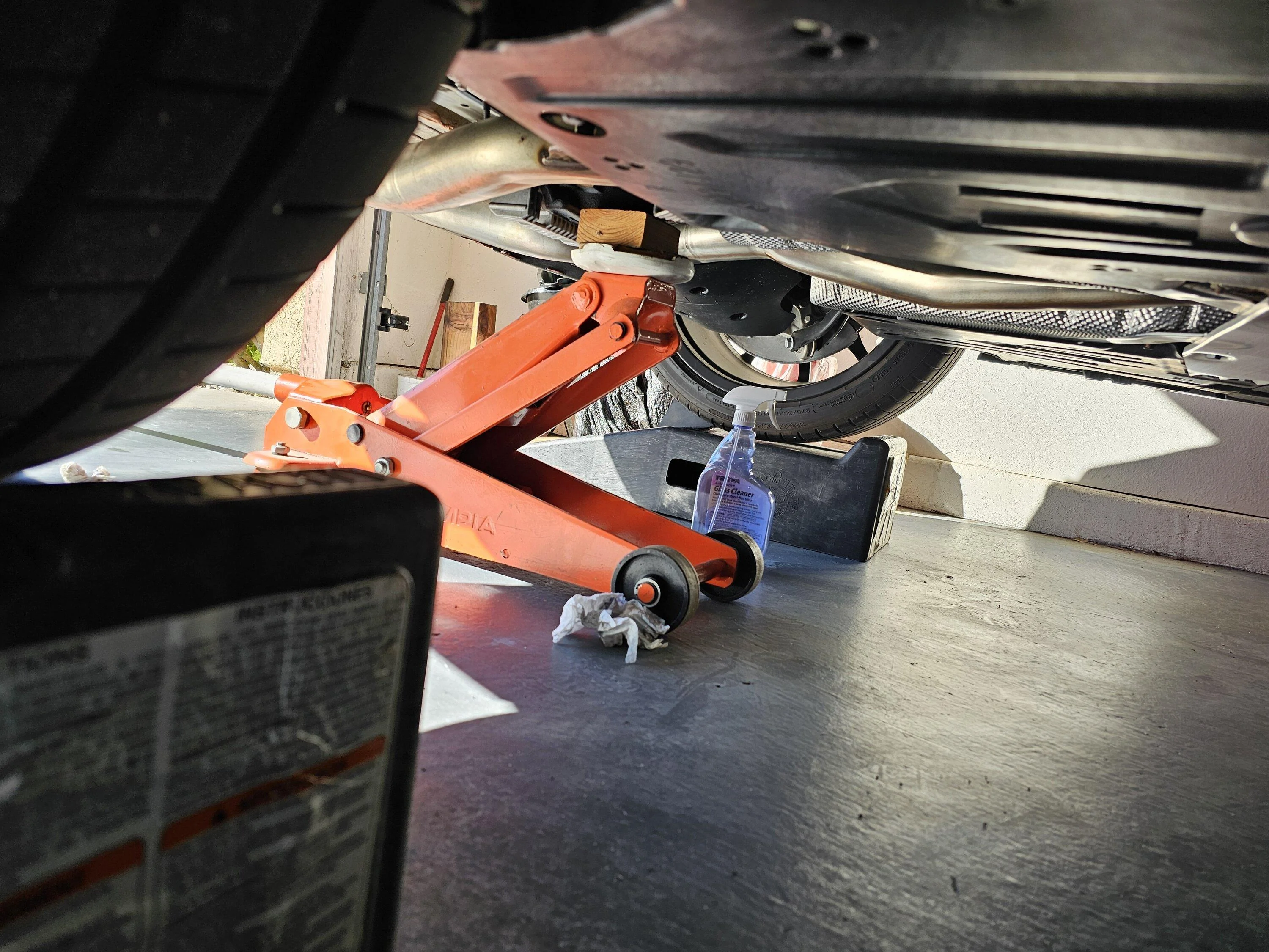

Question: I believe the rear central jacking point is the diff. Is that true? I plan to buy the tools I will need, drive the car up on home-made wooden ramps, then jack up each end before sliding a Rhino ramp under each tire.
Just make sure to only contact the black iron diff housing with the jack, as mashing your rear cover cooling fins is not acceptable. If you're coming straight in from the back of the car with the jack, you may need a small block of wood or thicker jack-pad in order to make contact behind the cover without the jack arm munching the fins.
Excellent advice! Thanks for that. :thumbsup:

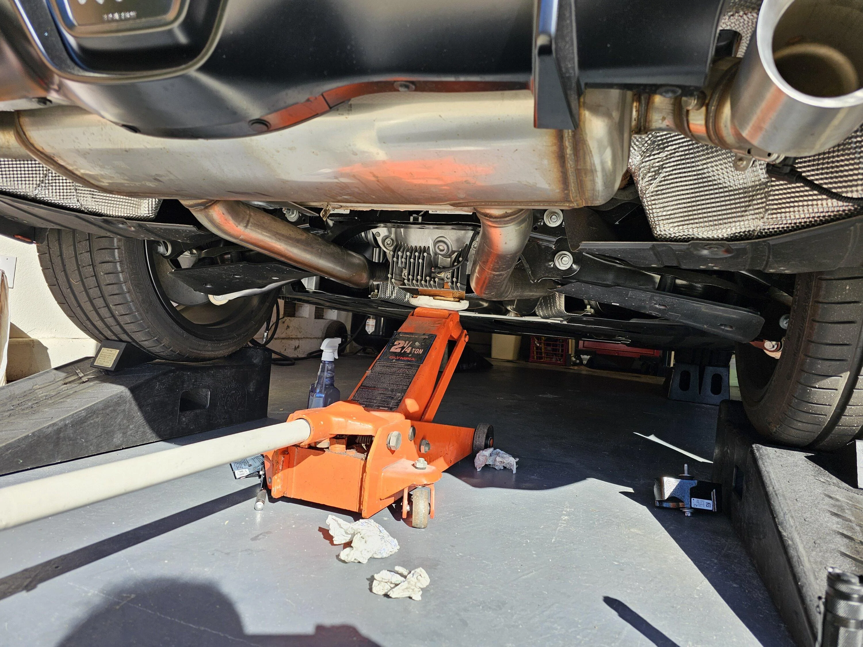

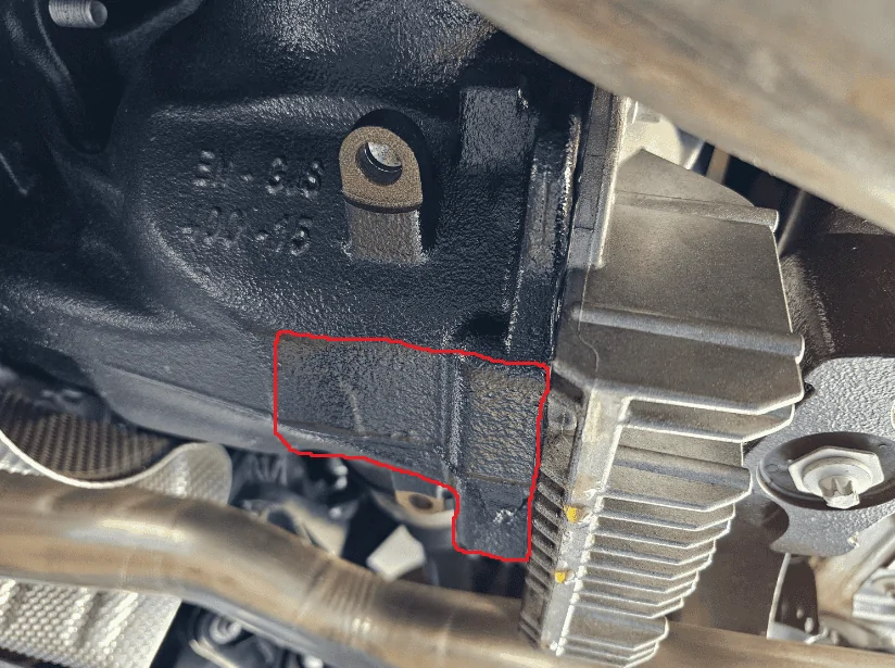

Update: Raised Supra to level, removed fill plug after 1 hour, need to buy and add fluid.
The leak seems to be coming from the driver's side axle. Leakage is not excessive (1-3 drops).

lucky phil
Phil
Jan 23, 2023
459
653
Supra GTS 2024 MT, Kia Stonic GT, Mazda CX5 GT SP
Confirmed - driver's side axle seal leak
Disappointing. Make sure you/they inspect closely the seal seating and the running surfaces for machining defects before you/they fit new seals. Sounds obvious I know but I've seen people change seals on the same component more than once when the issue wasn't the seal but the component seating and running surfaces just assuming it's a faulty seal.
