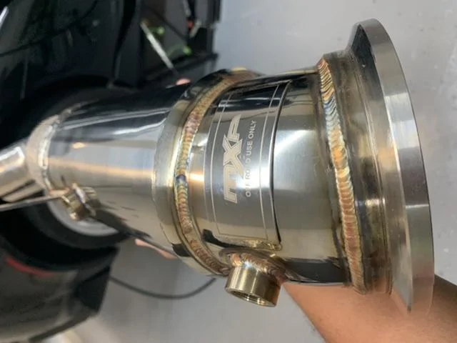

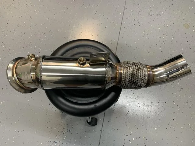

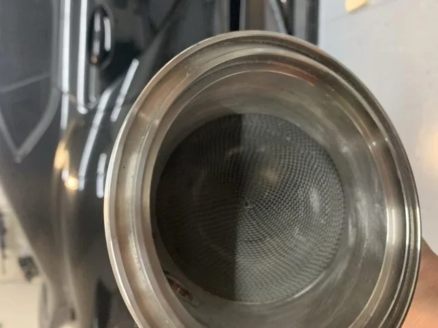

Can you post a picture of the CEL fix that's built in to yours?
He said it ultimately failed to keep light off. His code indicated that it was too far downstream and timed out.
I saw that. However I searched and found another thread where he couldn't see what the code was because it went off before he got to read it. That got me curious. Plus I'd like to see how MXP tries to handle the CEL code.
only got a couple pics before installing the dp, not sure it will help much. The code I got was 139001 - lambda probe after catalyst delayed reaction
