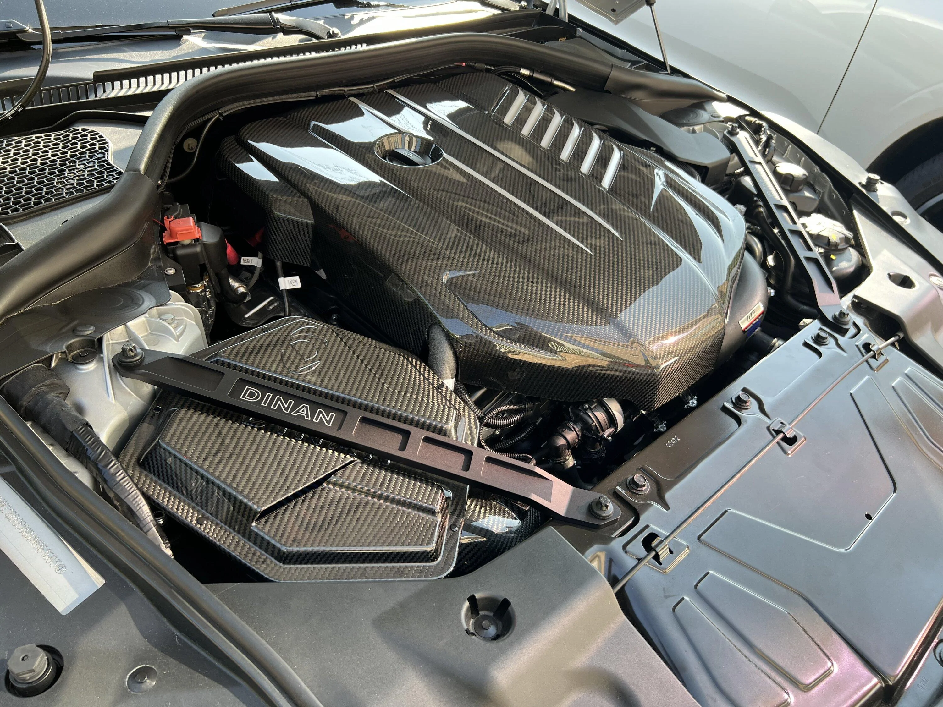

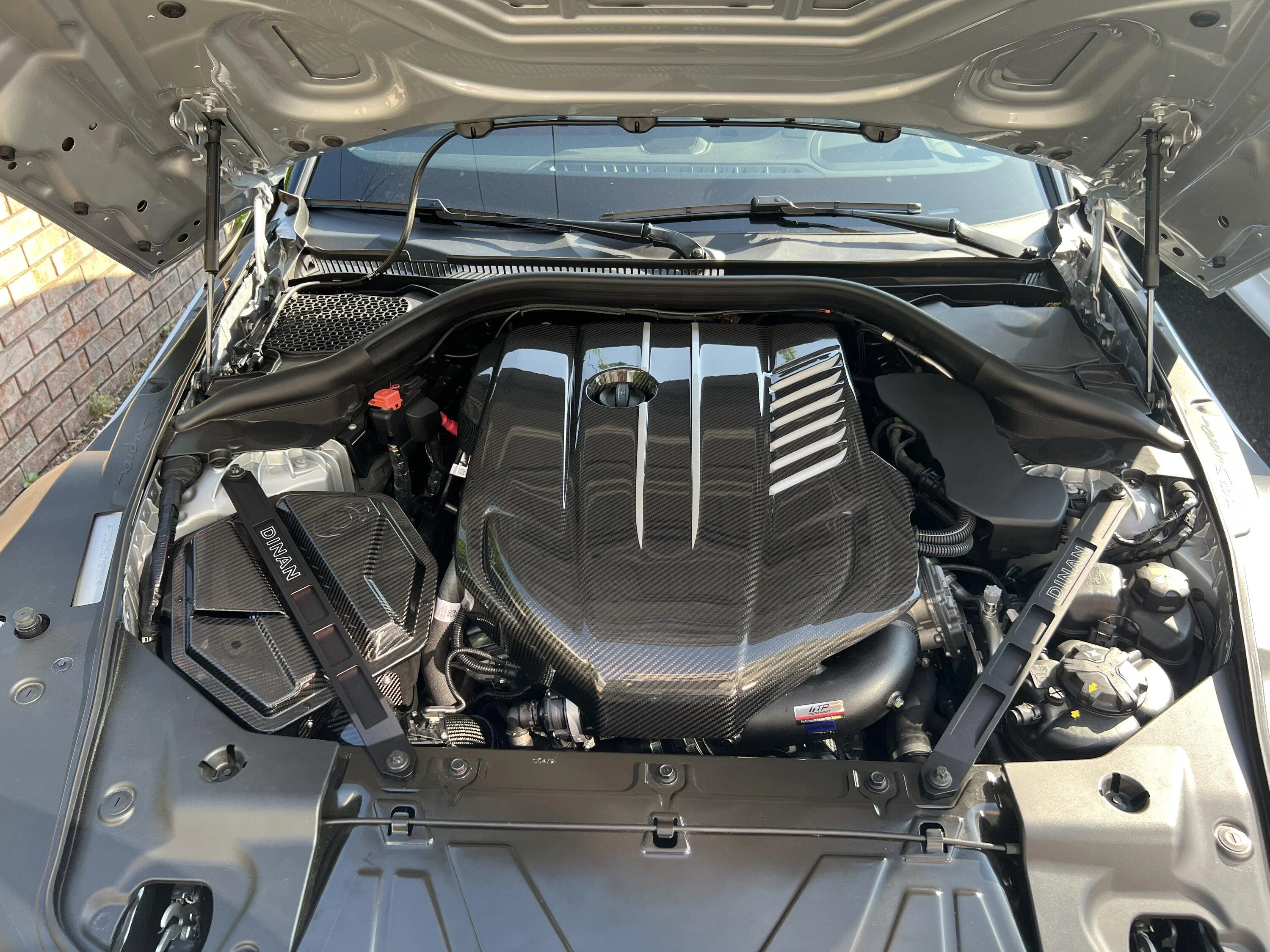

Full @Dinan_Engineering under hood with intake/inlet, struts, and engine cover looking sick!!!! Engine cover just rubs my aftermarket charge pipe hope that doesnā€™t damage it in the long runā€¦ overall super happy with these dinan parts the quality is top notch!!!

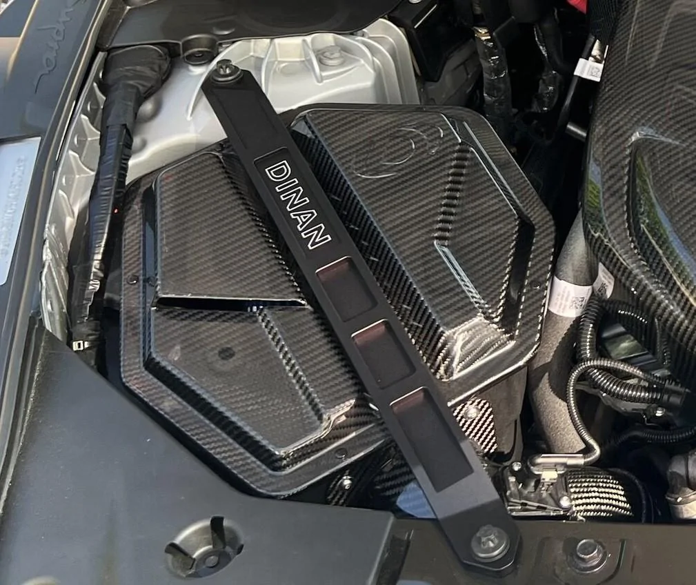

Apologies, but this fitment doesn't sit well with me at all. The lid channel isn't parallel to the brace in any of the photos, customer or manufacturer provided. It would bother me to no end. My Injen fits laser parallel with the tower brace, and I expect nothing less from anyone else in the premium product space.
I believe itā€™s intentional so the dinan logo under the brace can be seen and isnā€™t completely hiddenā€¦ i had the same thought at first but i think itā€™s because of that i could be wrong tho doesnā€™t bug me

There is a number of things that can be done to clean up the evenness but any small deviation will look exaggerated, especially at certain angles, given the channel lid-design.
  • Make sure the rubber mounting grommets from the lower air box stay in the car and are not removed with the OEM lower box. This will lead to improper sitting and the box leaning in the direction of wherever the missing grommet is located.
  • Ensure the Dinan lower box is fully seated/snapped into those mounting grommets and also in the groove where the factory inlet is or the box will sit high and/or at an improper angle.
  • The natural tendency of the system given its orientation and weight distribution is to sag slightly inward towards the engine. The best way to combat this is before tighteing down the hose clamp from the intake tube to the inlet is to push down/put some pressure on the side of the intake closest to the wheel well forcing it to sit a bit more level and then tightening the clamp. If correcting after intall just loosening that clamp and sliding the the intake tube a bit to the passenger side and then tightening the clamp will result in the same effect.
  • The brace itself has some room for "slop" and can be shifted slightly -- (ie: move the top mount as far to the left as possible and he bottom as far to the left as possible if the brace looks skewed to the right side of the channel).
