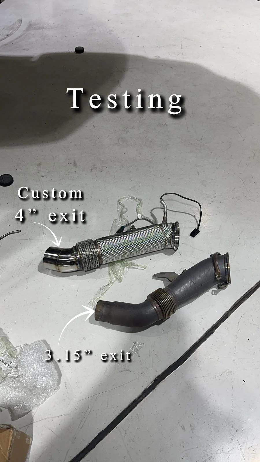

I was wondering if downpipe exit size would make any difference for stock turbo.
most aftermarket downpipes have a 3.15” exit to fit the OEM Exhaust, and hence most after market catbacks have a 3.15” connection.
ETS makes the 4” exit downpipe which fits with their 4” Catback. However, they don’t make them catless anymore, only the catted version is pffered on their website.
I saw Apex Built with 4” Exit catless downpipes, but I think it’s an AliBaba product that I can find way cheaper.
I have a 3.5” cat back, and I’m thinking of switching to a 4” Exit to smoothen the flow.
I don’t like the fact that it goes 4.5” to 3.15” then back to 3.5”. 4.5” to 4” to 3.5” makes more sense to me with a smoother tapering.

Enlarging the exit and body diameter of the DP to 4" is worth 10-20WHP on the stock turbo, depending on the tune. This is with no other changes to the vehicle except the DP swap.

Didn’t find enough answers so I decided I’ll give it a try myself. I’m trying Ali Express for the first time, asked them to make a custom DP. Will see how it ends up and will update once I install everything 😂. My car has an RK Titanium Signature Single Exit, which is 3.5” should be smoother with the 4”.

Hello again, just finished installing the 4” Exit DP, you can find everything in the video (which I can’t upload here, it says it’s too large, so DM me on Instagram: FahadB5). Apart from a cold start with the new DP.
Verdict: Mission Failed successfully
-Not much of a difference in sound, however, you can hear the turbo spool ever so slightly.
- Smoother Idle
- I used to have alot of metal to metal crackling inside the car at idle and low speeds. It’s completely gone now (for now at least)
Solution: Big Turbo with an external waste gate

picture for reference
