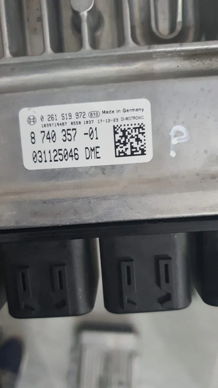

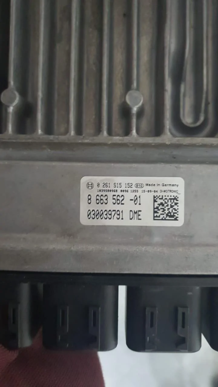

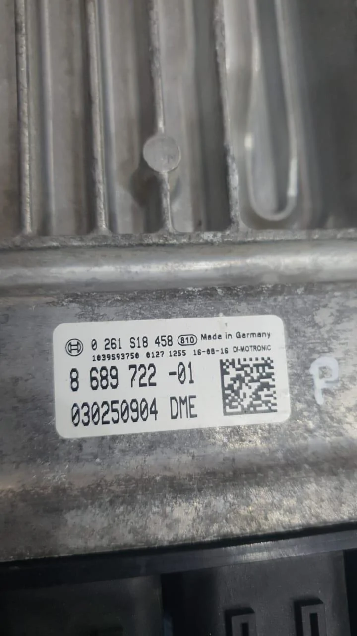

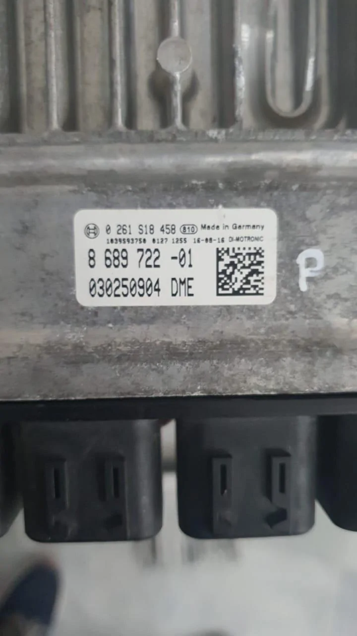

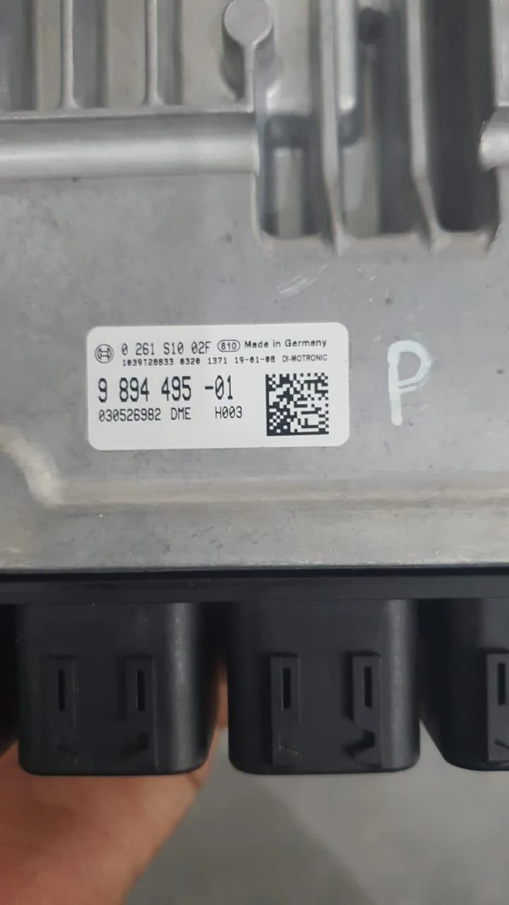

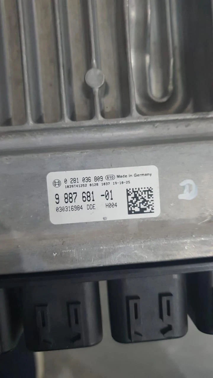

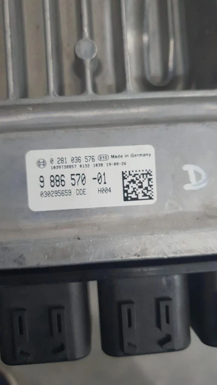

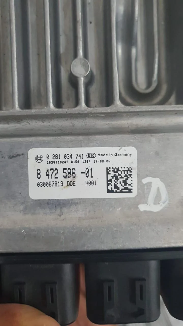

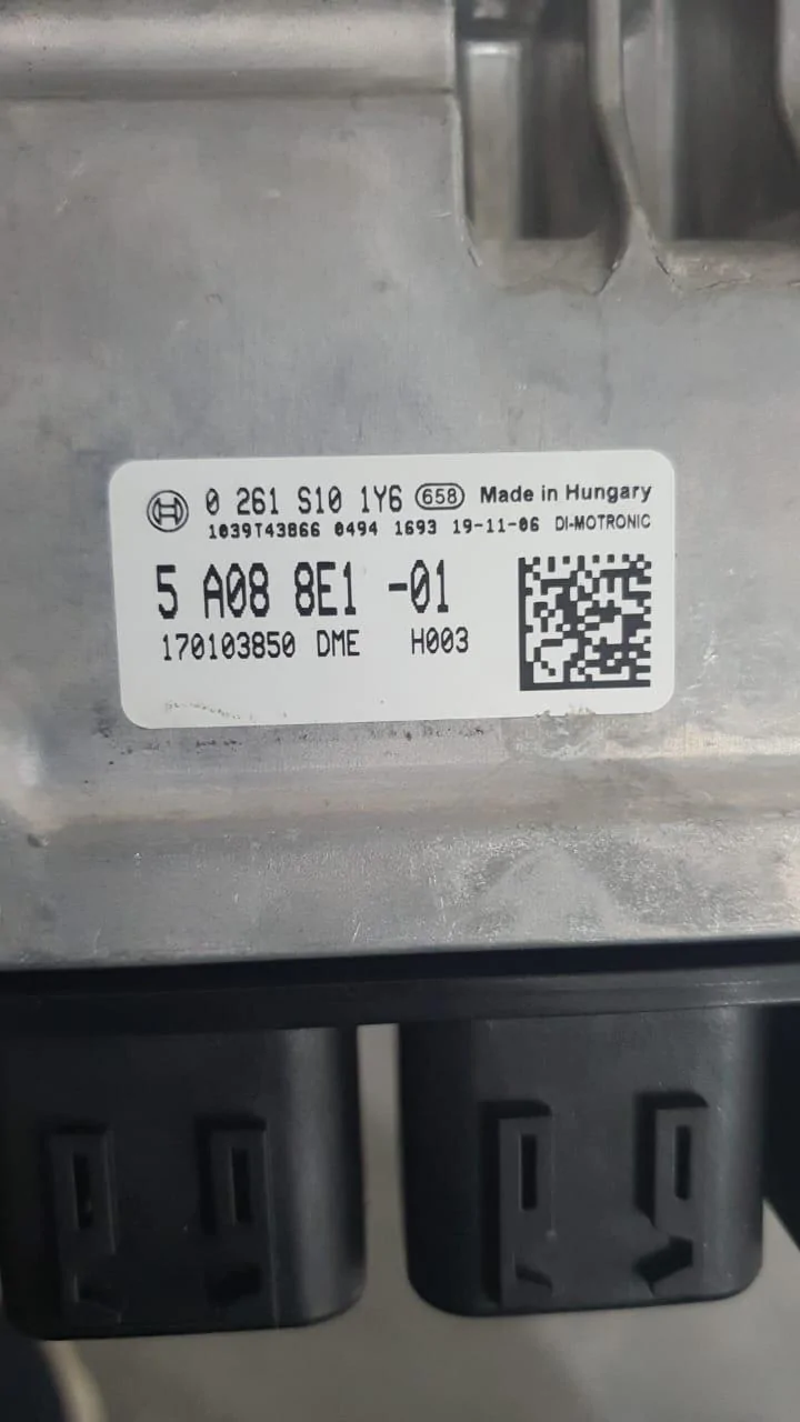

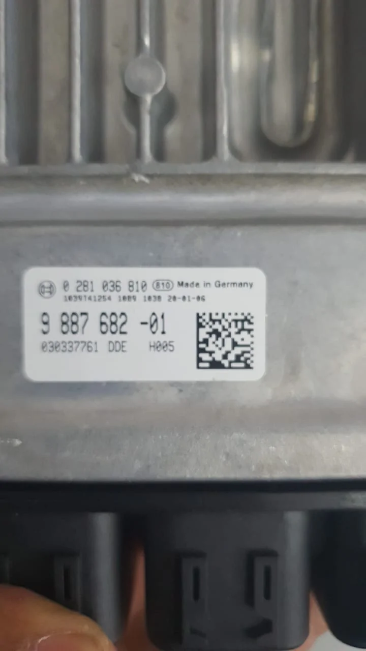

Hello, I was hoping that someone could shed some light on how to tell if an ECU is compatible with the Supra. I only know how to check the production date, but unfortunately do not have a VIN or car details. Any help would be appreciated as I am slightly clueless and could end up buying the wrong thing.
For context, these are from a second hand parts shop.

Sorry to say but these are all bad AFAIK. I might be wrong but I've been looking at compatible ECUs for way too long.
An easy way to weed 90% of non compatible ECUs out are either the dates and the beginning text. 0261 are petrol/gasoline ECUs, while 0281 are diesel. This probably isn't a rule, but that's what I've noticed.
The middle text, like S10, usually signifies that its a modern ECU. However, there's a good chance it's B38, or B48.
Good numbers: 0261S1030V, 0261S100AS, 0261S100H1, 0261S1004F, 0261S22184, 0261S1012V, 0261S21892, 0261S101Y9, 0261S1002G, 0261S1011K, 0261S100DT. There are some 0261S103G4 that are late 05/20, but you don't find them often.
There's probably more ECU codes, but these are all the ones I've seen.

Edit: I take it back, none are compatible. A closer look at the ones I mentioned below, they look like B48 DMEs. Best to take a picture with the whole thing in there.
The 0261S101Y6 and 0261S1002F are good.
Anything that says DDE is Digital Diesel Electronics.
The ones with the larger font are typically for previous gen B58 (not compatible).

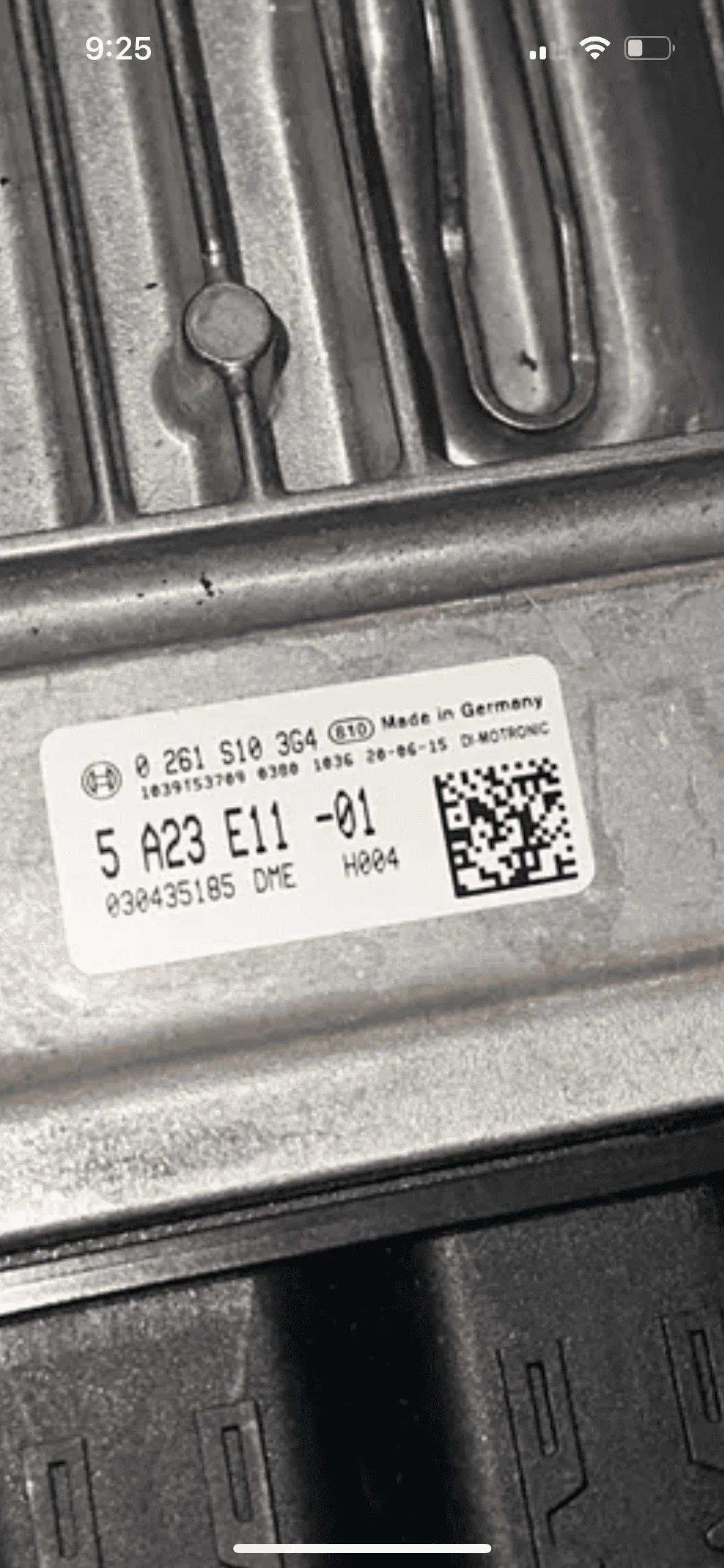

Nice list, it lines up with mine as well.
9454494 - 0261S22184 ; X5
9846393 - 0261S1011K ; X7
9894831 - 0261S1004F ; Supra, 740i, M340i
9798786 - 0261S100AS ; Supra
9846600 - 0261S1012A ; Supra
9846689 - 0261S1012V ; M340i, X5, 540i
5A1CE35 - 0261S1030V ; M340i, Supra
5A1CE65 - 0261S1030M ; M340i
9844140 - 0261S100DT ; M340i, X3, 840i
5A088E5 - 0261S101Y9 ; X5
5A23E11 - 0261S103G4 ; X6
9894496 - 0261S1002G ; Z4

I believe this is from an x6 but right on the deadline would it work for my 21 Supra
