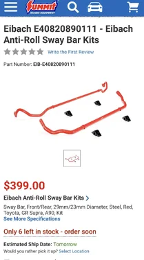

I just ordered this front and rear sway bar kit based on the feedback here. Paired with my Eibach springs, Iā€™m looking forward to an even better handling experience!

Handles great- go cart like.
You do lose the smooth ride

I have them set on firmest holes for the track. You can try the softer hole. easy to change once installed. But yes together with the springs it is not a comfy eat up the miles type ride anymore.
But i have very little roll in the corners and esses
trade offs....
