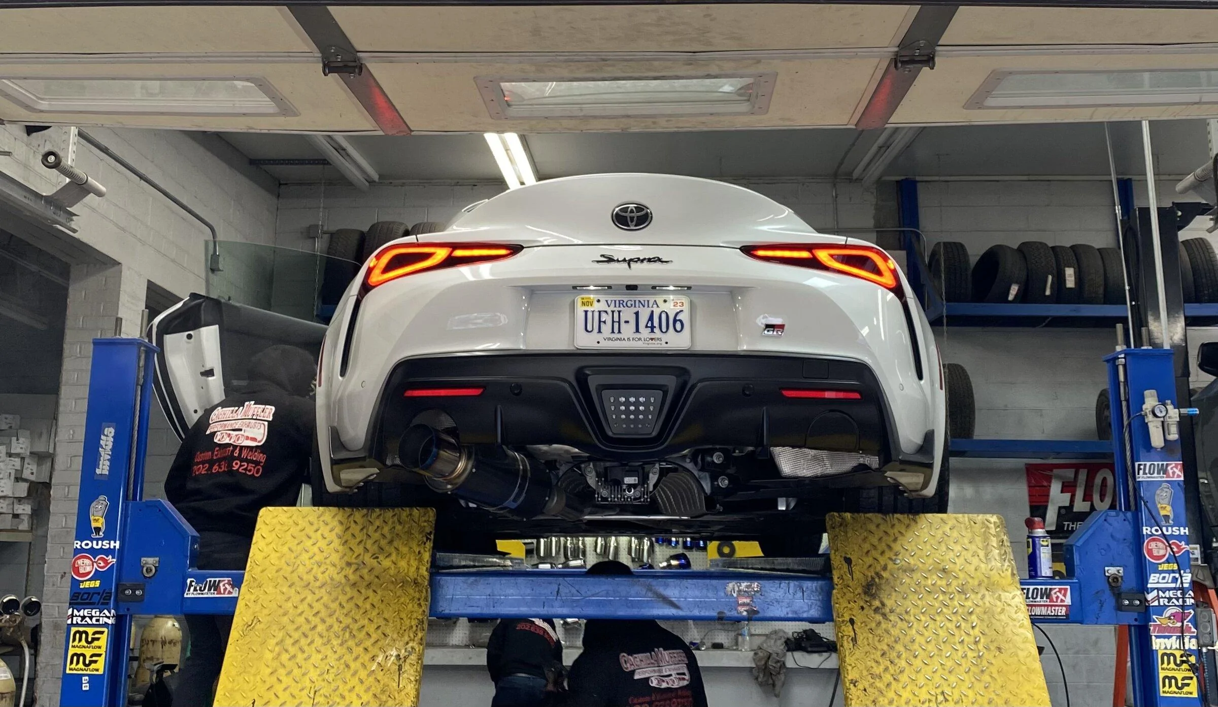

I didn't much like either the Tomei or the RK system so I had a local shop fabricate a custom 3" stainless steel single exit system using an HKS Carbon-Ti muffler. It was very cost-effective, something like $900 or so all in with the muffler. Wasn't remotely worth the extra coin to bother with titanium. Some titanium mufflers like the Greddy RS-Ti have a steel flange to make it easier to weld up to steel piping.
The sound is fantastic in my view. At first I thought it was RB26-like and maybe it is outside the car. I think it sounds more like a Mk4 to me. It can be a bit droney but I think it could be solved with a $100 resonator.

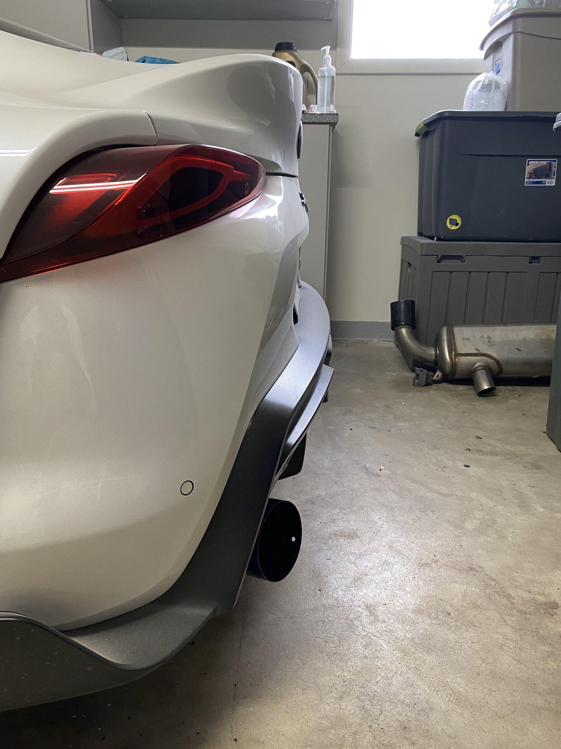

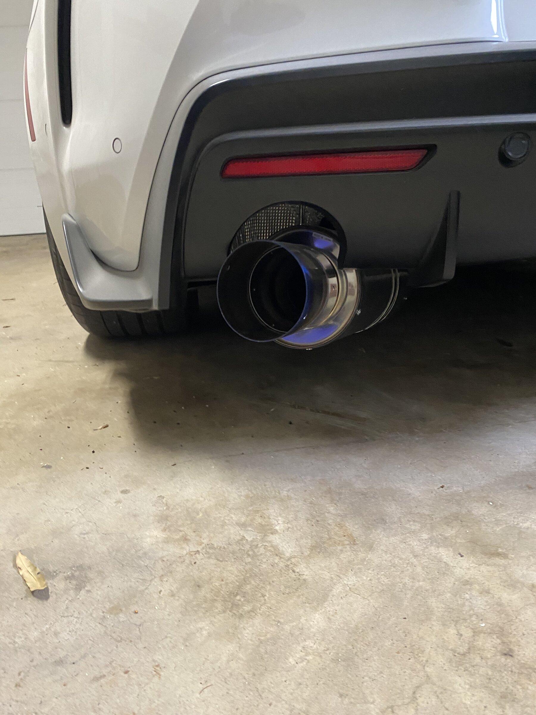

Yep. It will not fit under the car unless it's angled. Let me attach some pictures. Probably could've gotten it to tuck under better but I'm happy with it for now.
The tip is titanium and I think the inlet piping is steel, which makes welding much easier because it's rare to find a shop that can work titanium.
Thanks for the pics. I do like how that setup is! Im really leaning on this.
