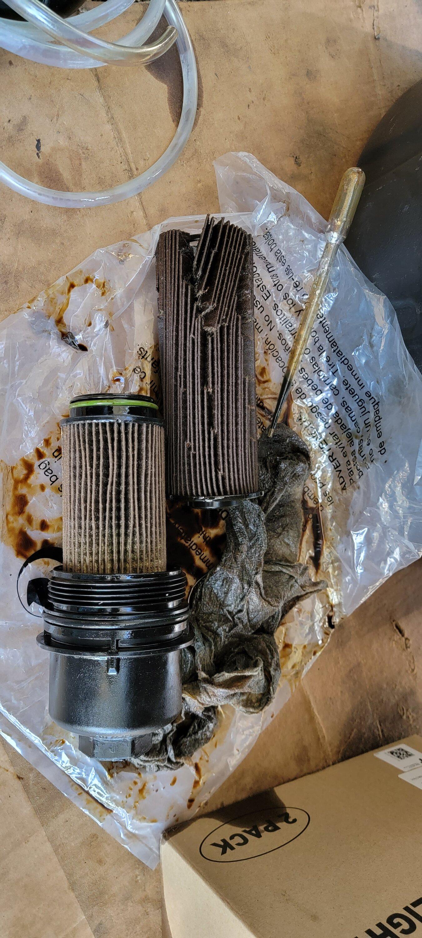

Not too long ago, I had to change oil from non-supra B58 engine which also uses same oil & filter. All was going as expected until I pulled out oil filter.
old filter was torn and missing bottom part. The construction of the filter is, basically, paper and plastic column in the middle so i heard it is common problem if you apply excessive force to open oil filter cap. But in this case, I did not use any force which lead me to believe that it was already broken and previous mechanic, cut the bottom of the filter to put this filter in. I tried to fish it out but the bottom part was stuck and won't come out and cannot put new one in because filter cap won't close as is. Easy 20 min. oil change was going over hours of figuring out what to do... Also.. used spoid to syphon out all the remaining oil in oil filter container.

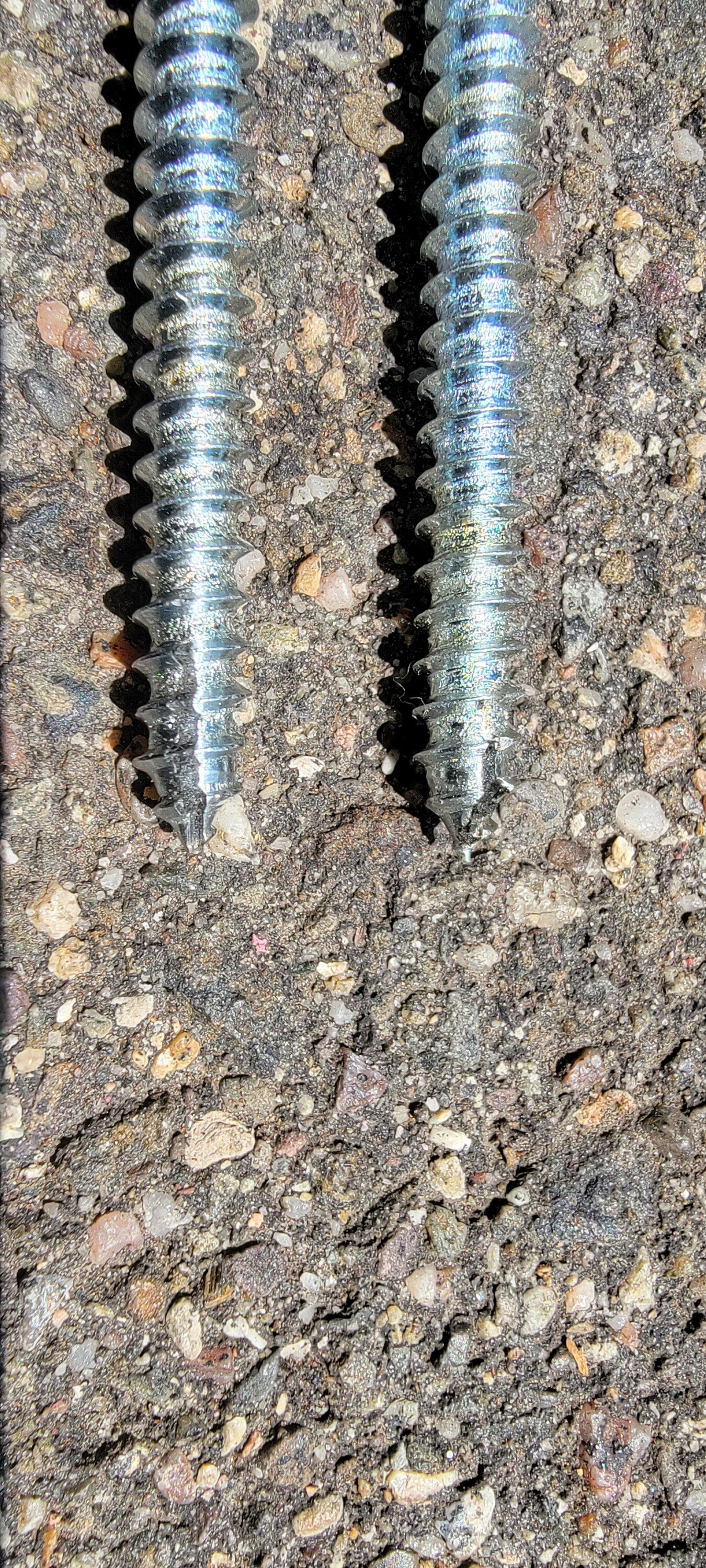

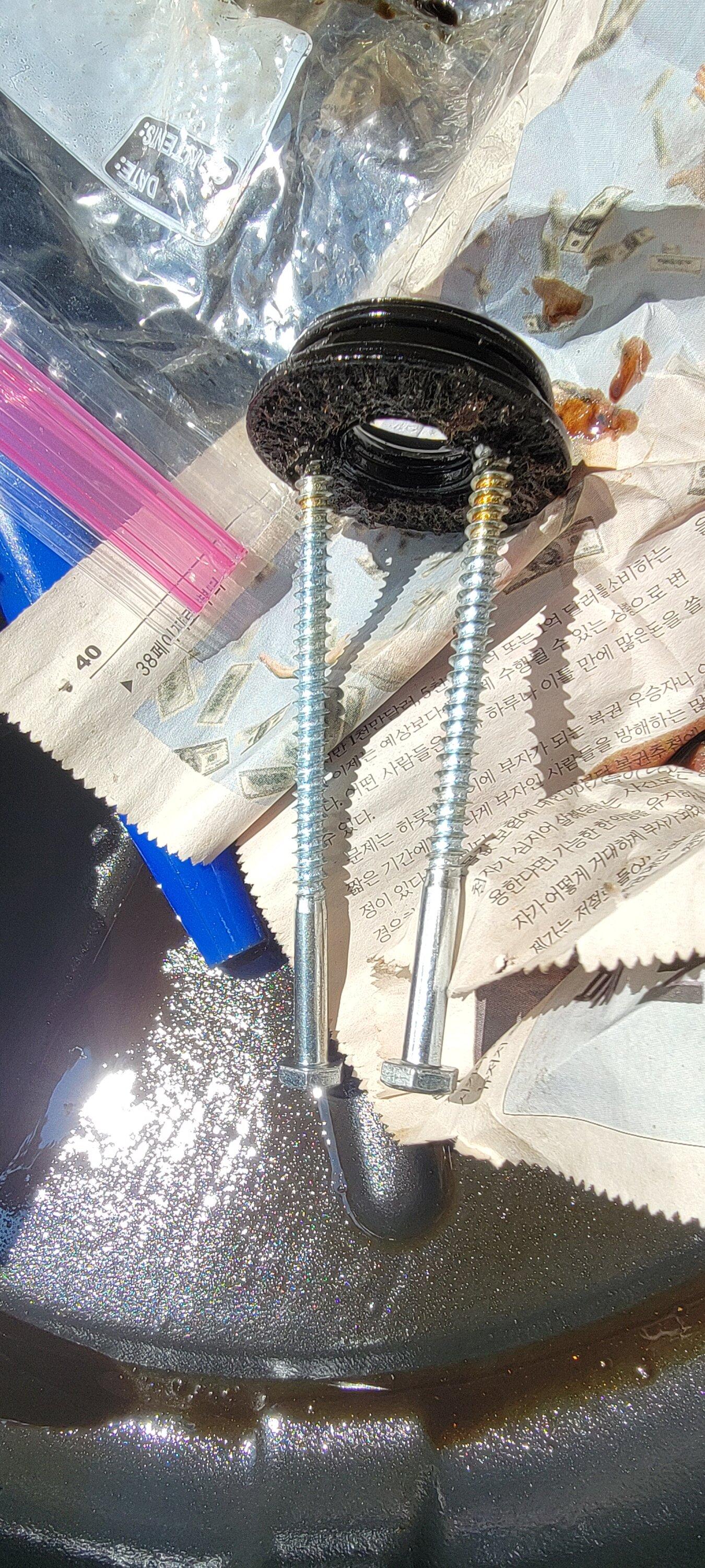

So I went down to home depot and bought screws as long as I can get, 4 1/2 inches long.. and used angle grinder to made slit at the end of the tip to look somewhat like self-tapping screw.
Then screwed it to the bottom part in the container to take it out.
it went in quite a bit that I had to use tool to unscrew it from the broken piece. 4 1/2 was long enough but I would've preferred 5 inches. I hope it helps if it ever happens to you.

To me, it looks like oil filter was INSTALLED
Improperly, that doesn’t look like it was
REMOVED improperly!

If you don't properly seat the filter in the top cap part then the filter pleats at the bottom can get crushed when you screw the cap on. User error.

That's my assessment. - The previous mechanic broke the filter while removing it and then, instead of removing broken part, cut the bottom of new filter to install it. And then it was my turn to change oil with this mess. at least I know I did this one right.

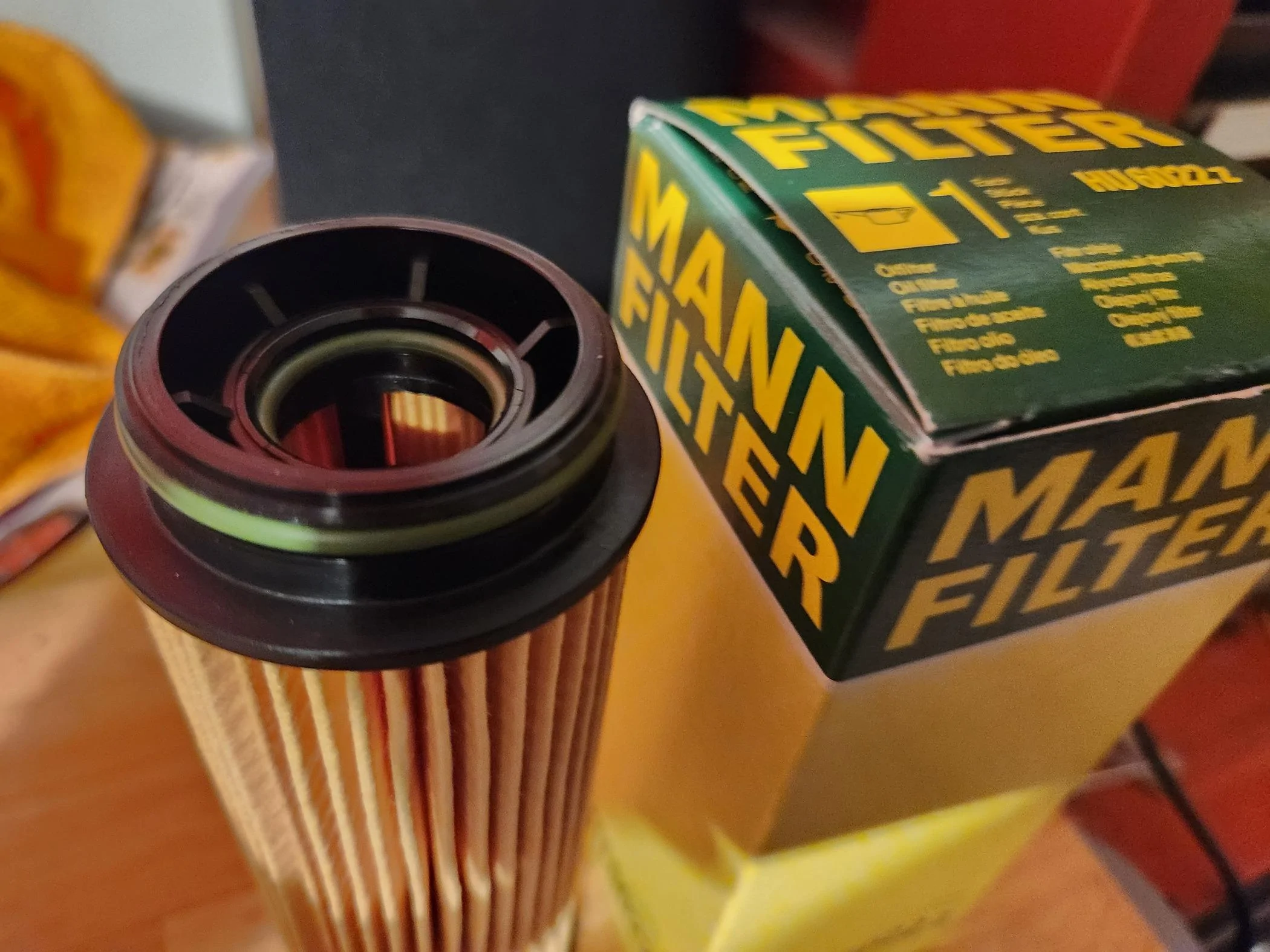

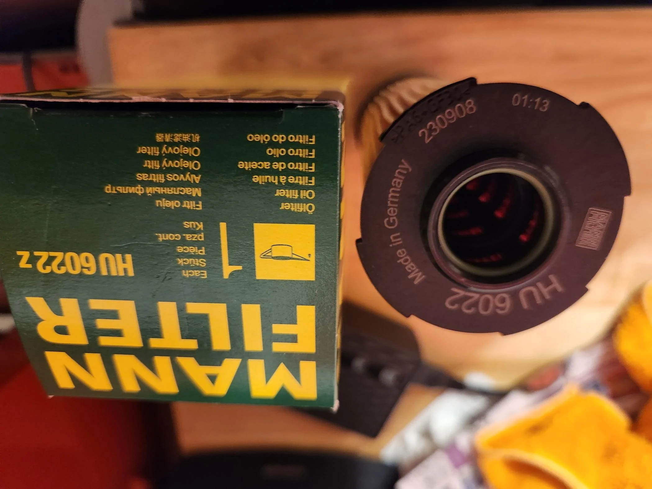

I noticed that the HU 6022 Z Mann filter I just received has the same green o rings (see attached photo). Is it possible that these are counterfeit units? Are they supposed to be black?

Chartreuse o-rings usually indicate FKM/viton, which communicates durability in the presence of ethanol. All the Mann filters I've ever purchased have been green.

Okay guys...feeling better about using this filter. It seems to be holding up to the twist test. Thanks for the info.

Viton/FKM orings biggest advantage in engine applications is their high temperature capability of around 400deg F (205 deg C) . The commonly found Nitrile o-rings upper temp limit is around 250 deg F (120 deg C) which can be exceeded locally in various parts of the engine cylinder head. having said that Nitrile o-rings have a small low temperature range advantage. Viton/FKM also have a chemical advantage and are resistant to gasoline and other fluids which Nitrile are not. Nitrile swells in gasoline which is ok in a static application but not in a moving application in Gasoline. When you disassemble a gasoline component that uses nitrile seals and o-rings you find the seal/o-ring has swelled and is not usually re-useable.
