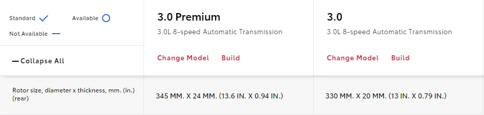

I've heard that for 2023 the 3.0 base has the same size brakes as the 3.0 premium?
Can anyone confirm if that's true?
Toyota's official page says they're still smaller on the base, but the official page also says that the base doesn't get red calipers (which they do).

toyota should do a better clarifying this detail.
my understanding is the same as above.
3.0 manual gets the same red calipers and larger rear rotors as the 3.0 premium.
3.0 (base) automatic gets the unpainted calipers and smaller rear rotors.
not sure why toyota gave the manual a premium treatment as they cost the same as the automatic.
when you go on toyota's site and build, the picture of the car will change based on the trim you select. you can tell if the calipers are red or silver. silver calipers will get the smaller rear rotors.

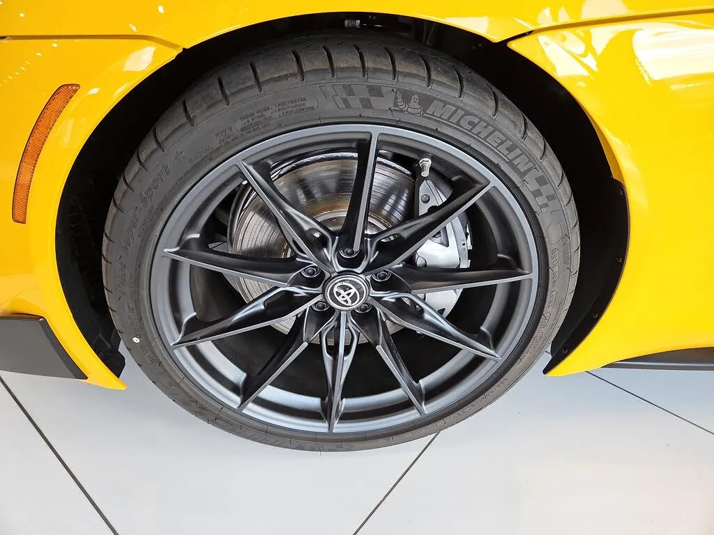

23' 3.0 base with zero options here. Have the silver calipers as well
