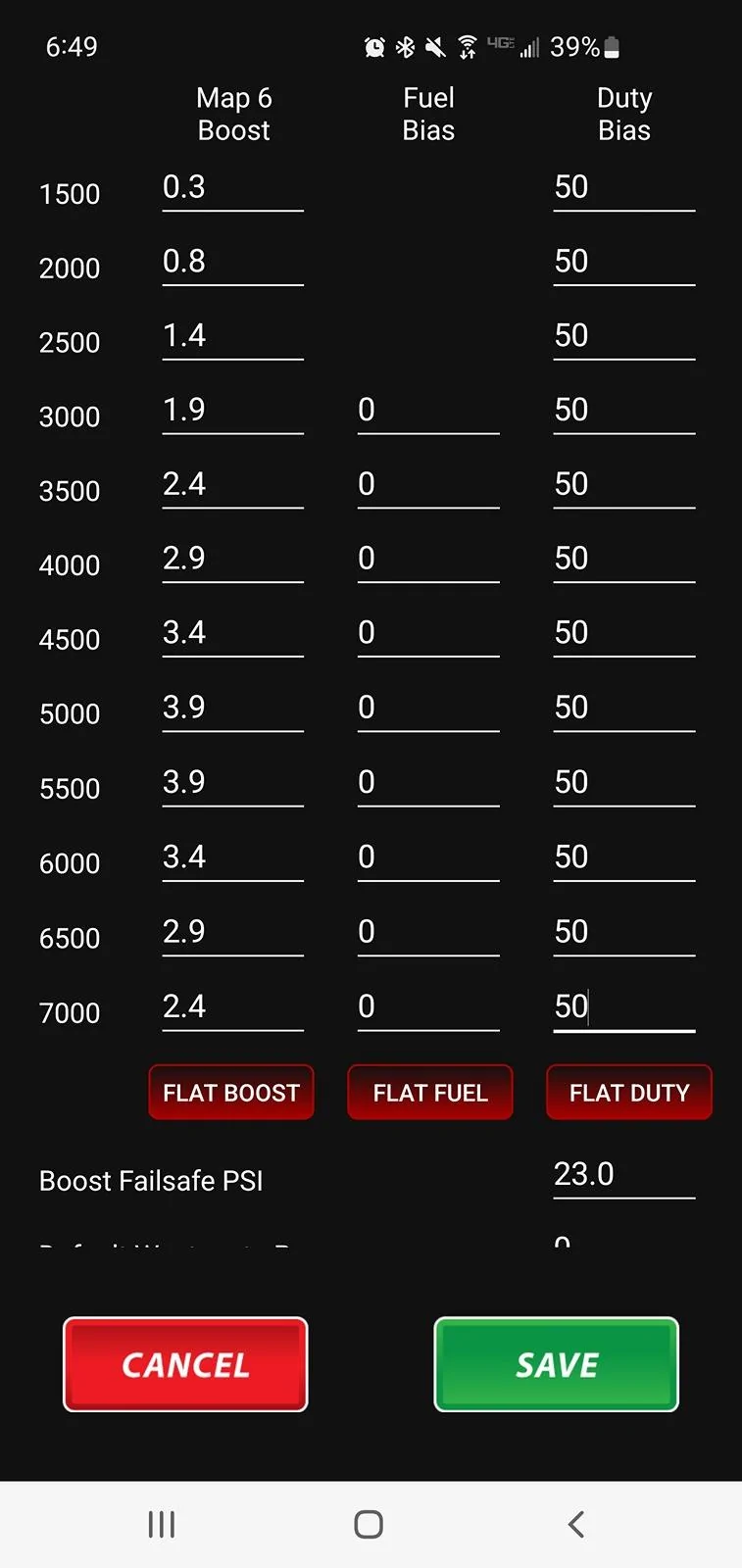

Looks pretty good! Timing is perfect (that's why we love our ethanol around here). Lets try to get boost closer to target though. Going to try to fit your FF curve to the WGDC a bit better.
duty_15duty_20duty_25duty_30duty_35duty_40duty_45duty_50duty_55duty_60duty_65duty_70
50​
50​
50​
50​
50​
50​
55​
60​
60​
60​
55​
55​
50​
50​
50​
50​
50​
50​
55​
60​
60​
60​
55​
55​
Awesome! I will try the changes after work and log. Thank you so much man!
