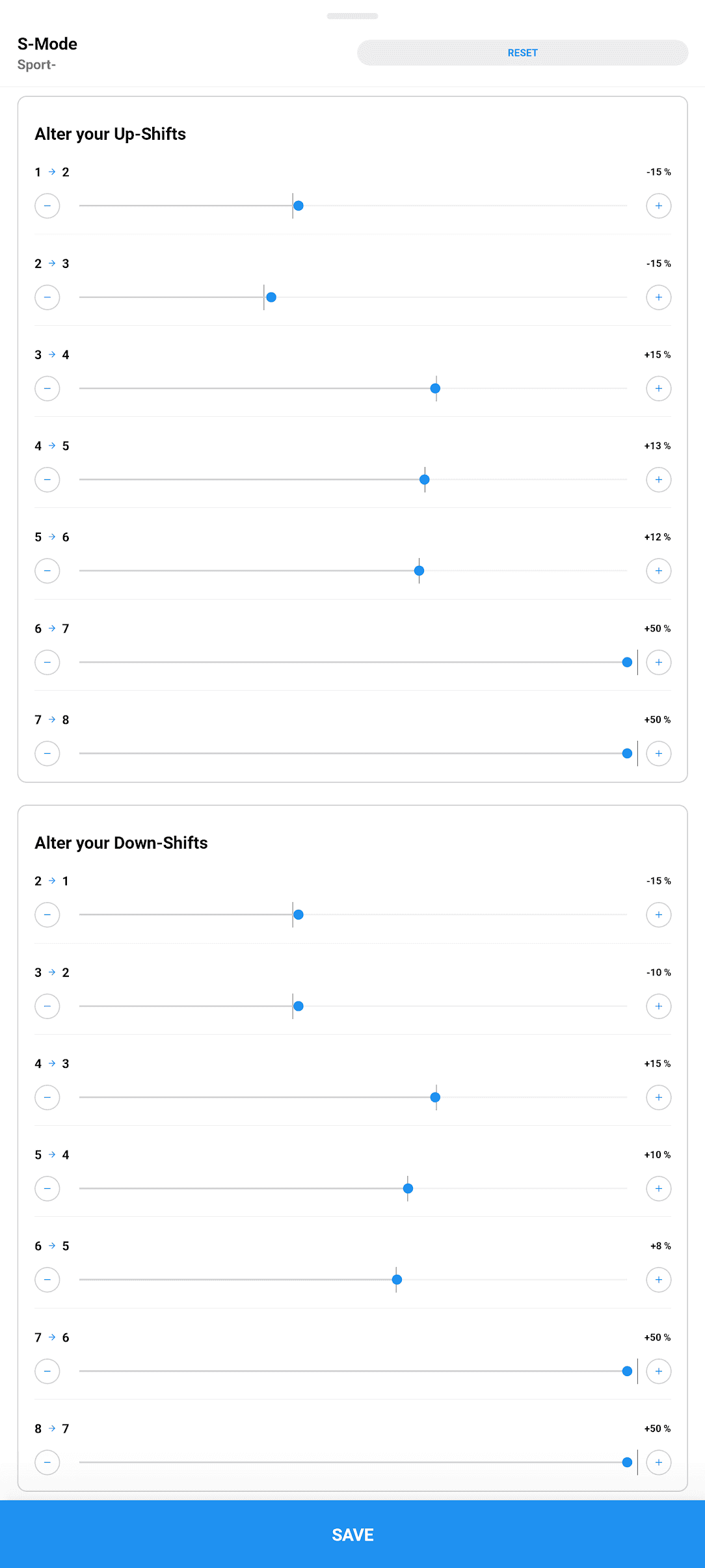

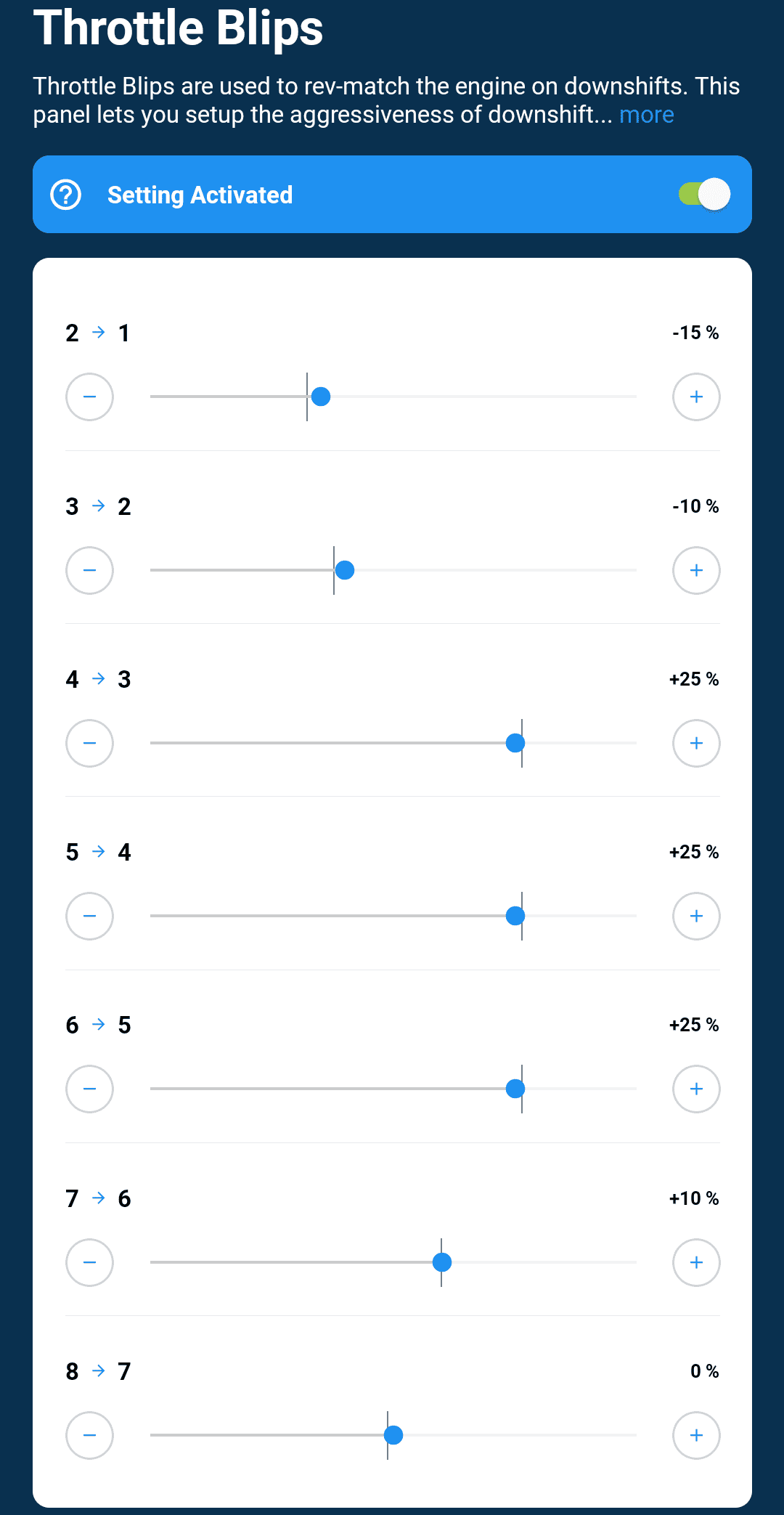

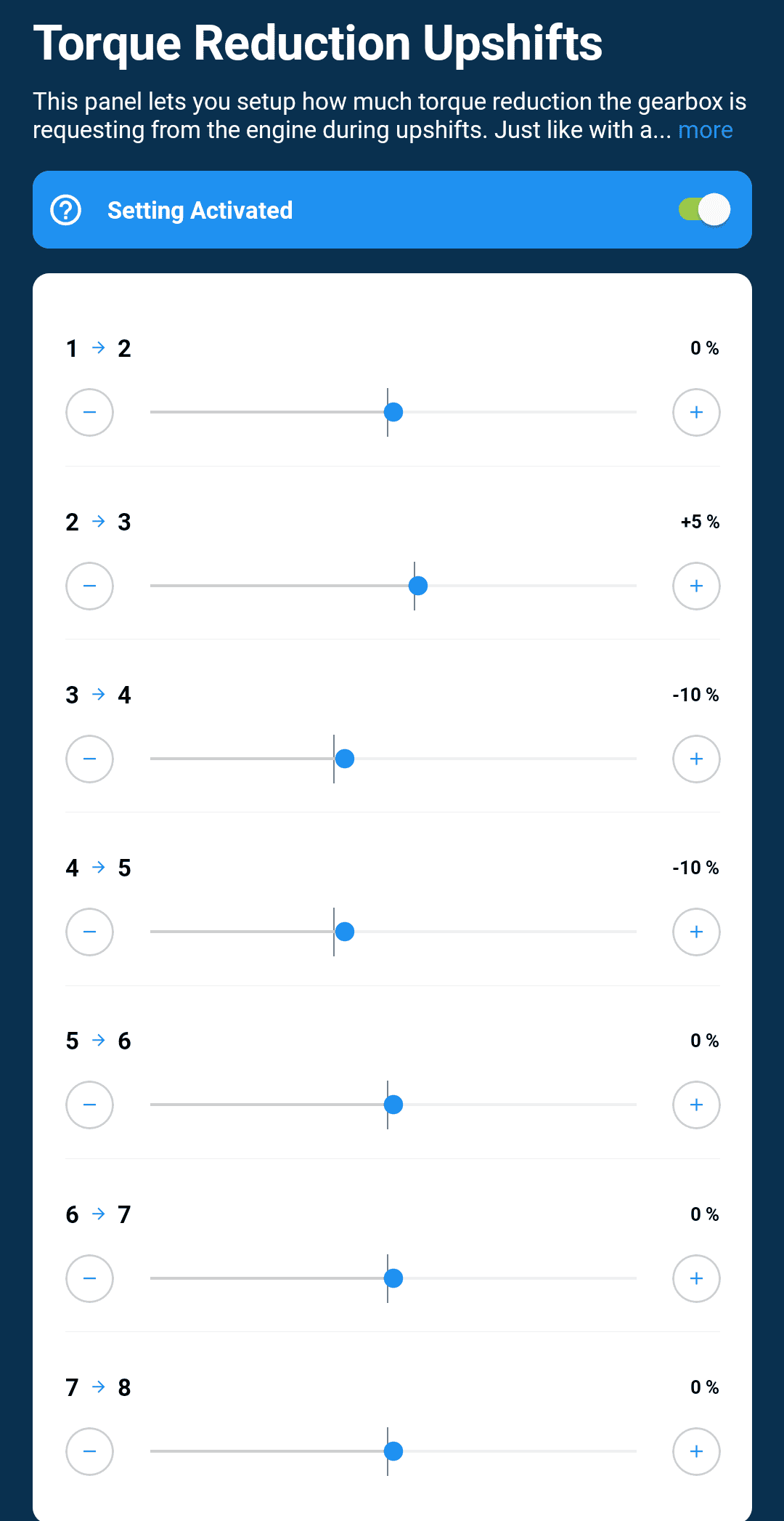

My complete settings for those interested with excessive notes and thoughts. Car is stock with an AWE resonated touring exhaust and 200tw AD09 (enduro) tires. Note I'm no expert, I'm just a very nitpicky / observant 28 year old who daily drives the car as sporty as possible, but when there is traffic in front of me, I still enjoy my Supra being a Grand Touring Sports car, coming from a BRZ. The XHP wiki is worth it's weight in gold.

Shiftmap editor (what most care about)
I use normal mode about 20% of the time driving the car, I believe to make the car feel how it SHOULD feel for a NORMAL mode and not have all the issues is a combination of these settings to prevent the car from chasing the highest gear possible, auto/start stop respecting your wishes, and standstill decoupling. If you're going to use normal drive mode I highly highly recommend adjusting standstill decoupling (it will make the car a tiny bit more harsh when at 0mph but in gear, but it's not interrupting anything, and its the same behavior you'd get in sport mode). I find these shiftmaps provide a very linear power delivery, shifts are smooth and well timed, and you won't be in 7th gear until ~55mph and 8th gear until ~65mph.
For my sport maps I have these setup for sporty driving around town without bogging power just like in D-Normal, but I don't do a lot of D-Sport driving, but when I do I've found this to be comfortable yet sporty, I actually consider this to be a bit LESS sporty than the stock configuration other than 7th/8th. It's more sporty than D-Normal obviously, WOT feels perfectly fine, but I don't have a lot of issues with stock D-Sport maps other than 7/8th gear. Shift feel will be covered shortly via torque reduction upshifts and throttle blip downshifts.
Torque Reduction Upshifts I'm no expert here, and this is a setting that CAN cause more wear, but my settings are very mild. I have only made very minor ~5% tweaks to receive faster shifts, I don't like when the car does the very "lazy" shifts, but you don't need much to feel results here, adjust 5% at a time, flash to the car, and go again. (Random note, you only need the 50 mile break in period after the first flash, I have done 3 flashes within 20 miles of driving and no issues, but RESPECT that initial 50 mile period, your trans WILL be weird). This is a complex setting I recommend reading the wiki for serious changes, as you can't just swing the sliders one way or another to always get a faster or slower shift.

Throttle Blips I have some tweaks made here to make it better overall in my opinion, which is smoother downshifts for all gears except 1/2, I've found as long as you're a good driver and not downshifting at the last second, you don't need insanely fast downshifts.

I've been playing around with the settings provided by @Xproplayer as well. Curious as to what settings you've tweaked to and are currently using.
I was still adjusting and didn't want to post settings until I felt they were ready. I absolutely love these settings and will likely never use Sport mode auto again. Sport M when needed/wanted for some shifting fun. No starving for power, no laboring the engine, and the downshifts happen sooner and always keeps you in a good gear at around 2k in most. Totally transformed the car and made it 100x more enjoyable to just jump in a cruise. The power is there when needed, just give it the beans.
Stage 2 v1.1
D-Mode settings
Upshifts
1-2 +15%
2-3 +35%
3-4 +40%
4-5 +45%
5-6 +48%
6-7 +50%
7-8 +50%
Downshifts
2-1 +25%
3-2 +32%
4-3 +46%
5-4 +48%
6-5 +50%
7-6 +50%
8-7 +50%
Reset my shift speeds back to: (I had this set to medium, fast and fast. But to keep things smooth in my D-mode settings, I switched them back)
Normal - Normal
Medium - Medium
Fast - Fast
EDIT: I used MHD 93 Stg2 tune and use the setting to disable torque limiters for supporting cars running xHP.
