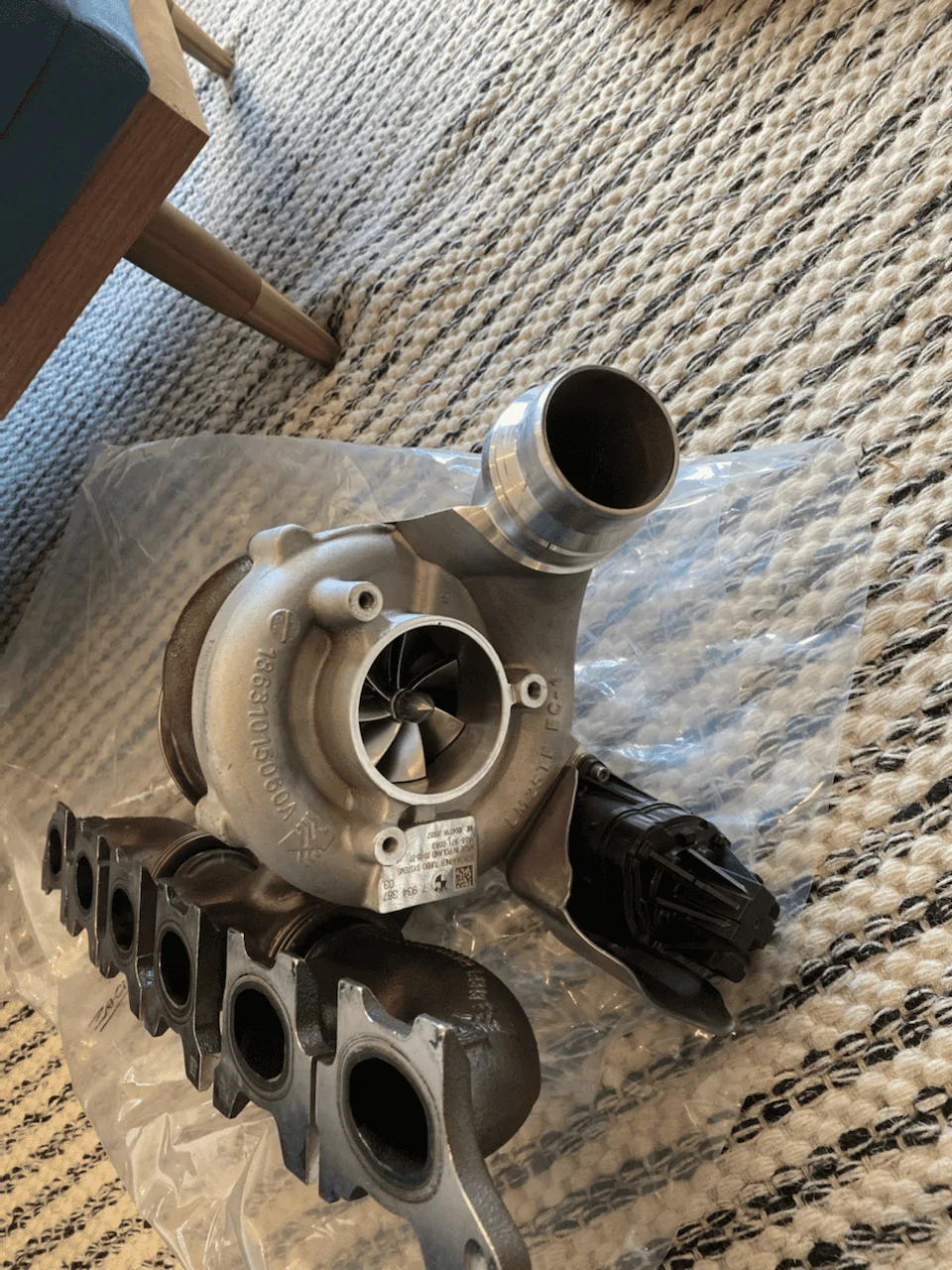

- Evolution of Speed Turbo Kit/Xona Rotor 10569 X3C

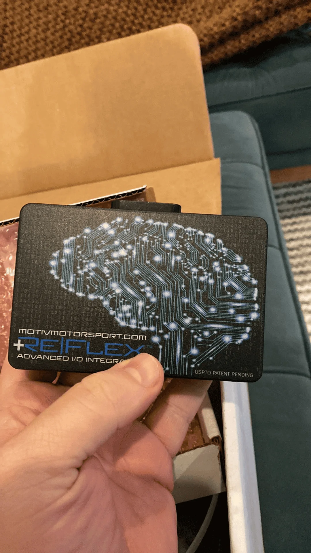

- Motiv Reflex

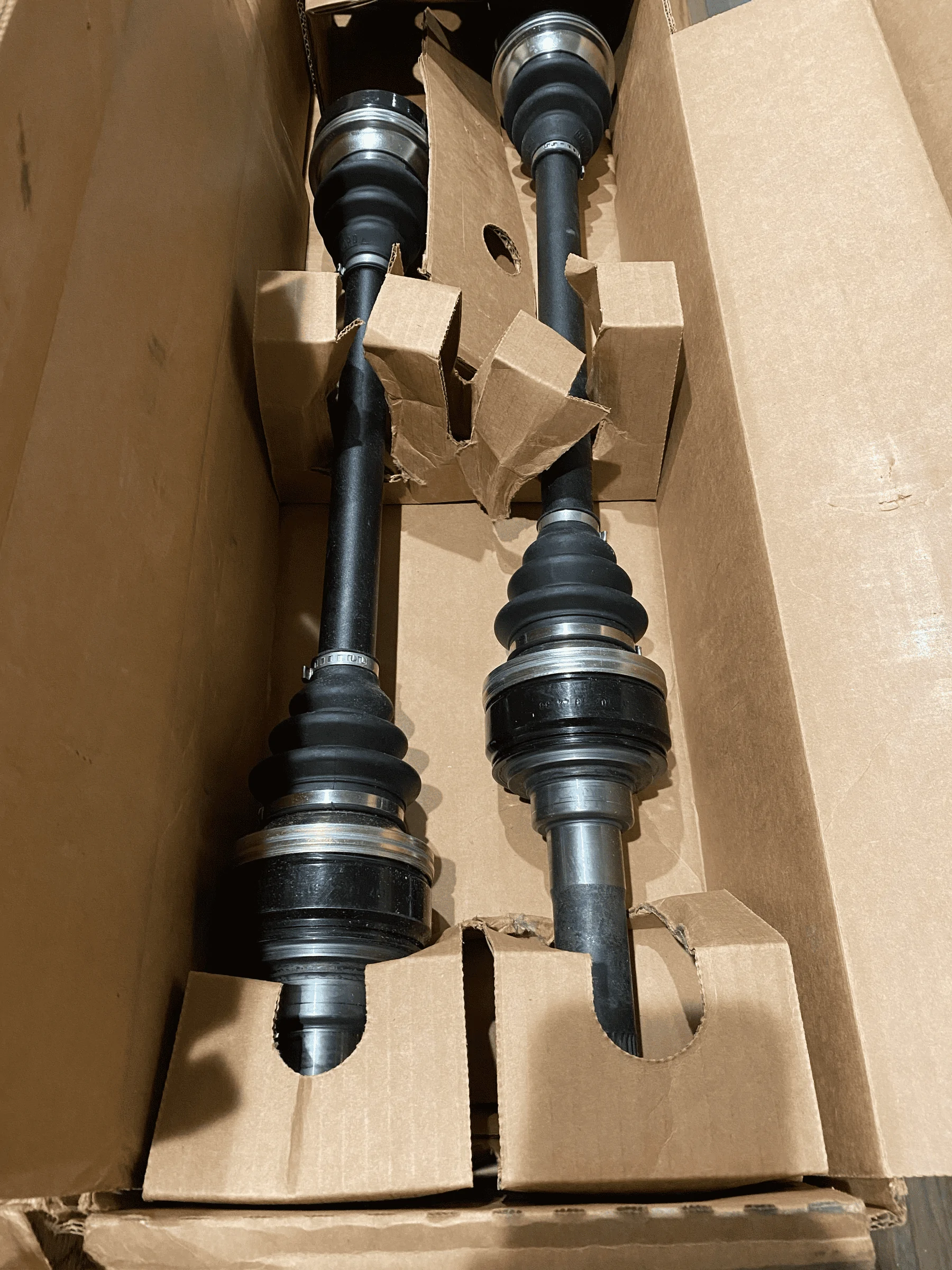

- DSS Axles

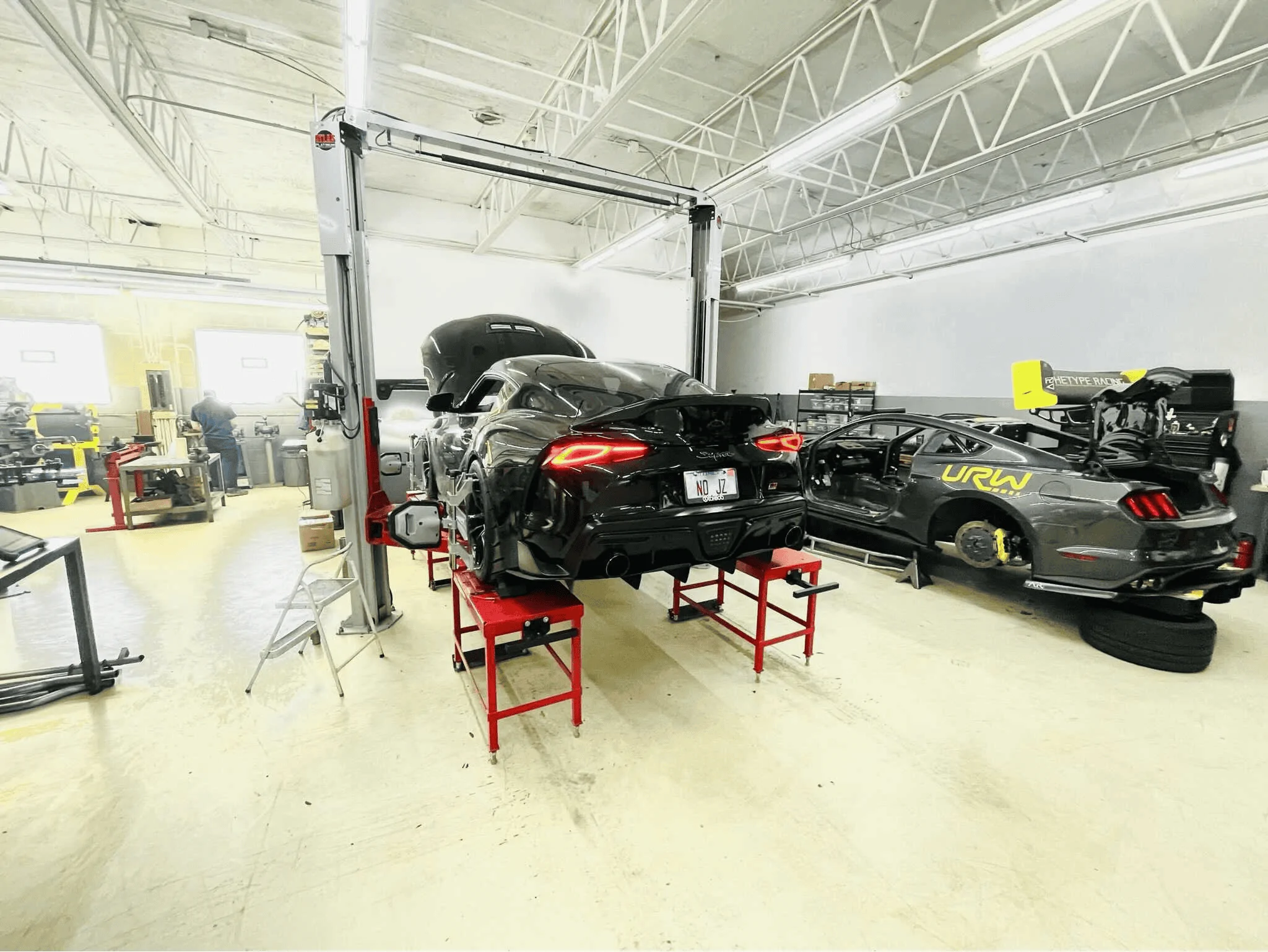

Alignment time
