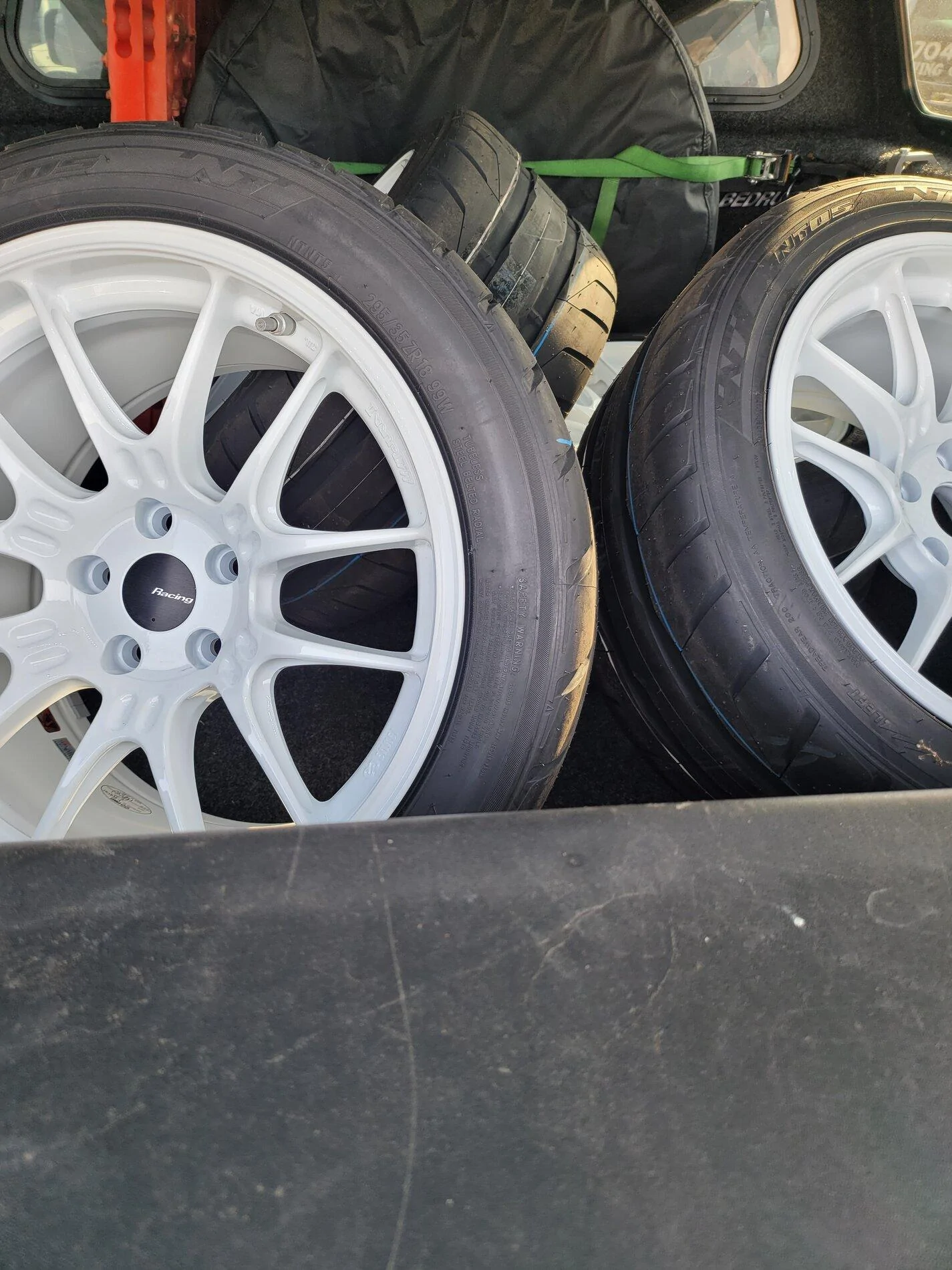

In for info, although I should be picking up my new wheels in the AM with 295/35R18. Fingers crossed they fit

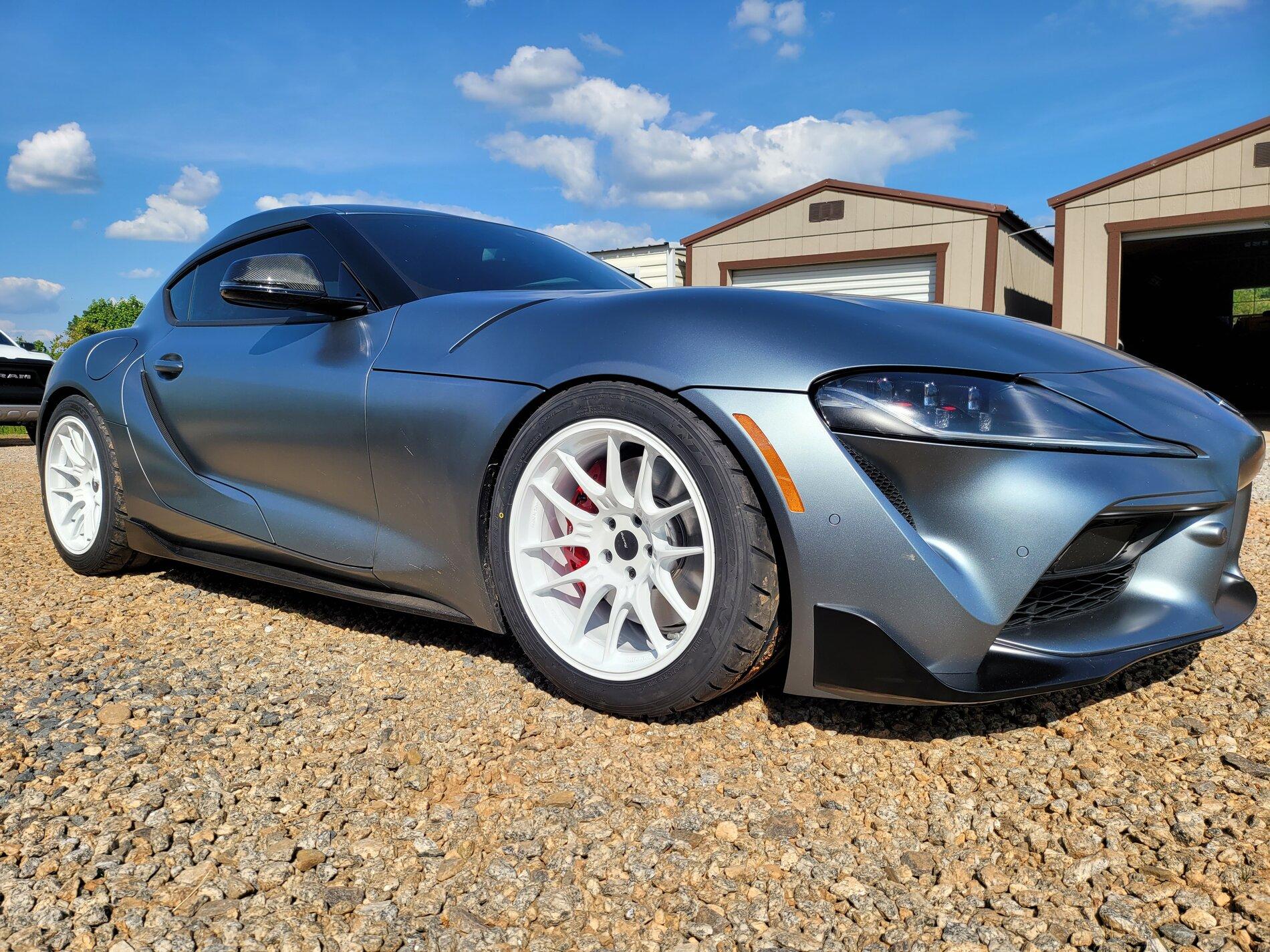

295/35R18 square on 18x10.5+35 wheels. Barely cleared the front strut using RSR super low down springs. Using an 8mm spacer in the front for an effective offset +27

Looks amazing!! Was it just the spring perch that it needed to clear? Maybe a HKS spring or true coilovers wouldā€™ve cleared no spacer?

Just the spring perch. Everything else cleared fine. Got an alignment today everything was good
