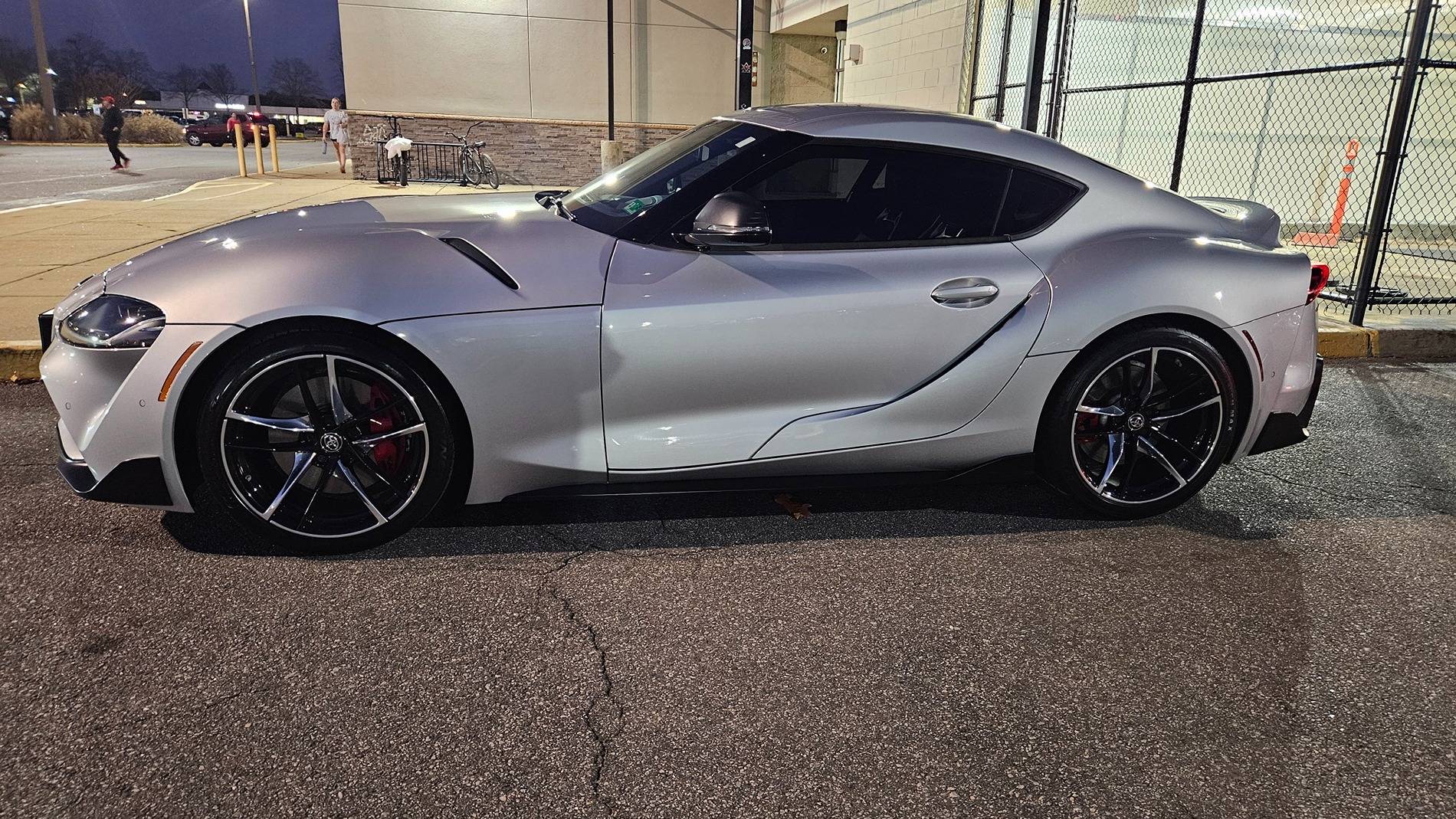

Hi gang! New to me 2020 Supra with 91k. Car was meticulously maintained by the last owner but I want to ensure I'm hitting everything to keep it on the road another 100k. What preventative maintenance items would you guys hit on this car with that many miles? I plan on doing the oil, plugs and brake fluid this weekend. The only thing I've noticed of concern is the boots on the front struts are torn. Should I replace just the boot or go ahead and do struts, shocks and coils while I have it torn down? Car handles great but I'm thinking 91k on the factory suspension might mean it's time to replace. Thanks all!
