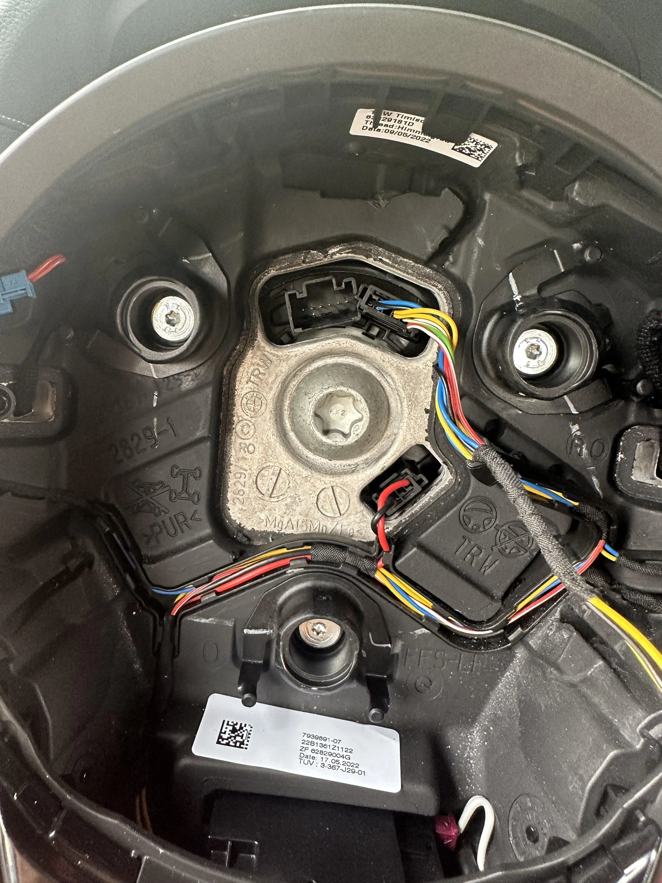

hi all. I’m having an issue removing the air bag. It seems that the spring on the top left doesn’t wanna unclip.
I try and I try and no luck, I’ve removed the airbag two times already with little to no effort , but I can not unclip it this time.
Does anybody have some pointers as to what to do?
best regards
GRSupraguy
Brian
Aug 25, 2022
205
422
A91-MT Supra, Jaguar F-Type R
You’re probably already doing it since you’ve done it before..but if not, make sure you’re kinda pushing in on the airbag while you’re trying to unclip the springs. Start with the one you’re having difficulty with then unclip the other ones. Make sure you’re also not pushing in between the spring coils. I use the flat head and kinda feel around and twist it perpendicular to the coils. You’ll get it. Good luck.
