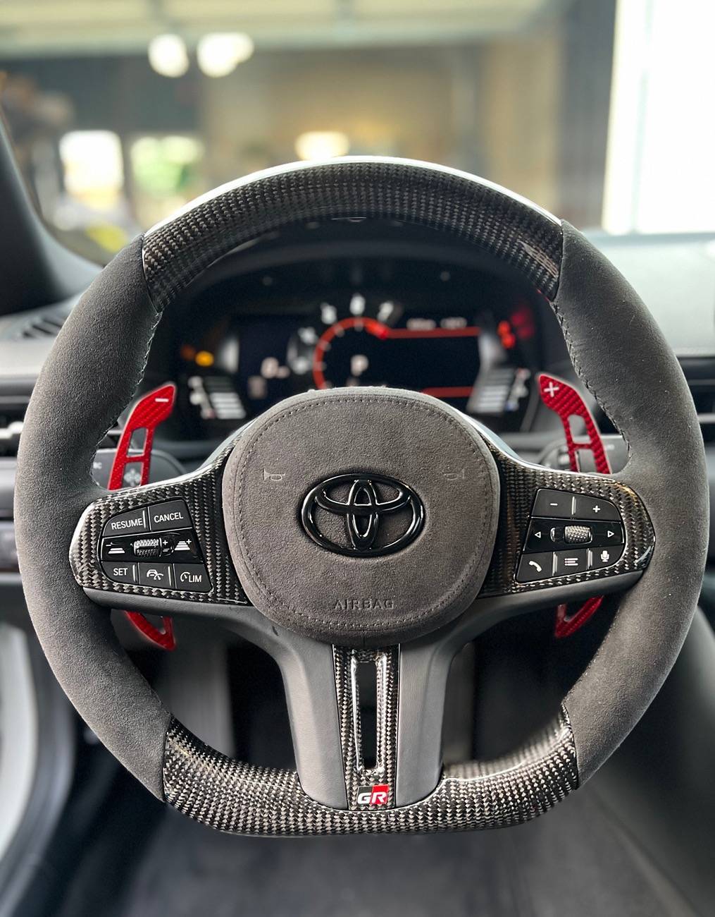

Bought an OEM steering wheel on eBay for $120. Took it to a custom steering wheel shop in China to rewrap using OEM core (for maximum compatibility and safety) spent about $250 for labor, including the airbag cap. Very happy with the result. Everything here is very high quality and beyond my expectations.

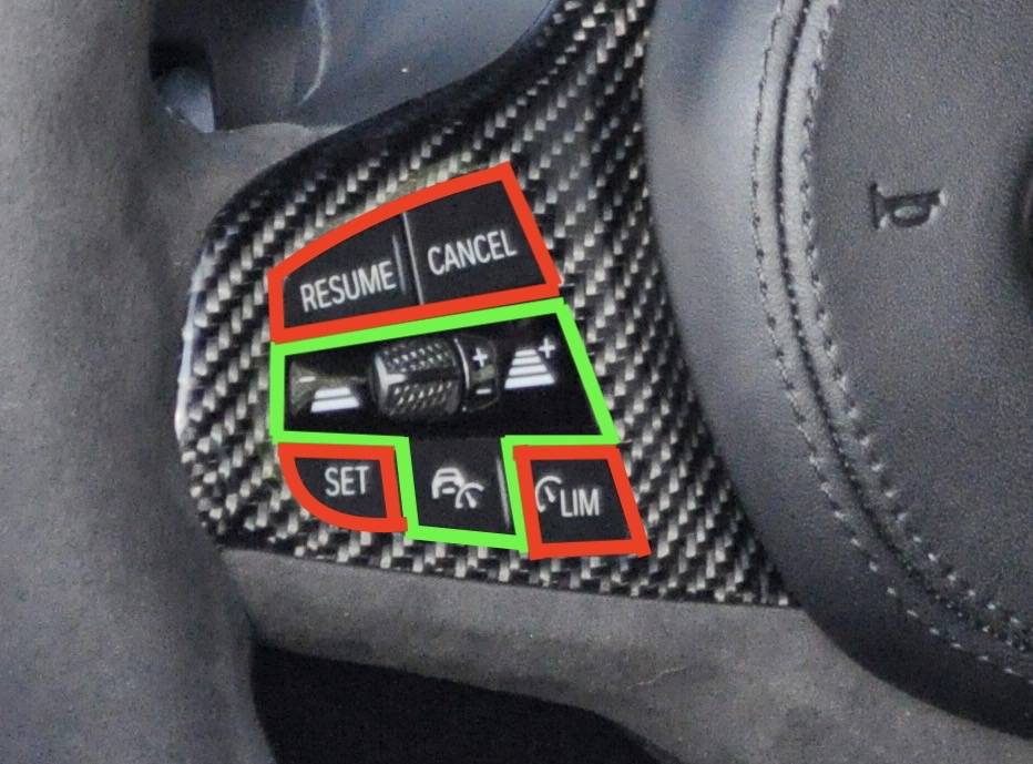

Interesting. So every single button on the left works, including the LIM button?
I have the same button set, and not all of mine work. Enough, mind you, to use and keep them, but this tells me there some coding that could possibly be done to get them all working.

I'd be interested to know what LIN_VARIANTE_MFL is set to on both your wheels.
It should be under BDC_BODY_3. Mine is set to ACC and Set works. Resume/Cancel/LIM do not for me.

Can i get to this using bimmercode advanced? if so let me know where and ill go look it up now.
For some reason, to me, it looks like that Supra logo is super crooked leaning down on the right and up on the left of the airbag
