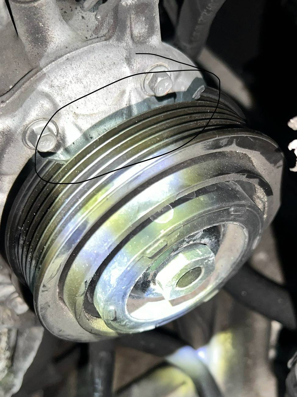

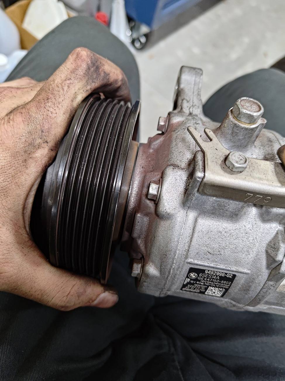

I need all of you to re-assemble here like the avengers please. Having the same problem, my pulley belt snapped took a chunk of the ac compressor pulley with it. I got another compressor from an M340 installed and the clutch on it does not engage, ac still blows hot air but the pulley spins just fine. I went and got a compressor from RYC for $300 and put it on and it imploded (broke) the next day. I have spent so much money and time trying to fix this, currently 100 degrees in South Florida, all black supra. I am DYING. WHAT DID YOU DO TO FIX THIS!!!!!!!!!!!!!!!!!!!!!!!!! AC shops telling me its a signal issue since the compressor is getting power but just not getting a signal to spin clutch when ac is turned on, theyre also telling me that my system is contaminated and I need to replace the condensor. I spent $500+ on a vacuum & recharge, $200+ on 1234yf, $300 on a compressor that lasted not even 24 hours, $200 on a used condensor from a Z4 not installed yet, and countless hours on installing and reinstalling the compressors, belts, etc.
