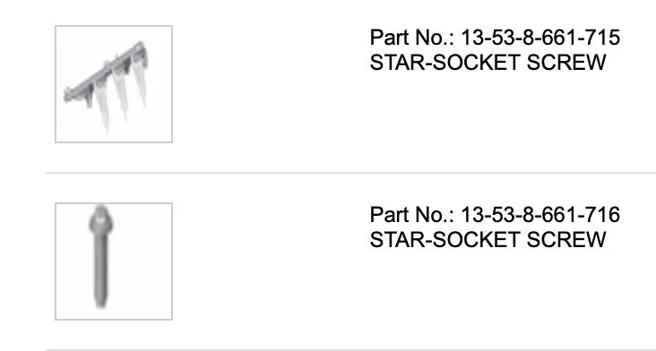

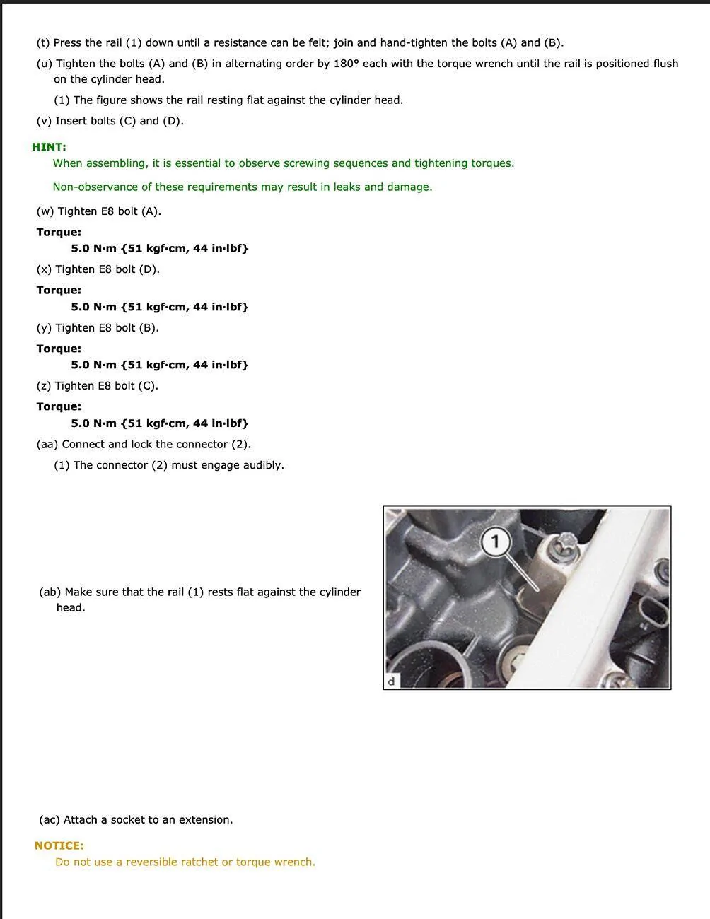

Part numbers:
Each rail use 6 of the small bolts (E6) and 4 of the large bolts (E8)

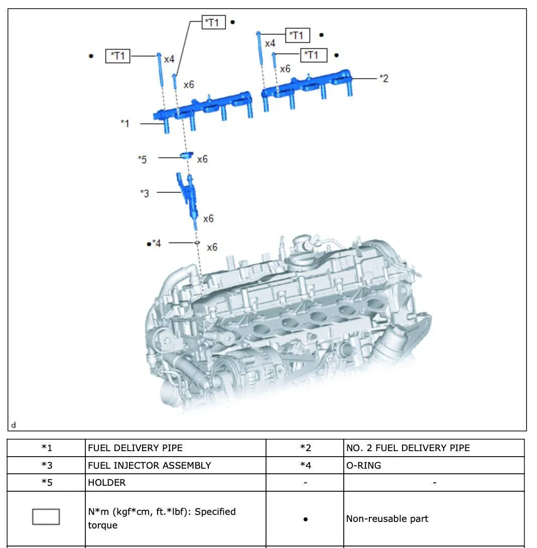

Manual states one time use for both:

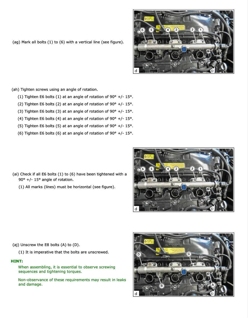

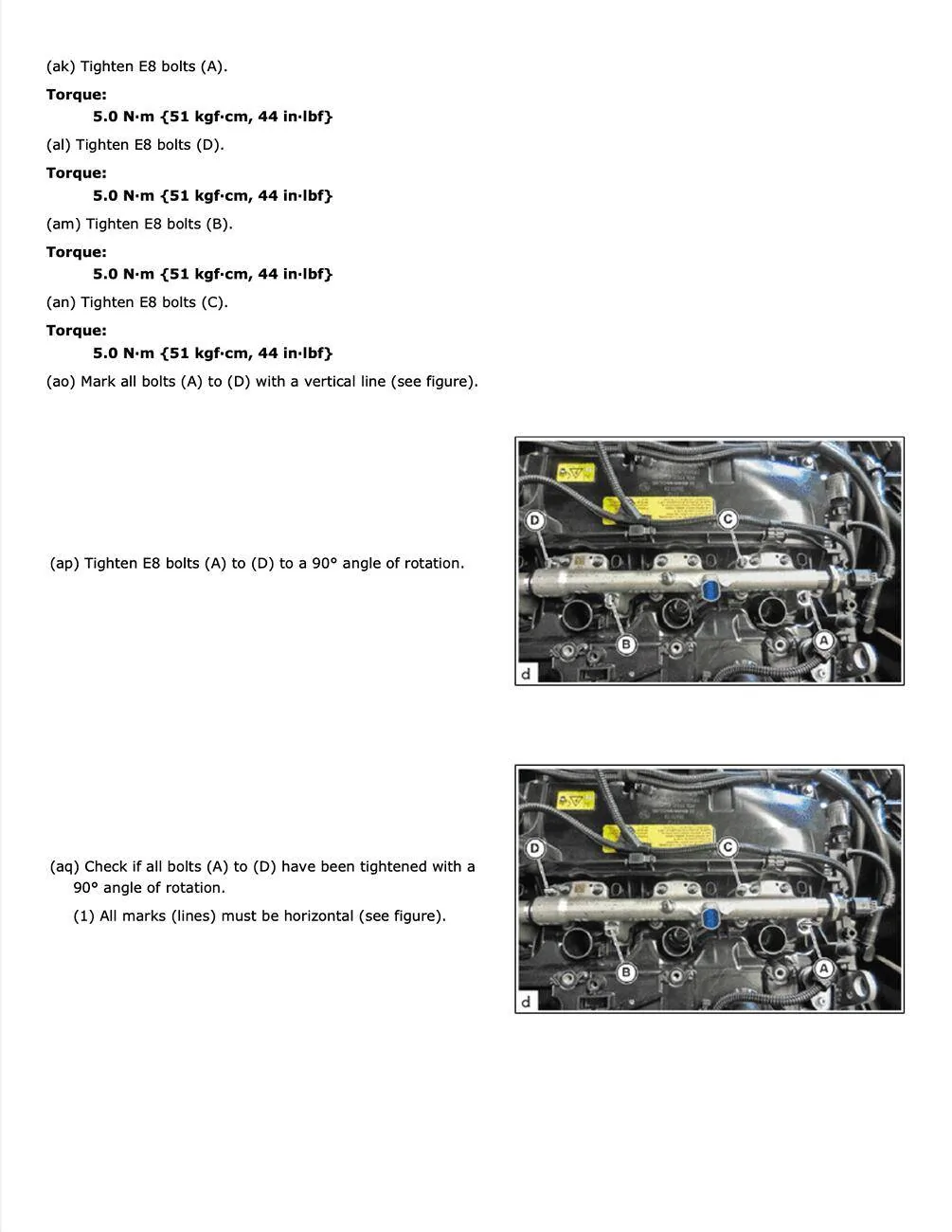

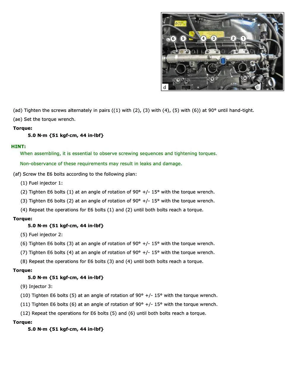

Torque sequences:

Everything is fairly easy and straightforward.
Part numbers:
Torque sequences:
