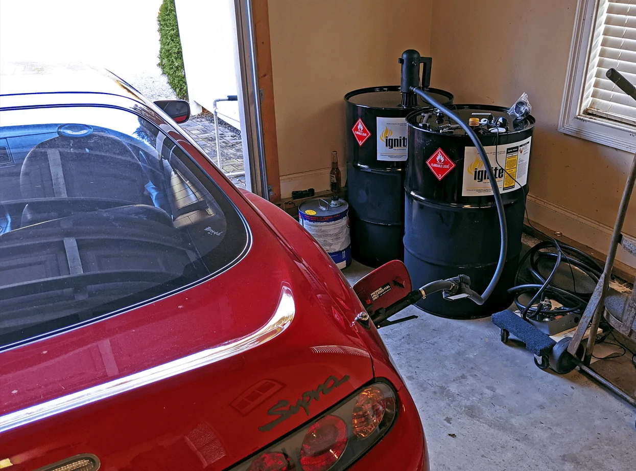

Or you can be like fast boys, and just buy Ignite Red by the Barrel at 12/gallon and be done with it. No more mixing, E90 always, and have that sweet 114 octane all the time, for a marginal amount of money. ¯\_(ツ)_/¯
i'm a dealer for Ignite, and stock Barrels of Red for my car. but i actually run my car 65-75% of the time on pump E85. i use the Ignite when i think people will wanna get spicy on the cruises and etc, lol. Pump E85 is definitely cheaper than Ignite. but i use both haha.
