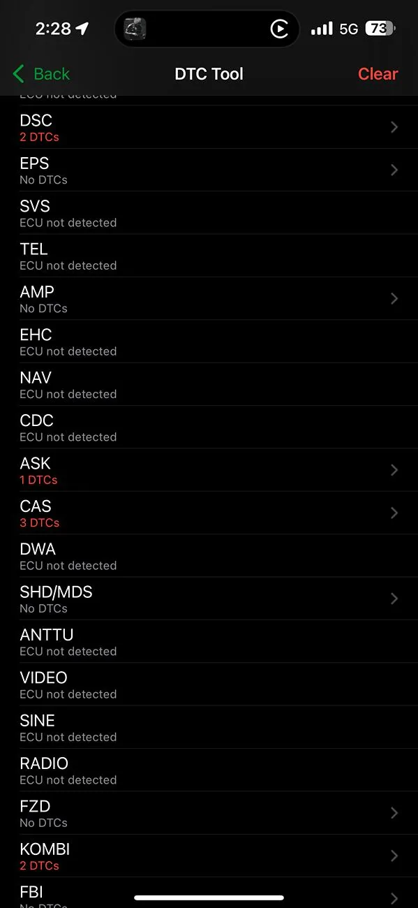

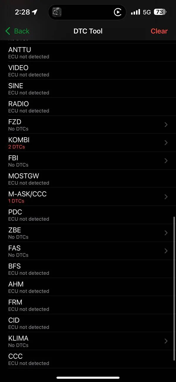

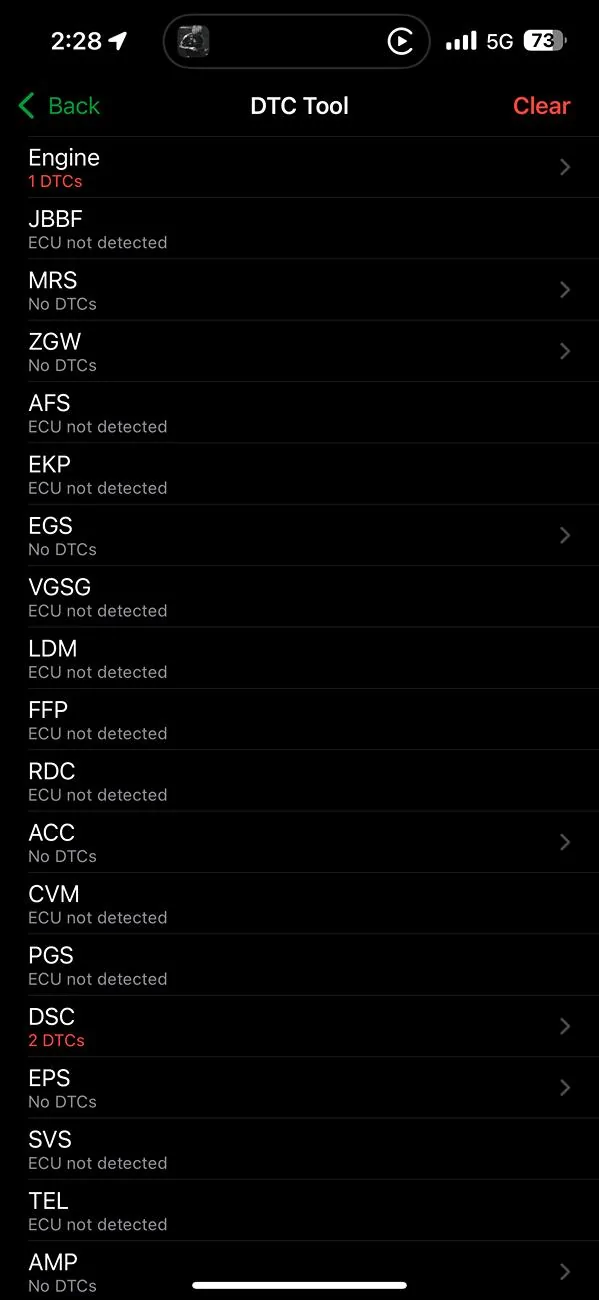

I’ve been having an issue with my Supra running lean on occasion. I believe it’s my evap purge valve as I can hear clicking. I’m not 100% certain but that’s what I’m trying first. I checked my DTC tool on ecutek and saw all of these codes. What do you guys think? Low battery or time for her to go to carvana. The 1 engine fault is from the exhaust valve, I have it disconnected as I have a single exit. I’m tuned and catless also. Thank you guys. I’m not the brightest with these cars.

post the actual codes, not the amount of codes. We can't do anything with those screenshots.

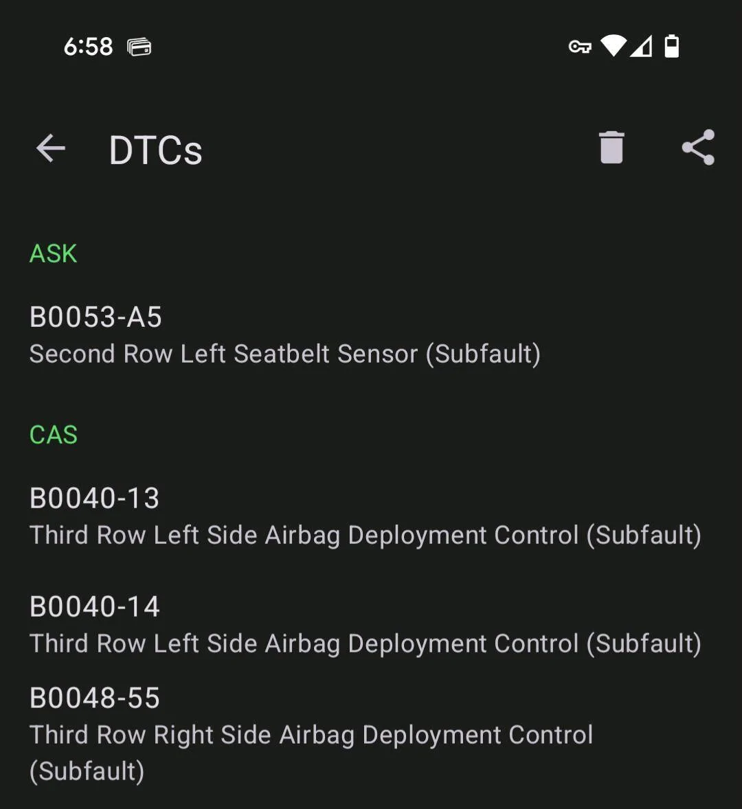

I also have Ecutek and noticed the DTC tool on the app has all those extra categories now after an update. You'll have to select the ones showing DTCs in red to see the codes.
Also what makes you think it's running lean?
I can do that, my bad, most of them don’t have codes just have that error.
I have a rough / long startup and I’ve had a couple lean codes and had a CEL come on once and it had the lean error code
It appears the codes are just from the update. I thought each one was an issue that it wasn’t detecting. There’s one for passenger seat belt fault and airbag so there’s that but nothing else. Thank you guys. Just then running lean issue
Yeah all of those new categories it has surprised me when I looked at it. I had one for passenger rear seatbelt lol. Hopefully your tuner can check things out for the lean issue.
What is showing under the one called DSC ? just curious since I have no Idea what most of those individual ecu things are now on that tool
Yeah my tuner kinda ghosted me and most others. I haven’t had any luck with him lately. Been stuck trying to figure it out on my own. I think it might be evap related. And my codes for DSC are
C0809-EB and C0809-9E
