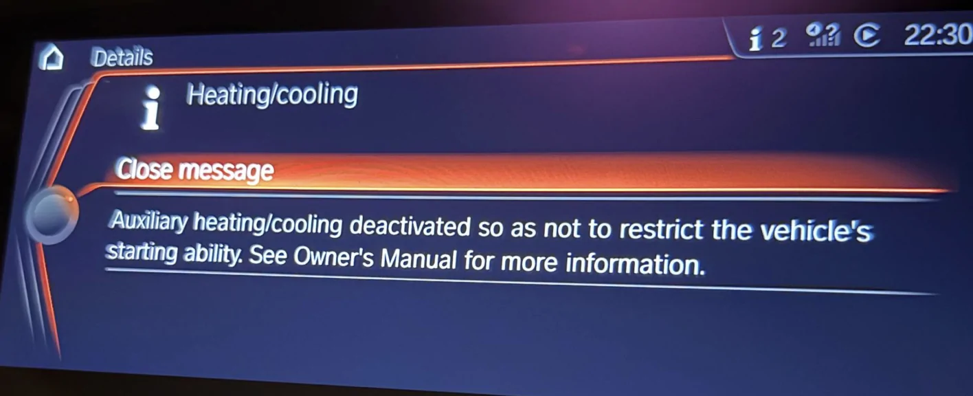

Also when I try to start the auxiliary ventilation, it will turn on the A/C display, will not start the A/C itself, and in around 15 seconds it will shut off and give me an error:

The auxiliary ventilation message
The message:
"Heating/cooling deactivated so as to restrict the vehicle's starting ability..."
may be a consequence rather than the cause.
If the car cannot communicate with the blower output stage, auxiliary ventilation cannot operate, so the system aborts the request.

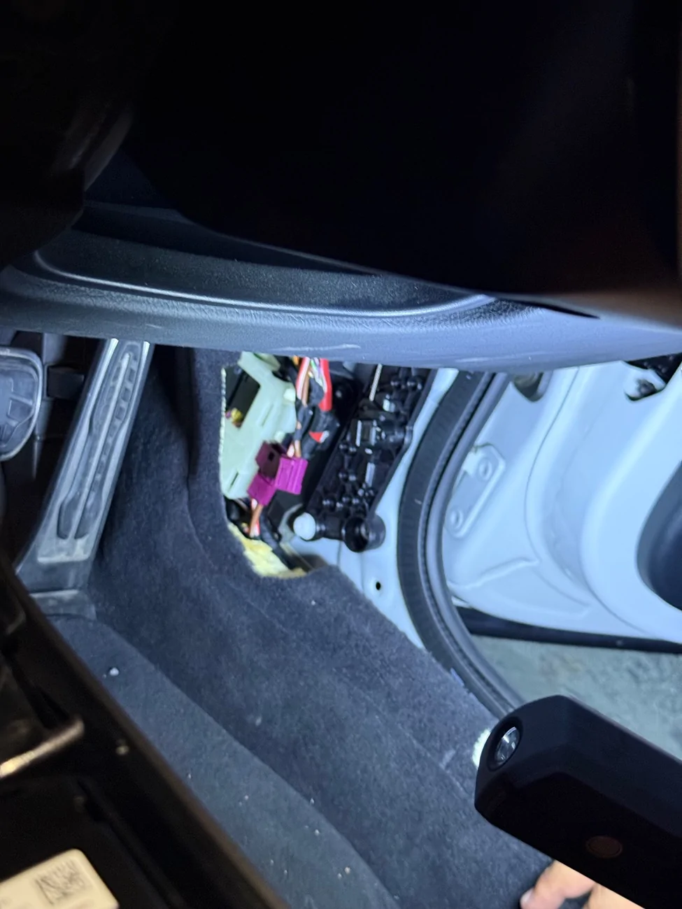

  1. Check all HVAC and heated-seat related fuses with a meter, not just visually.
  2. Inspect the blower motor/output stage connector in the passenger footwell.
  3. Verify power and ground at the blower output stage.
  4. Look for LIN-bus wiring damage between the blower output stage and IHKA.
