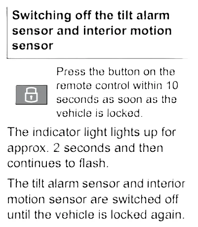

Hi guys!
Sometimes when i put my car into the automatic Carwash, the alarm siren start to sound.
(The car is locked and not moving)
In another case i put my car on a translator (to move it into the garage) and from time to time the
siren activate.
Do you have any suggestion?
Ho can i disable the alarm system?

Just keep the car unlocked when you move the vehicle or bump into it in a controlled matter (carwash/carjack).
My siren starts blaring if I jack up the locked vehicle. I just unlock it and open a door to trigger the system to not lock the vehicle after some time.
Thanks for your answer,
but i HAVE to close the car because with opened rearview mirror, it won't enter the garage!
The same i have to close under automatic carwash because opened rearview mirror could be damaged.

I have a suggestion: read the manual.
