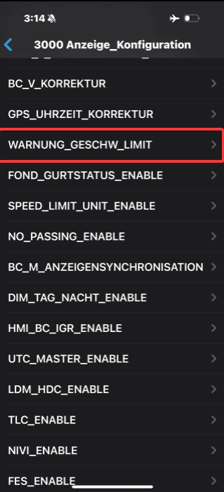

Found this explanation in our group.
1. connect to the MHD adaptor. 2. open Bimmercode 3. select MHD adaptor from the settings 4. pick BMW Z4 (supra does not have the ECU) 5. select "instrument cluster" 6. enable expert mode (toggle at the top) 7. select "warnung_geschw_limit" 8. change to nicht_activ 9. click save 10. click back (at the top) 11. click code. you will see some errors (this happens as its restarting the ECU). 12. disconnect. -> no more 120kph nonsense.

Thanks for this, but I'm unable to find the warning limit you said under expert mode. I have a bunch of sub menu's to choose from. Under which sub menu is it? Mine is a manual 2024 BTW
Same here can't find it.
Okay after messing around on bimmercode, it should be inside "Anzeige_Konfiguration".
So the updated instructions should be Instrument cluster > Expert Mode > Anzeige_Konfiguration > WARUNG_GESCH_LIMIT > Switch to nicht_activ > Press code

Thanks a lot. Found it. Disabled it. That is much better
