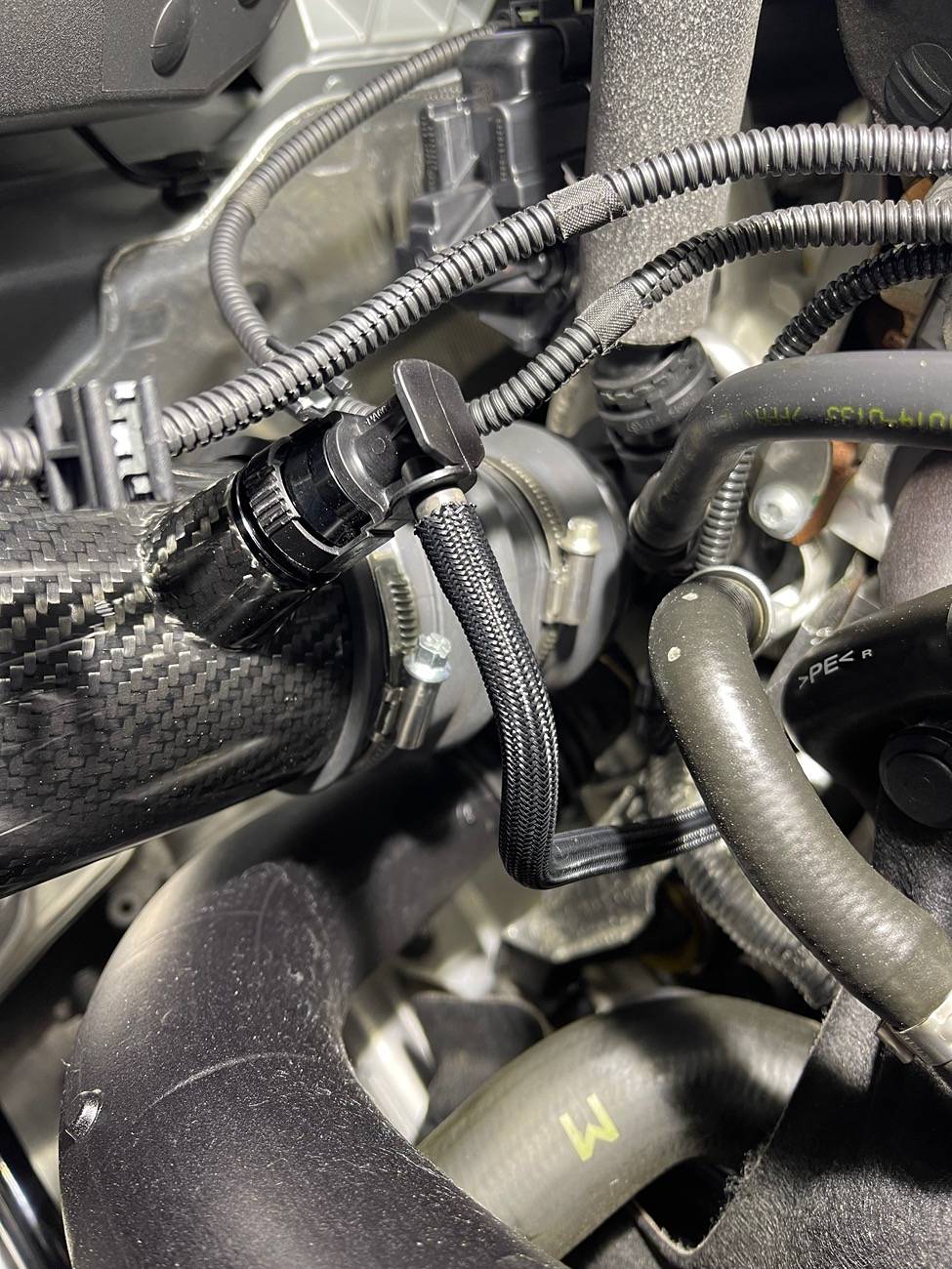

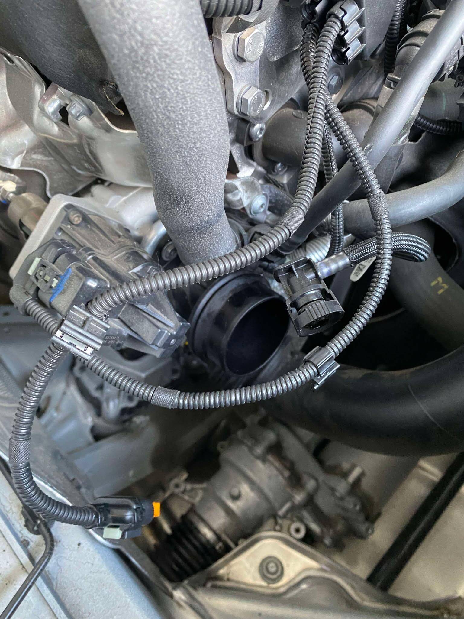

Looks like it. Waiting on a90 and Eventuri to respond hopefully once the week starts. Thanks for the very clear dinan photos Sup2 - definitely reassures me that mine doesn't link up like yours does.
No problem at all.. good luck getting it resolved.

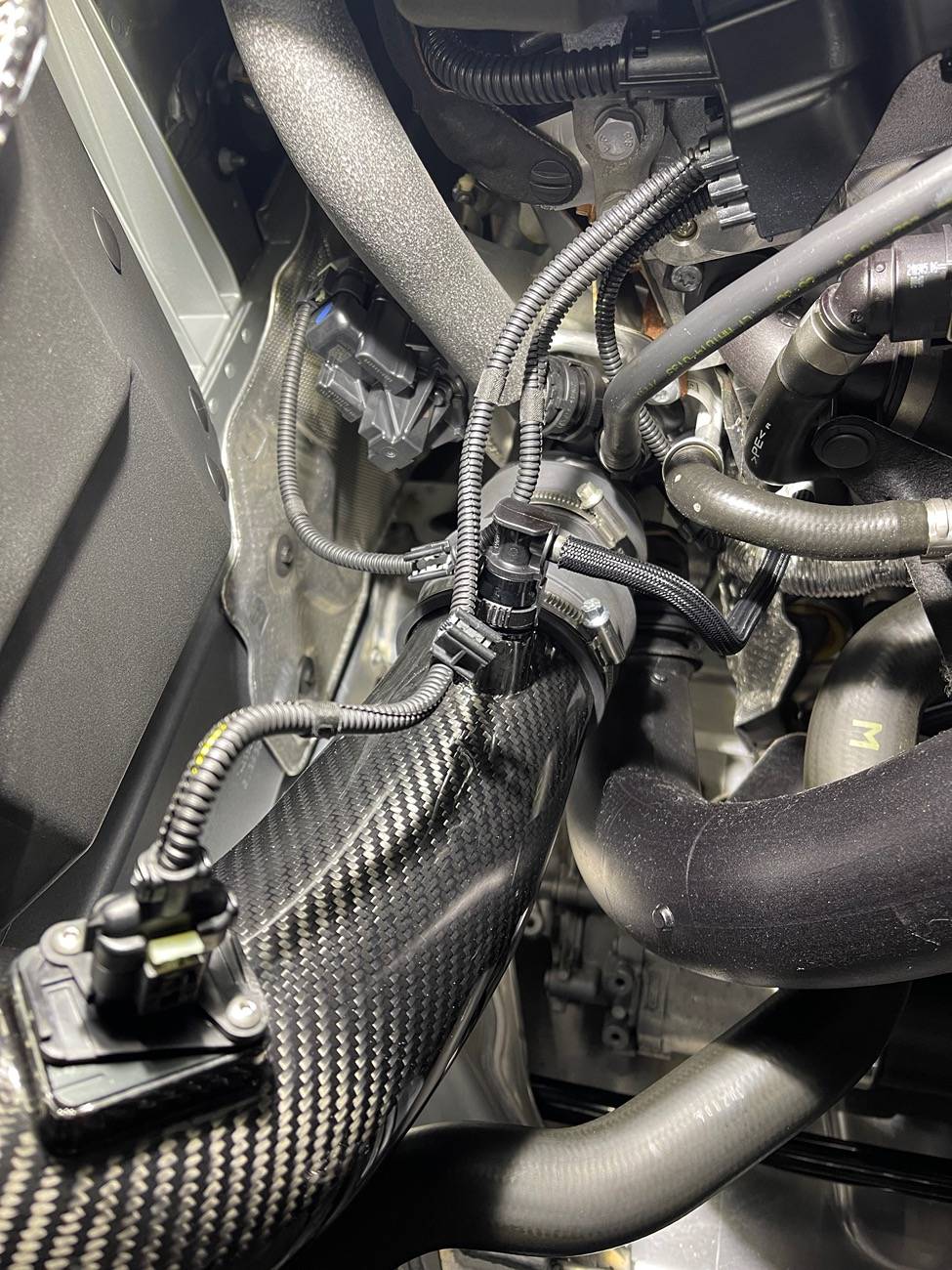

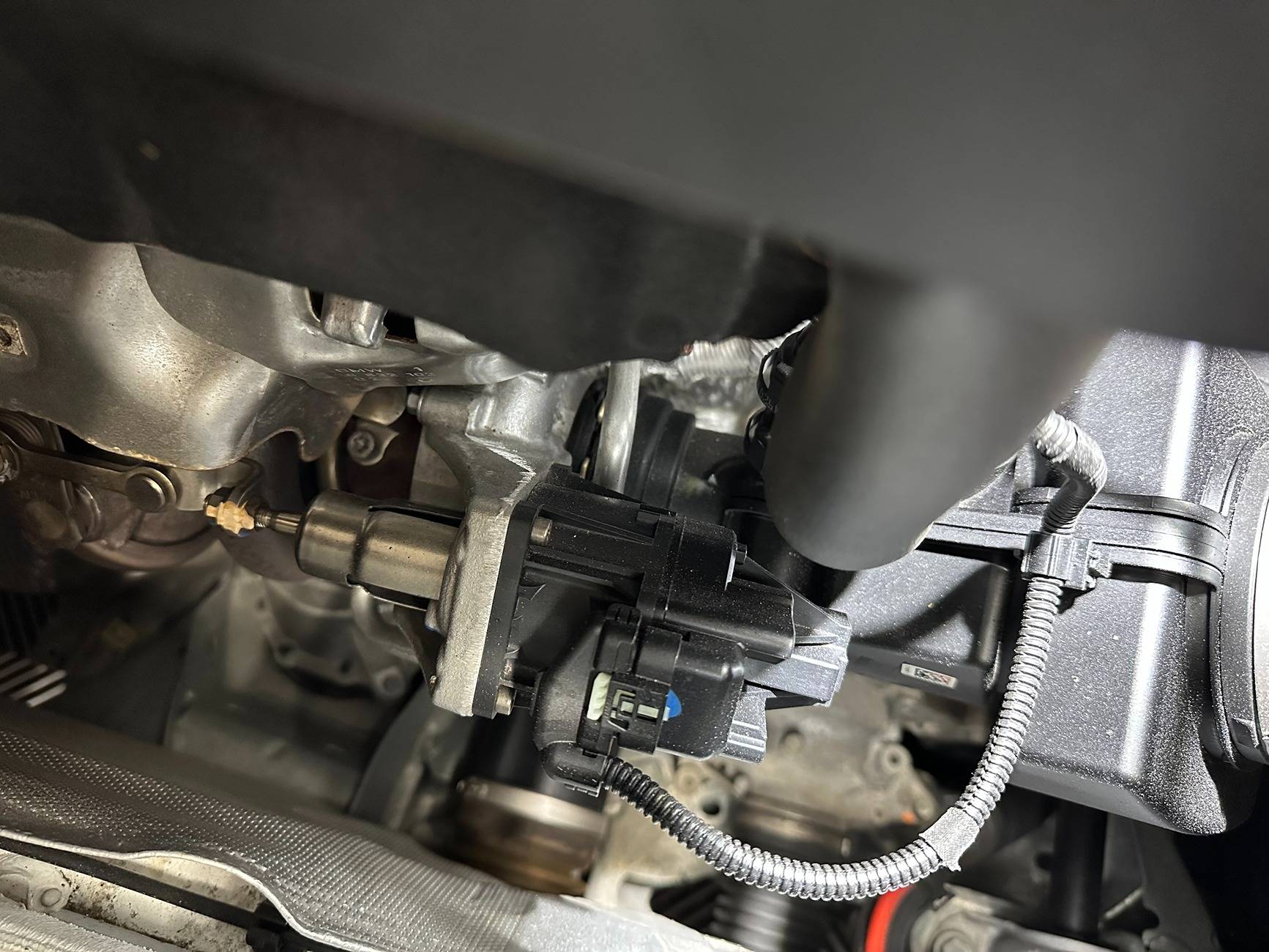

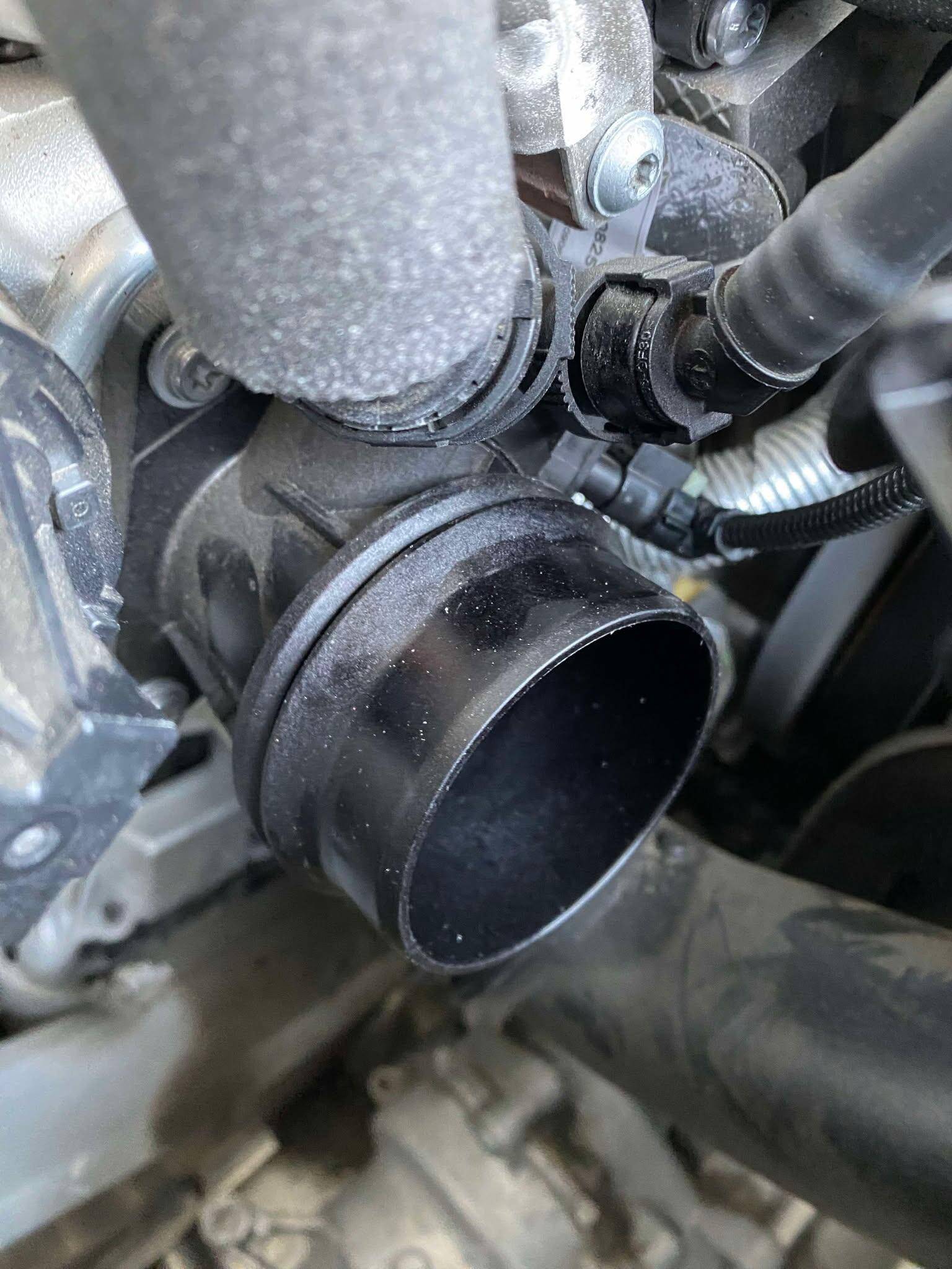

Quick update:
Eventuri confirmed that they only have one version of the b48 intake, but the fitment from my pictures definitely is wrong. However, they mentioned that they know some of their 2.0 owners have installed their intake before. I'm awaiting their response for any insight on how to successfully install it and will update if there is any solution.
2.0 Eventuri installers hear my call and see this thread!!

Conclusion: Eventuri told me they would have to design a new tube for the 2.0. Returning original to a90shop. Thanks everybody for helping me through this process as I thought I was going crazy.

uhhhh so how was it installed on other 2.0s? something doesn't add up from what eventuri said.
8,639
16,944
Maybe they haven't sold many (if at all) for Supra B48's?
I do find it odd that the Supra has a totally different turbo inlet design and turbo compressor housing than the BMW's with the same B48.
Yeaaah they couldn't provide me any insight on that and so I will go another route for an intake.
Mainly looking at the armaspeed and dinan. Hoping to order one after this return gets done and that a90 provides me a free return.
