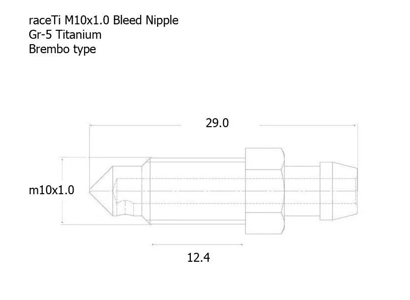

Does anyone have specs on bleeder screw thread and length? Not really finding much, and even searching for 2020-ish Z4 doesn't have any hits either, at least on the Russell website.

9mm screw - (5-8 ft-lbs)
10mm screw- (9-11 ft-lbs)
11mm screw - (10-13 ft-lbs)
ours are 10mm and I torque mine to 10 ft-lbs

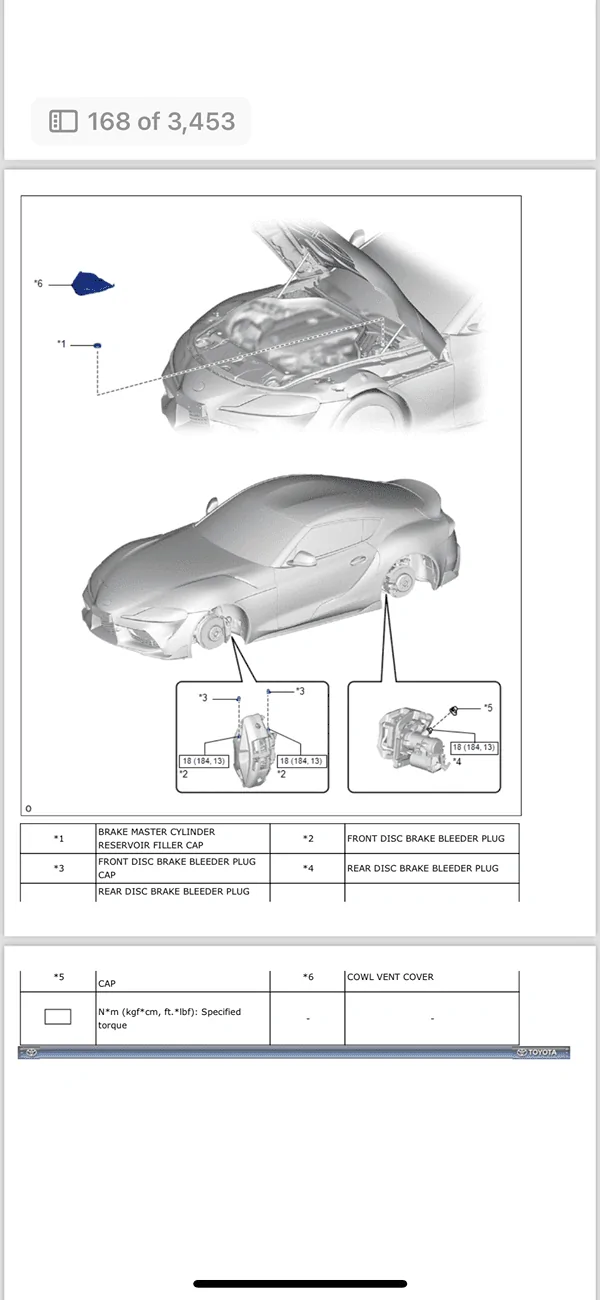

I found 6.3 ft/lbs somewhere and went with it. You think I should retorque them?
