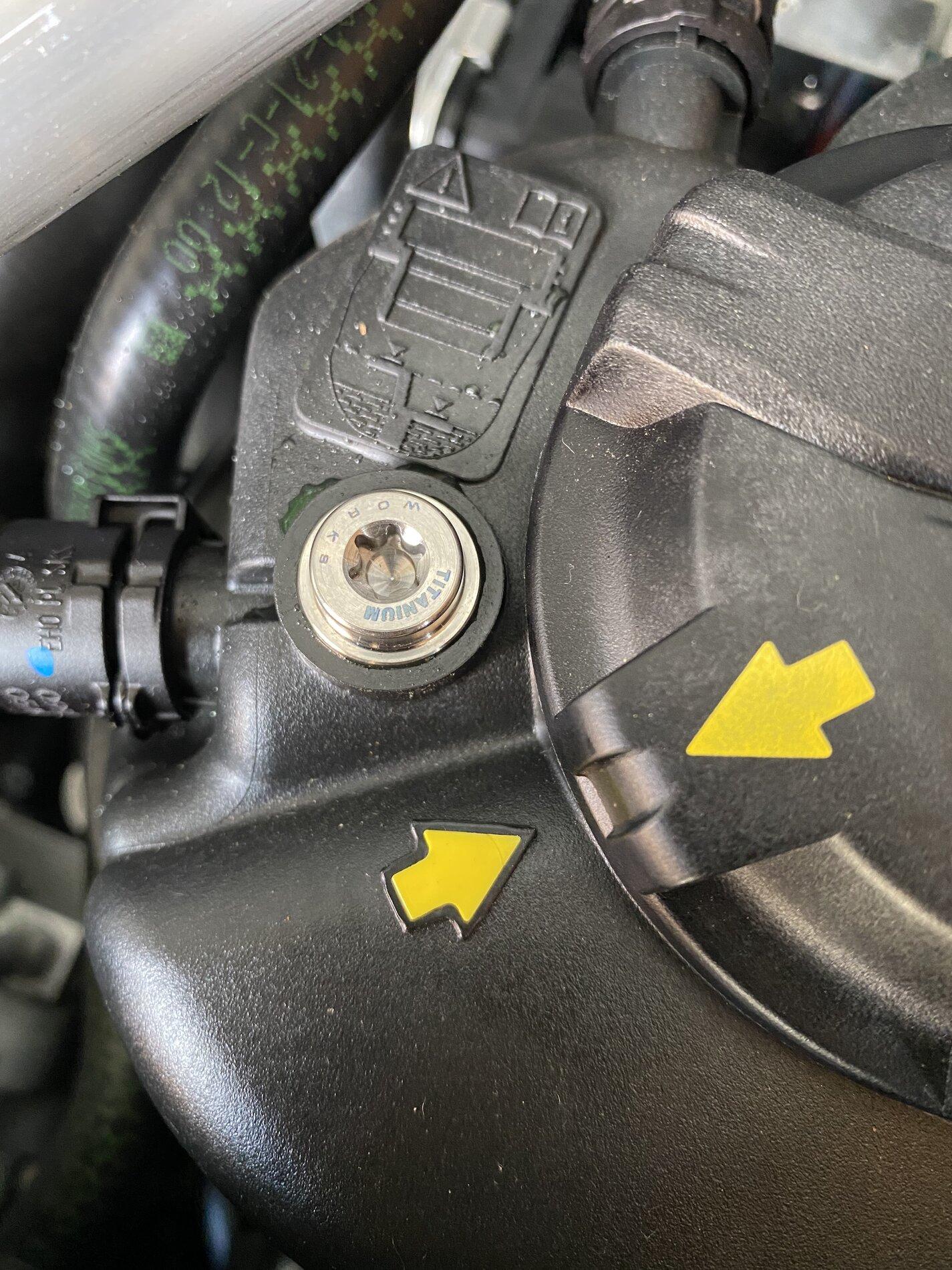

Just installed the HPS screw. Noob question though, when I unscrewed the OEM version while the engine was cool, I heard a little hiss with a rush of air. I’m assuming that’s normal because it’s a pressurized or closed system?
Its completely normal, mine did the same thing. It’s ok for a little of the residual pressure to bleed off when opened.

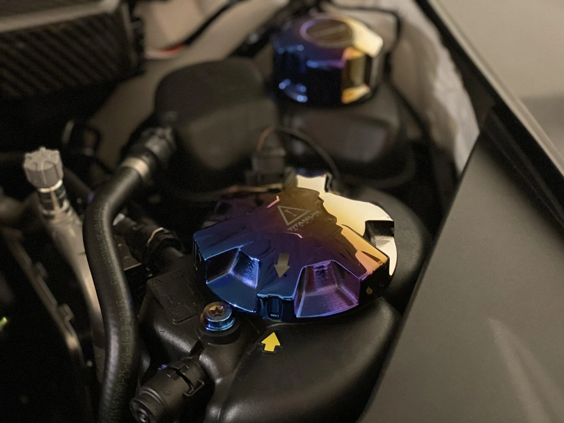

Oh snap! Titanium coolant caps. ??
-RJM
yeah, I was the one who begged them to make the coolant caps,
Bleeder screw , and also the oil cap. lol ?
Got more stuff coming!! lol

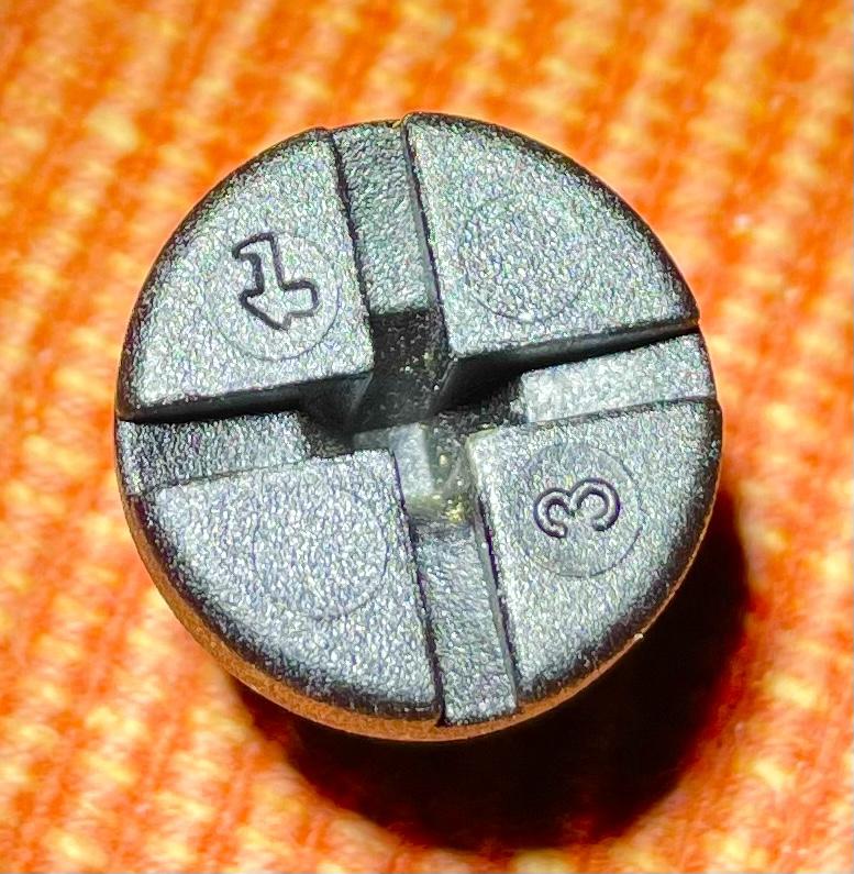

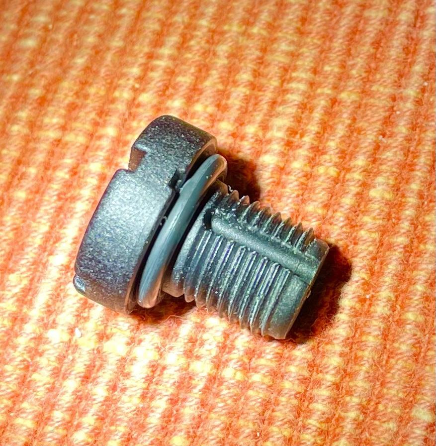

Is there even a chance with the stock one failing if it's never touched?
Yes, they have failed under normal driving conditions. The screw itself is flawed. They cored out the center of it just below the philips cross. And then they added a small notch along the threads. The wall sections in that area are thin.
The screw feels like its made of ginger bread, it weighs almost nothing.
-RJM
Do you have any photos of it failing. Some of my a90 Supra people don’t understand the point of it being replaced. I just like the bling! Lol

I think that the biggest issue will be that 90% of the failures will be at the worst possible time... when you actually needed to remove it and it simply disintegrates in the bung. Not sure how often that occurs and what factors are relevant - but I know here in the desert, anything plastic will eventually fail. The thinner it is the faster it will fail.
afree
Aug 12, 2021
51
34
Melbourne, FL
I'd be concerned with galvanic corrosion with the brass female threads and Ti bleeder screw.
