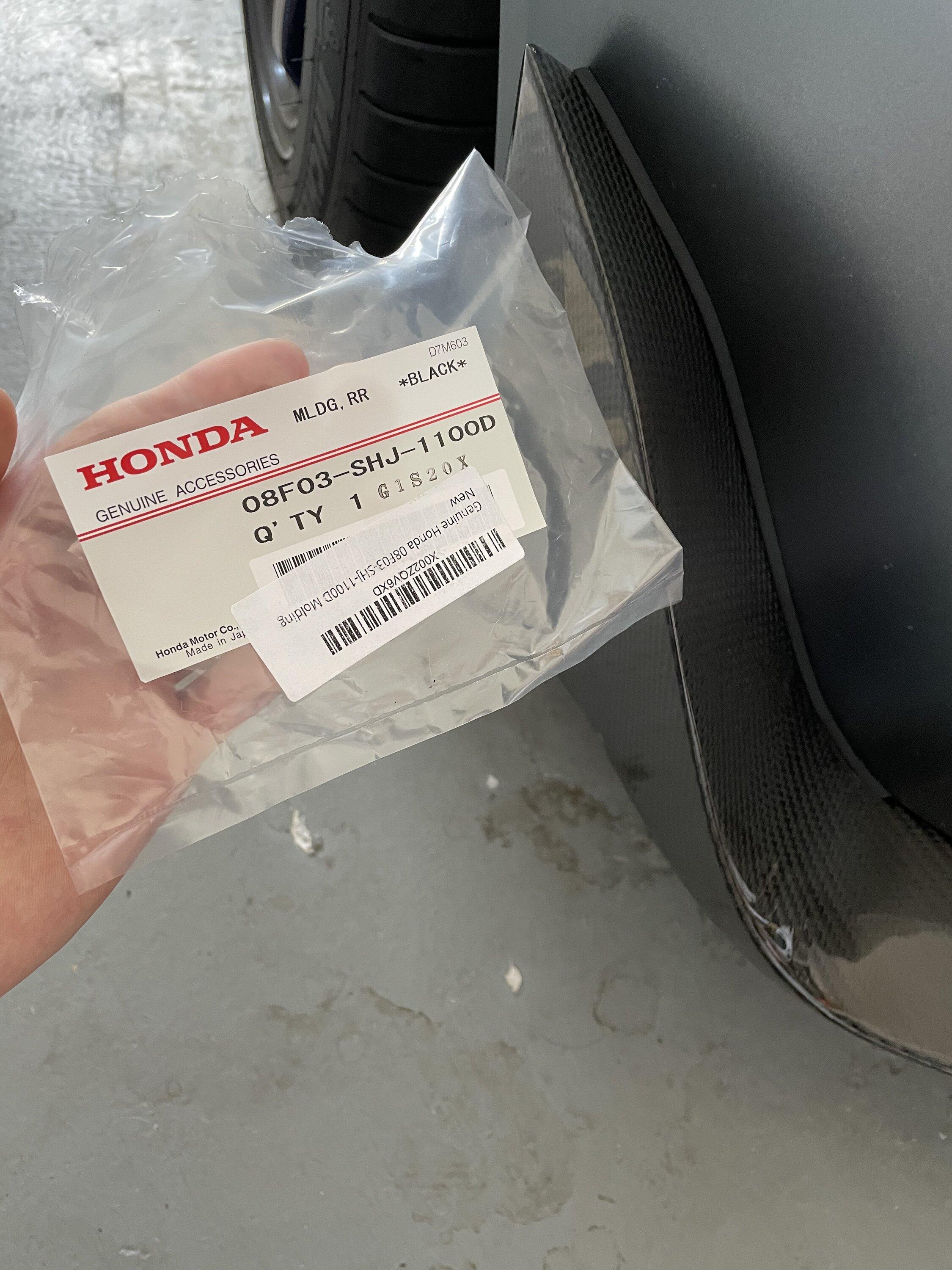

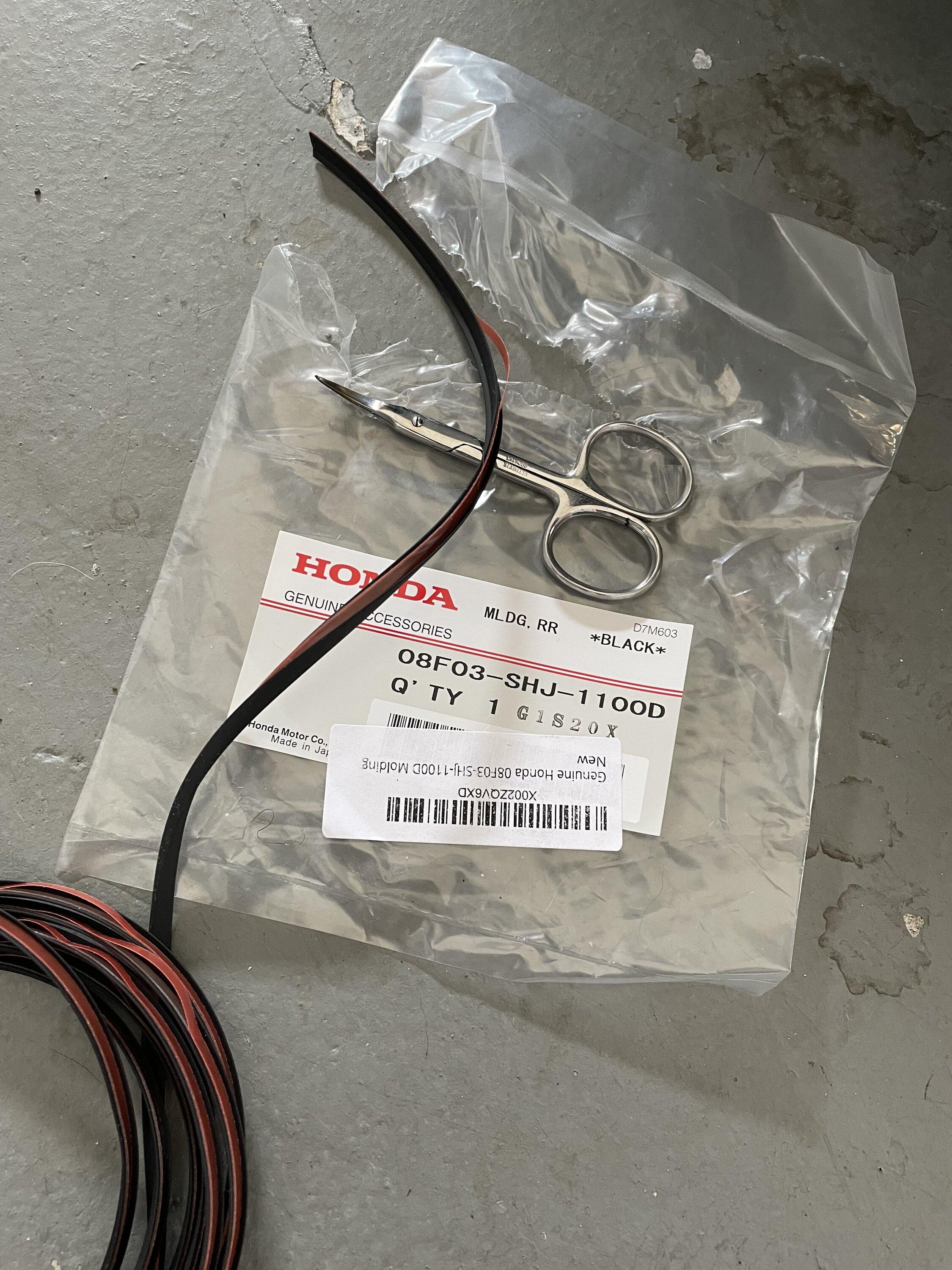

PART #: 08F03-SHJ-1100D

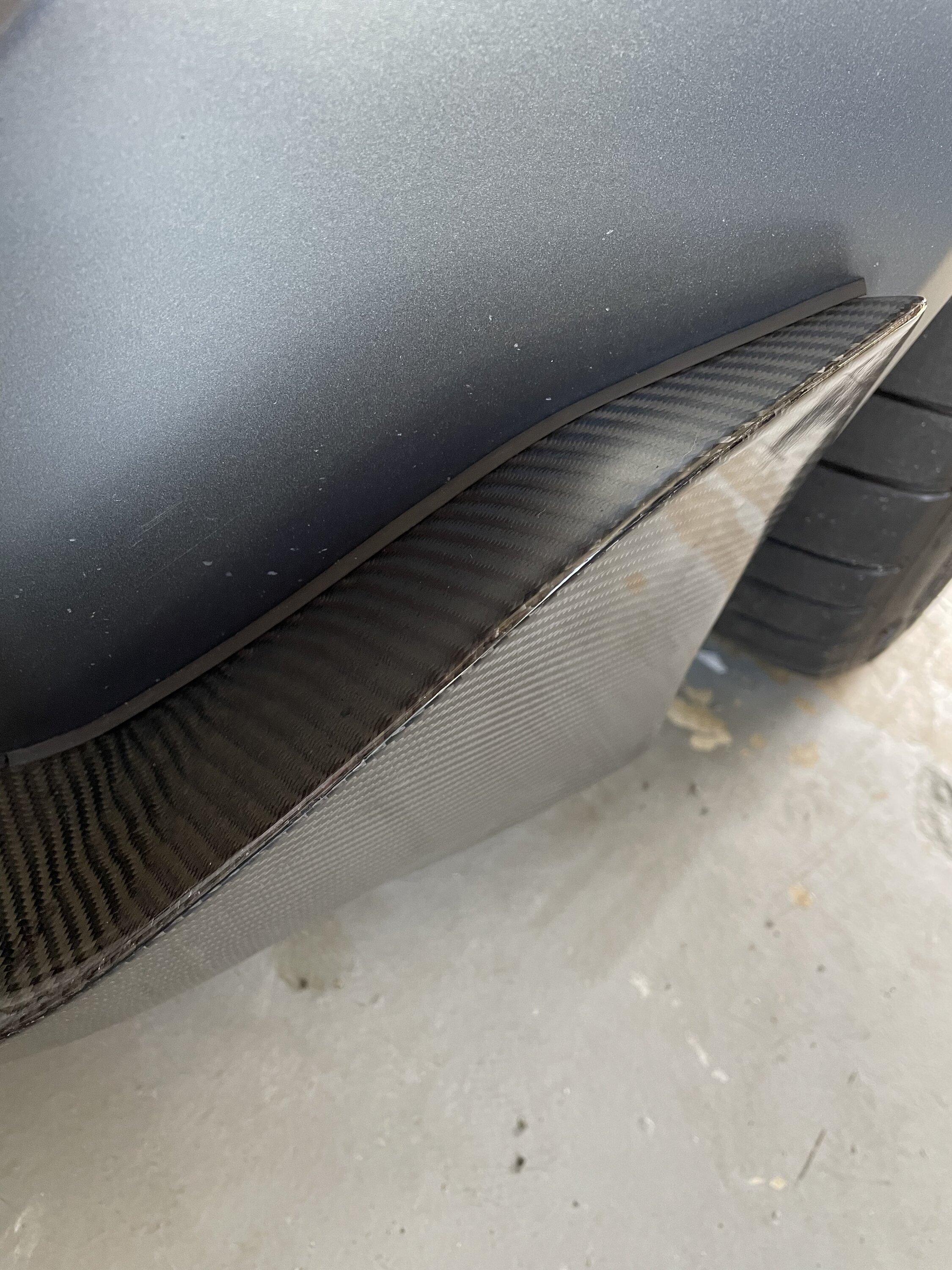

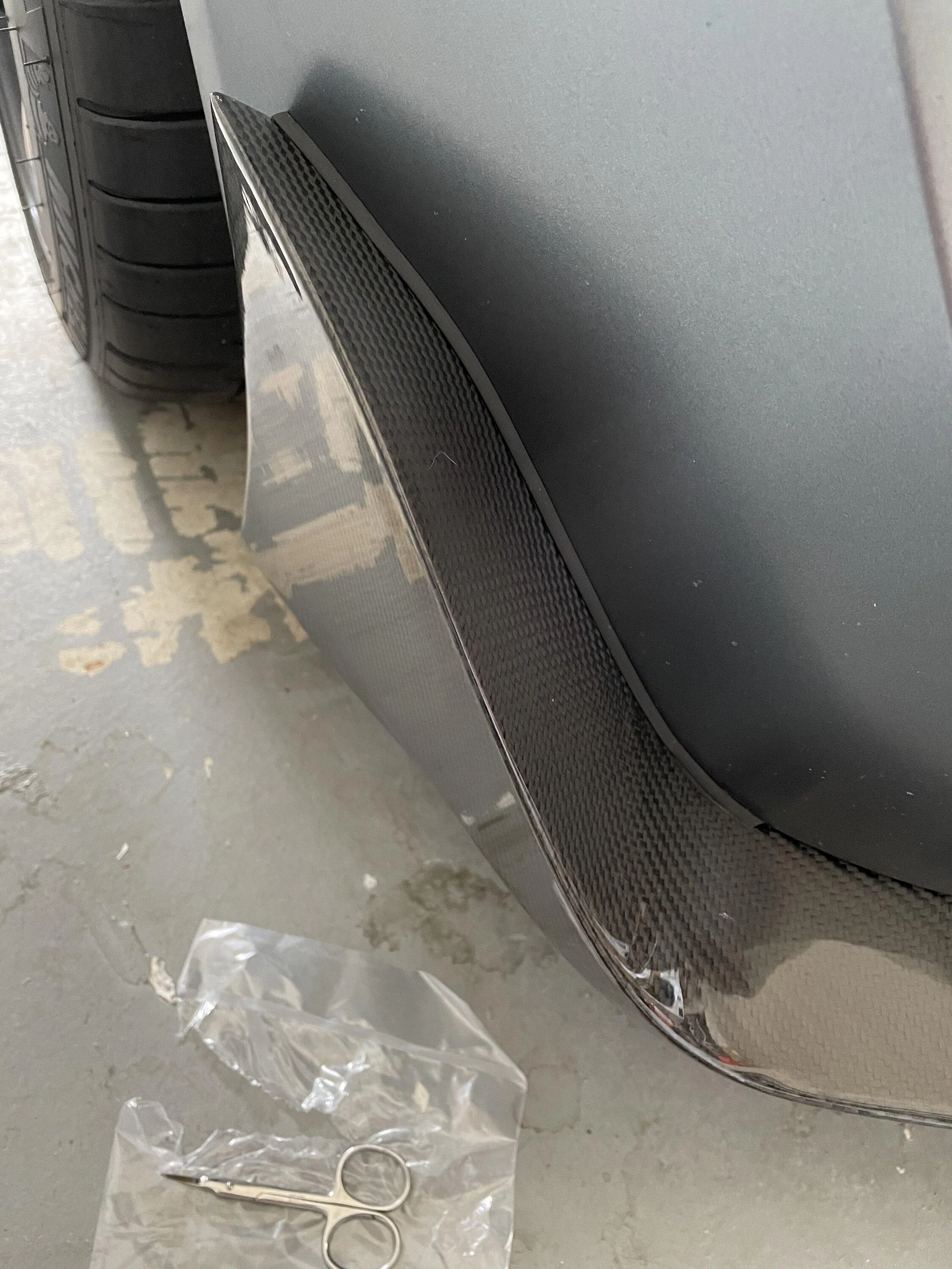

Recently installed the TRD style Rexpeed V1 lip. Fitment & overall quality genuinely surprised me.
However, the side fins use 3M double-sided tape, which leaves a tiny gap. Most wouldn’t care, but I did not want road debris to build up…
I tried out some Honda/Acura body kit gap filler and it worked surprisingly well. Sharing part number because I know some of you NEED this lol.

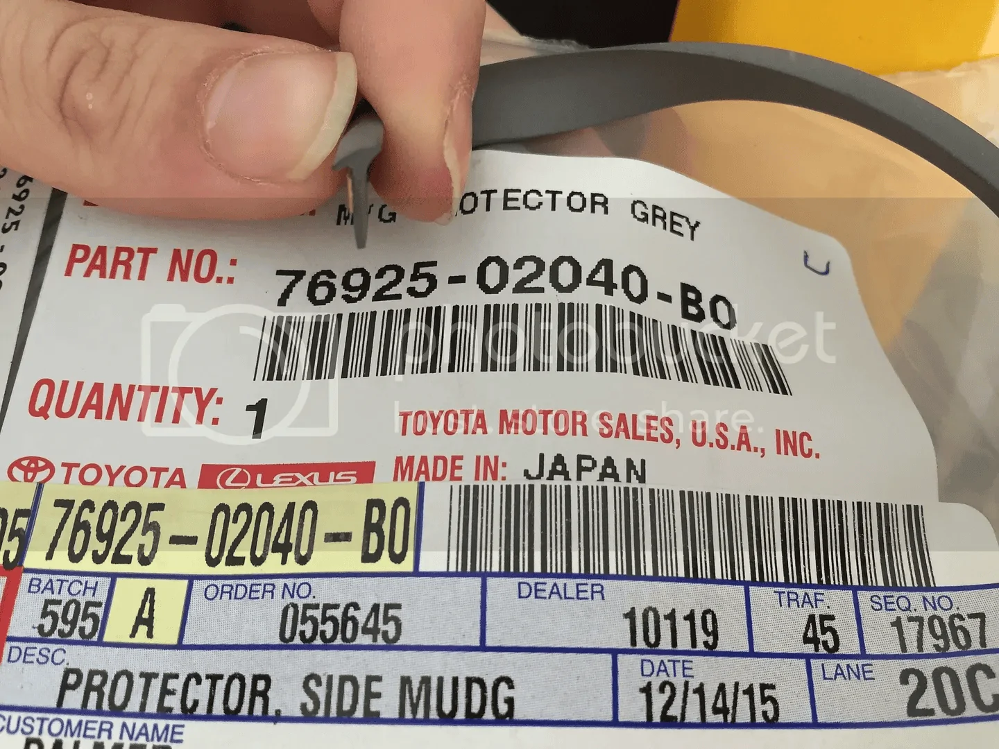

There is also a Toyota variant that seems to be used on Toyota trucks. But I don't know the part number for it anymore.
Edit: Found it!
See last post here: https://www.ft86club.com/forums/showthread.php?t=97815
Part #: 76925-02040-B0
^Mentioned more information for archiving reasons
I used to use that on my Evo for the rear OEM spats lol. If i remember correctly, that corresponds to the S2000 CR's OEM lip gasket.
You remember correctly. I believe I took the part number from an S2K forum lmao.

Do you have a close-up picture before applying the filler? I am debating to get the same lip.
PearlSup
PearlSup
Dec 17, 2021
210
230
SoCal
21' Premium Phantom
I do not, but the gap wasn’t bad (I’m just picky). Fitment is 9/10 which is pretty good for a rep of a complex piece like this.
