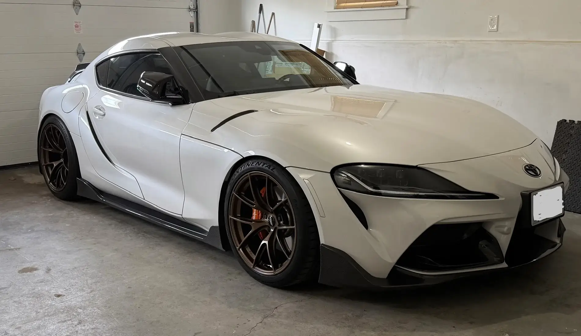

I'm located in South Carolina.
Does anyone know of a reputable shop/company in the southeast near South Carolina preferably, that would offer a service to pull the F/R brakes and offer a powdercoating service to change the color and maintain factory Brembo look (labeling). I'm over the red. I'm willing to travel to neighboring states to get this performed.
Any help would be much appreciated.

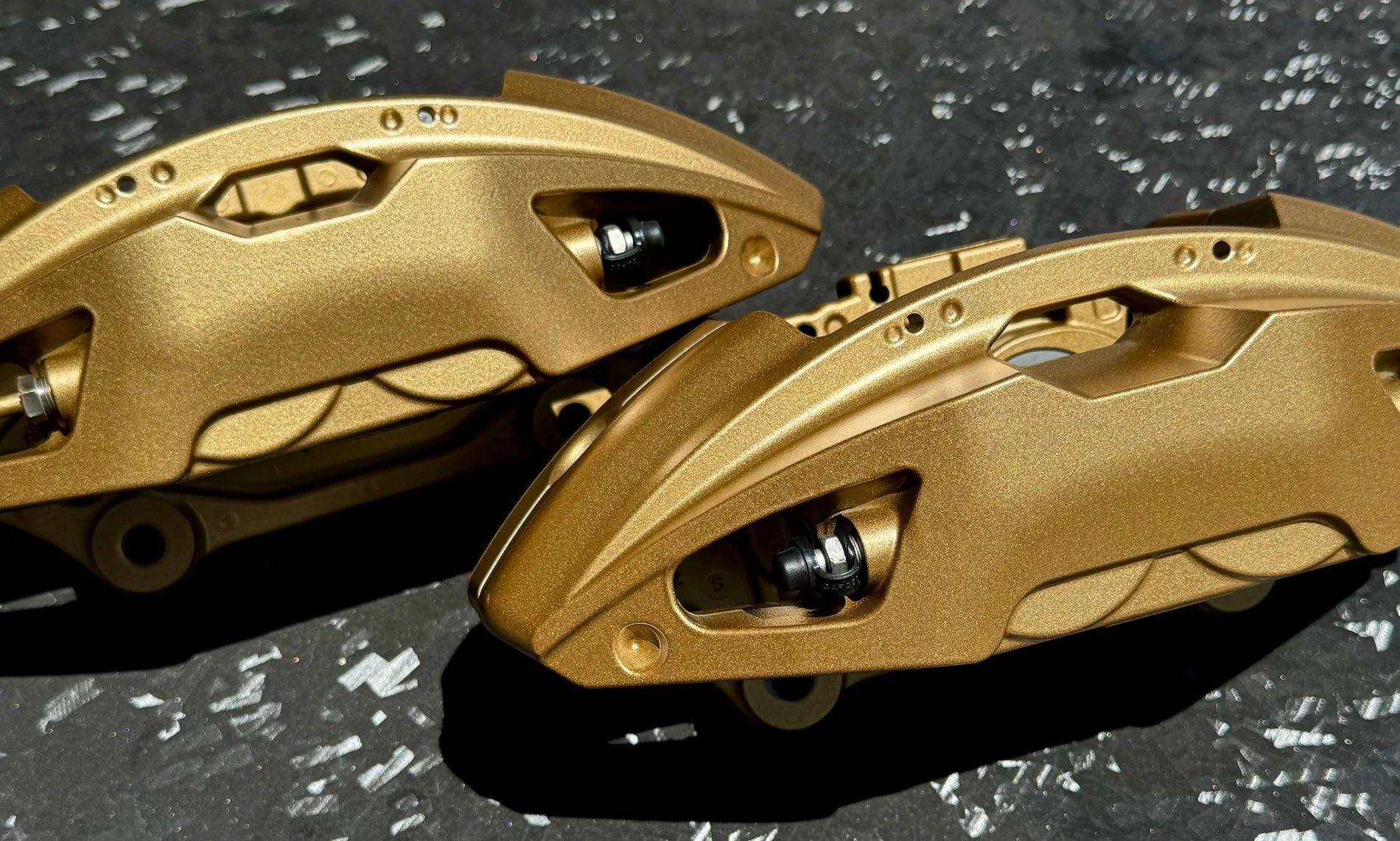

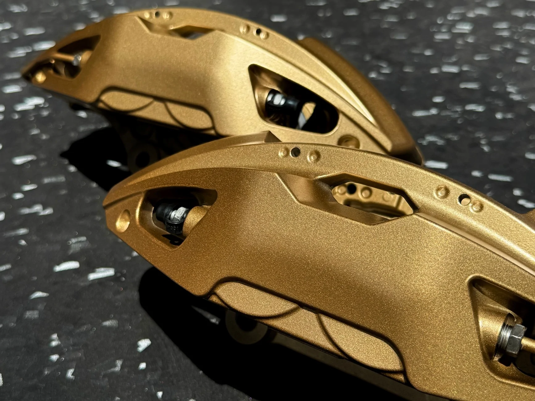

Sleek coating… prismatic powders Spanish gold matte clear full rebuild high temperature seals around 700 with shipping included
rwense
Evan
Dec 10, 2021
47
806
1,314
Pittsburgh, PA
They also do decals, I had my own💪🏼
High temp seals or boots? In my experience the high temp boots dont last but oem seals are fine. I swapped for high temp boots and after like 3 events they've blown out.

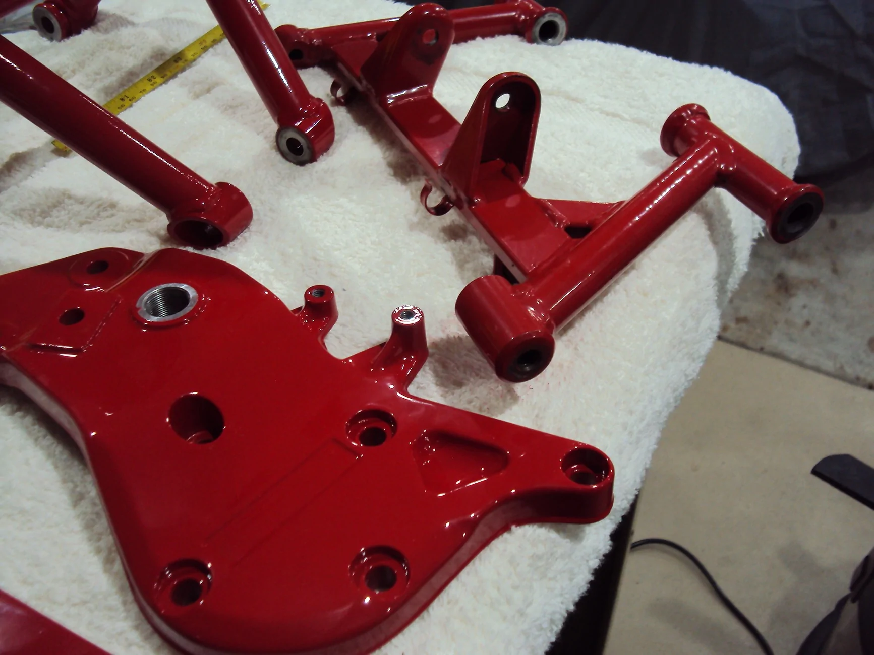

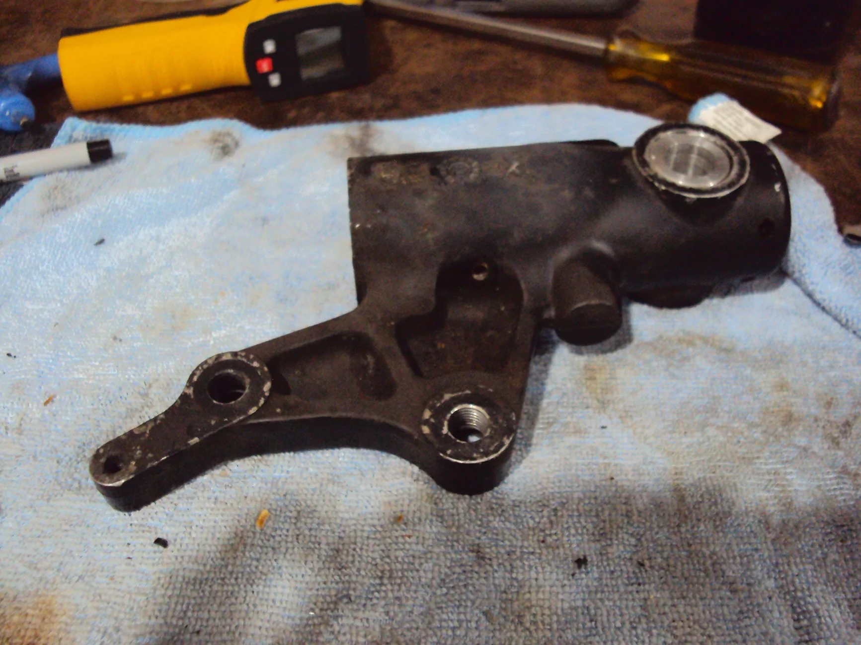

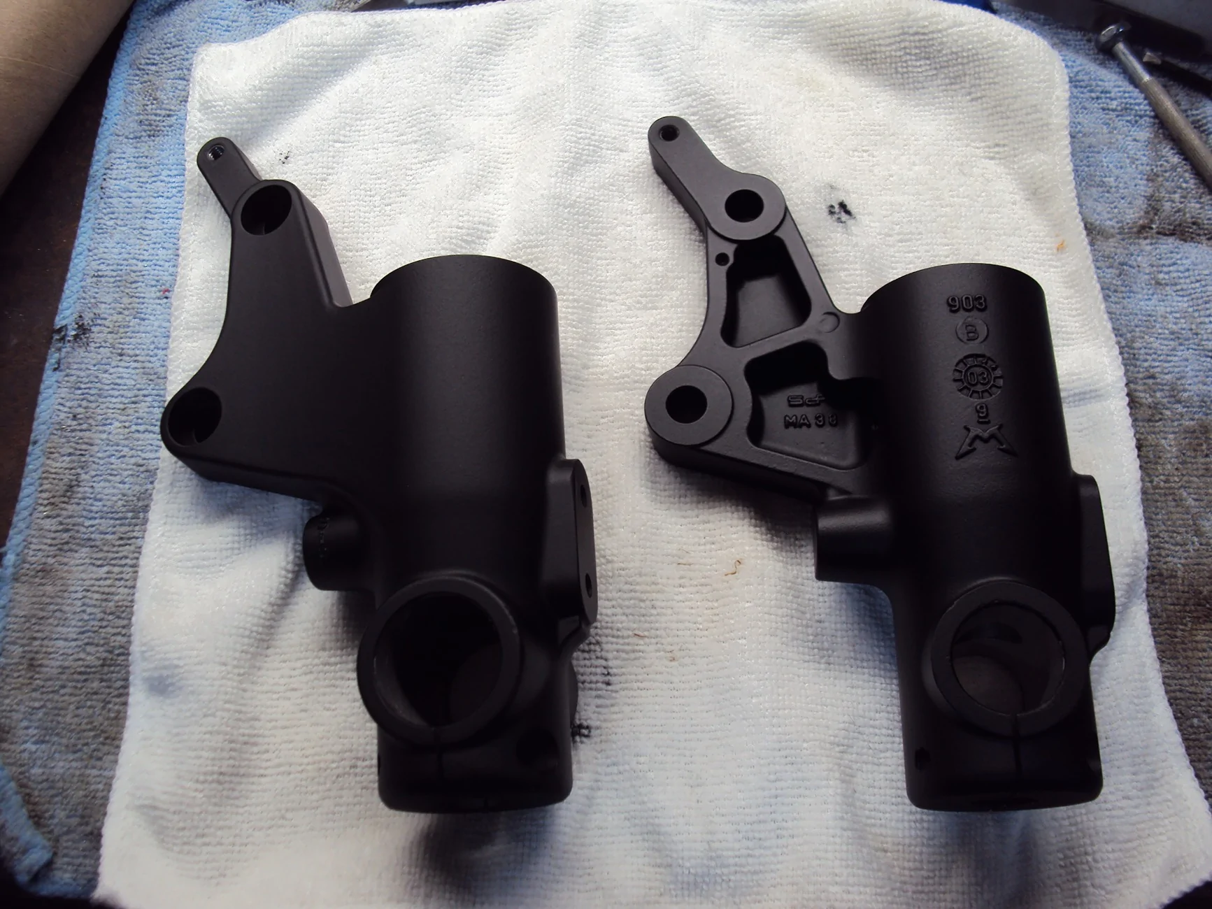

Sorry can't help you there as I'm in Australia. You need to see a professional paint supplier and get them onto your case. My guy sells 2k down to 250ml quantities colour matched to whatever you want. I have all the spray paint gear, compressor etc so I just buy my paint in a normal can. The other option is the same automotive paint supplier and buy yourself a small airbrush which these days are cheap as chips and do it yourself An airbrush will do the job. Mix up 200ml of paint and hardener and the airbrush should have enough capacity to do at least 1 calliper and just keep topping it up.
Here's some bike stuff I did a couple of years ago in 2K. Easy to use and beautiful finish.
The red piece in the background is the original paint and my guy matched it by eye to what I painted in the foreground. The sating black is a before and after shot. I've used it on engines and cylinder heads in the past no issues. So it's totally doable at home. Total cost in materials if you do it yourself I'd imagine in the states less than 100 bucks.
