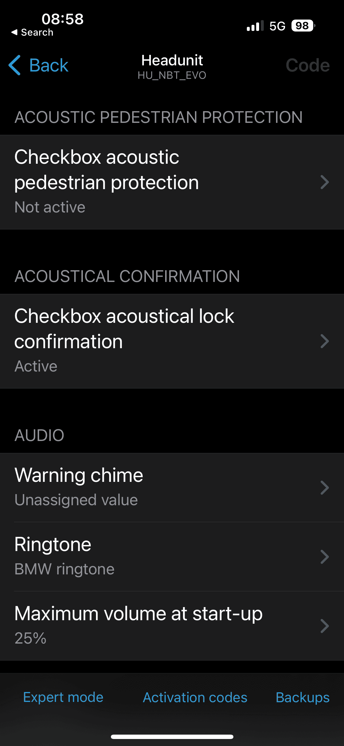

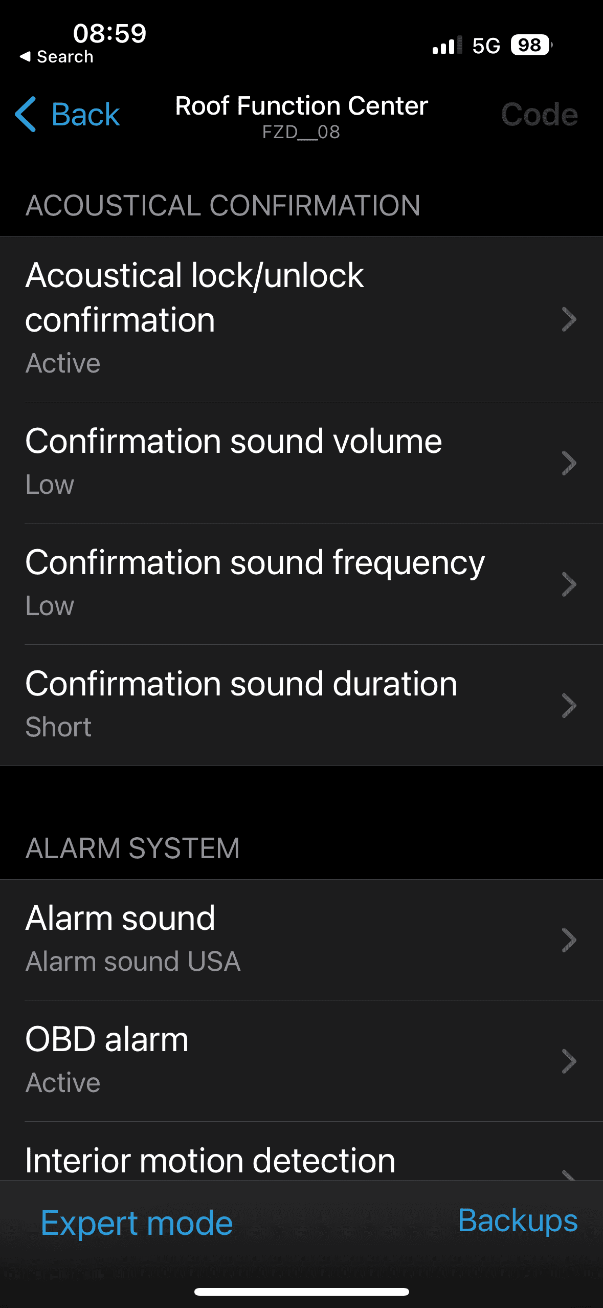

I'm having a very hard time getting the door lock chime to turn off on my new (to me) '21 Prem 3.0. My settings are below in screenshots.
What am I doing wrong?

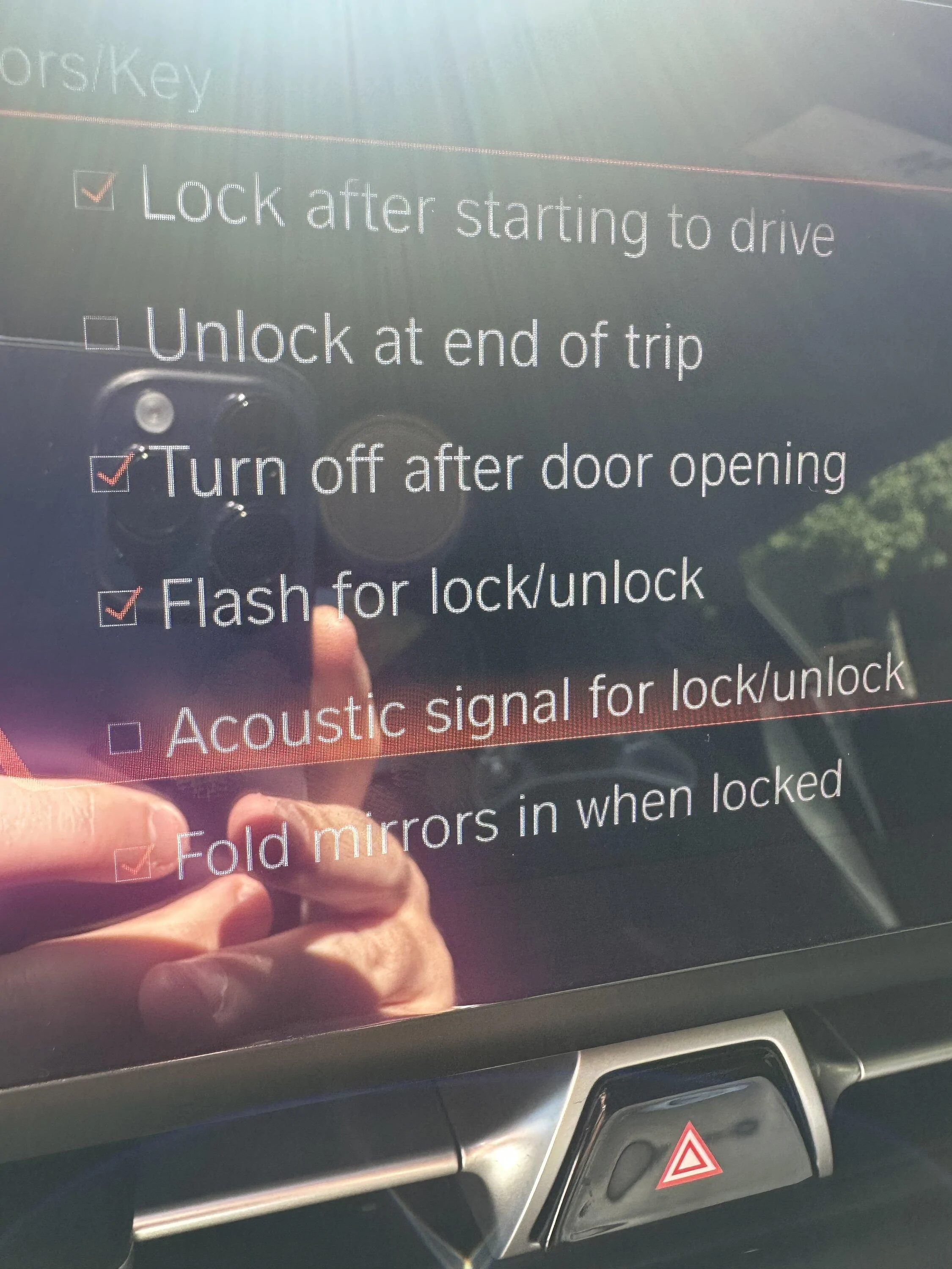

For some reason the car has to be running in order to check/uncheck that box. It could be unchecked but still beeping. If you haven’t, try starting it, checking, then unchecking the box.
Tried that. No change :(

I know I turned it off when I first got mine until we could change the volume/tone. It can be done. Hopefully someone else has an idea since all I’d be doing now is just trying things. Sorry.

No apologies needed sir. I appreciate you trying to help. I'm at my wit's end at this point and can use all the advice you good people are willing to give.
