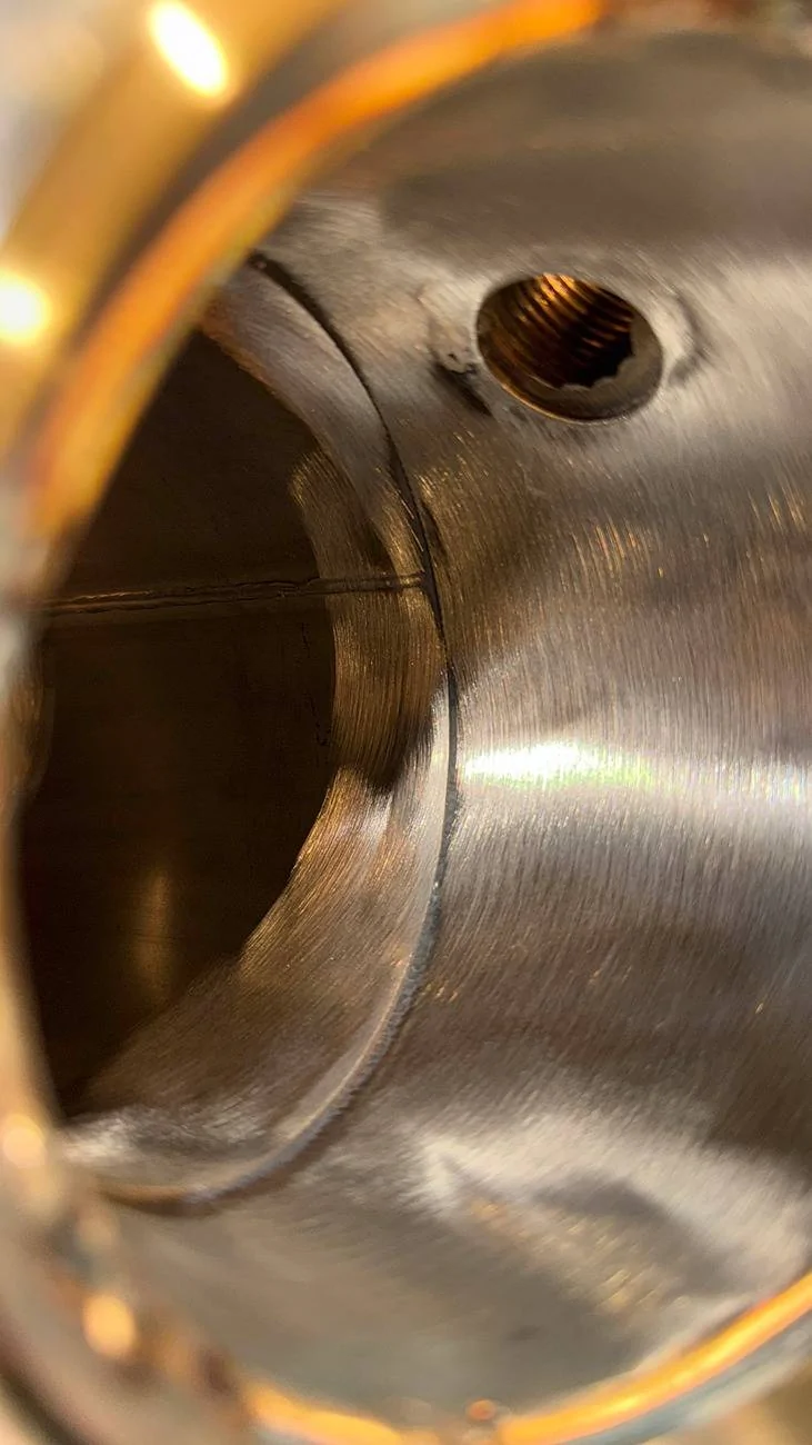

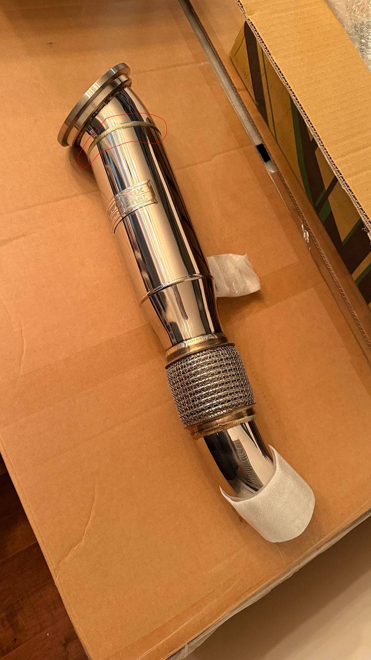

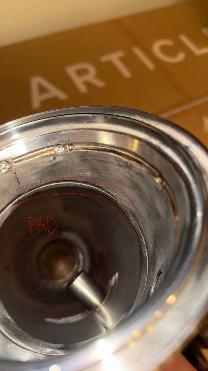

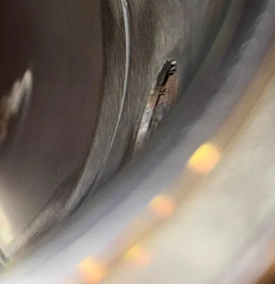

Just bought an Armytrix DP (TOSU3-DD) and noticed a few differences from what others had purchased. Curious to hear from anyone else who recently bought the same downpipe if they had the same issues, I am currently talking with the vendor to see if they can remedy this.
1. Primary O2 bung is off centered inside the pipe
2. There is an extra welded segment just before the primary O2 bung (advertised/customers don't have this, its one piece)
3. On that extra welded segment, there is no penetration on the inner wall or the primary O2 bung
Biggest concern is the welds not penetrating, will definitely fail after a few heat cycles I bet.
