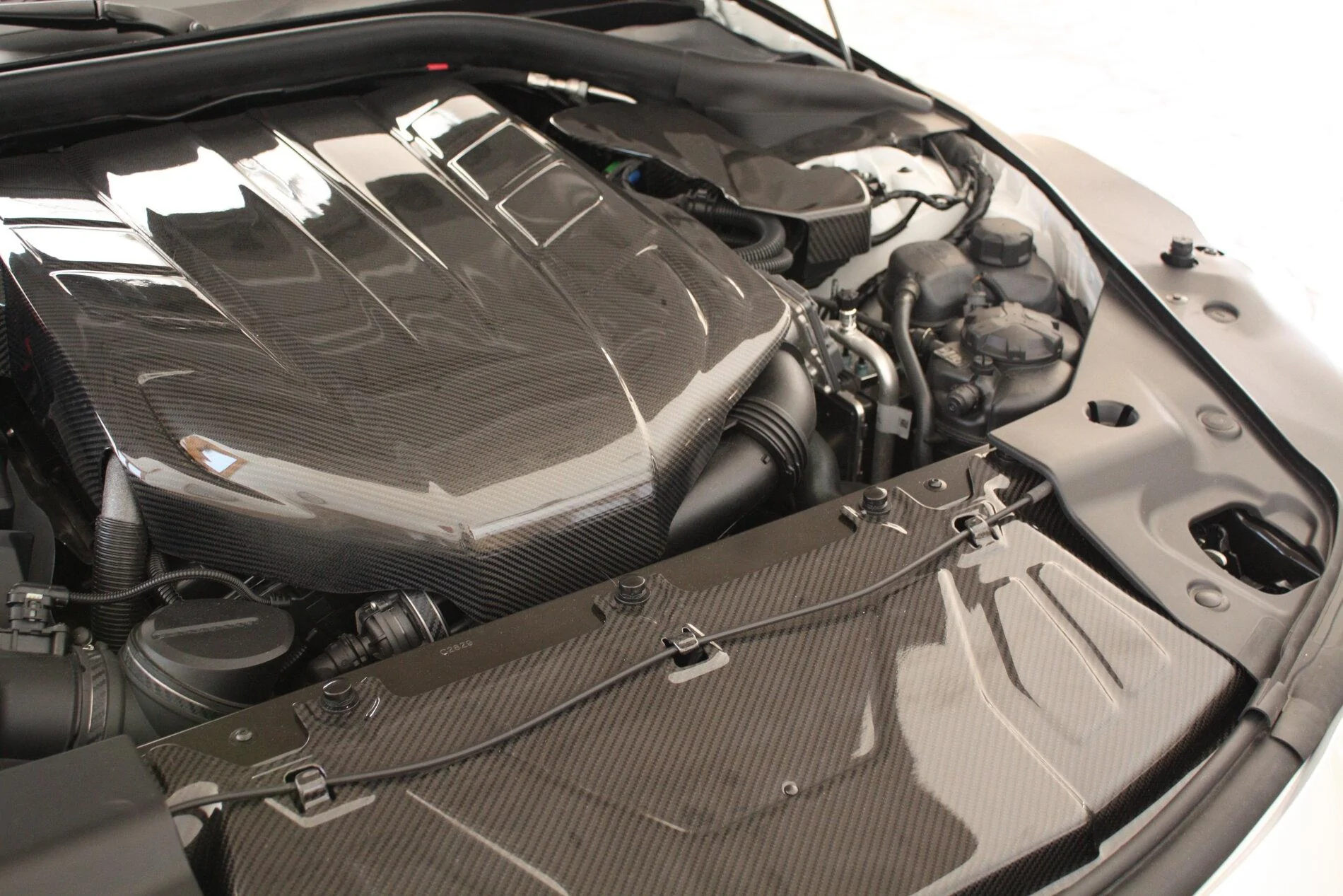

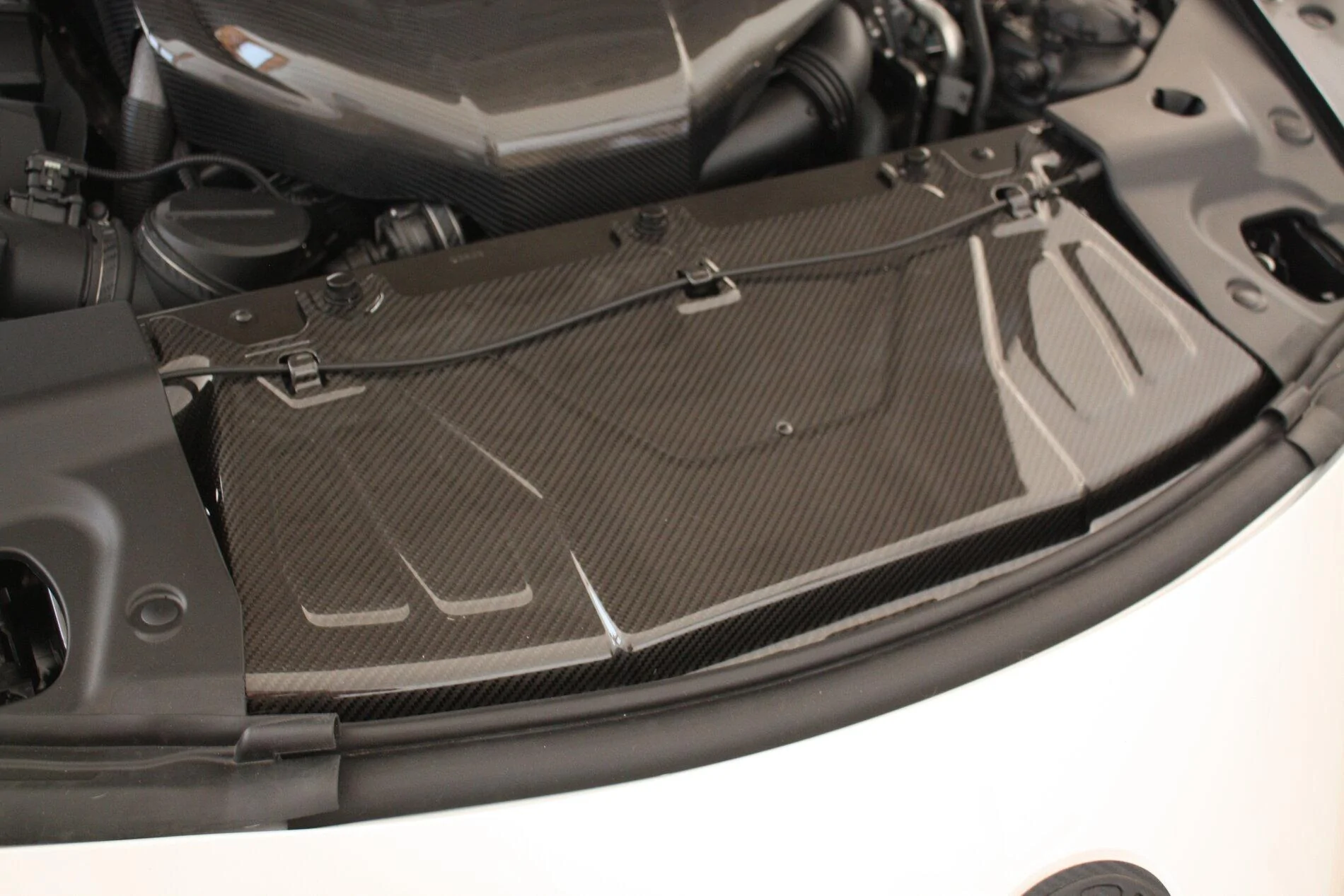

any chance you have a walk through in installing this piece? there are 2 bolts in the front end, that seemed to be impossible to removed, unless bumper is removed. i hate to removed the bumper when possible. thanks!
It is not too difficult. NV has a video of the install procedure. Basically it is just loosening or removing bolts and taking off the metal cover before replacing with the cf cover. I did find that I had to remove the four or five bolts that hold the top of the bumper when it meets the radiator cover. I had to then lift up the top of the bumper cover by about a half inch to slip the new radiator cover in place. The fit was excellent, as was the quality of the cf and the finish.

I have installed the same cover. The bolts are tough to get to but when they are loosened you just pull the bumper forward to get the cover on. Took me about an hour.
