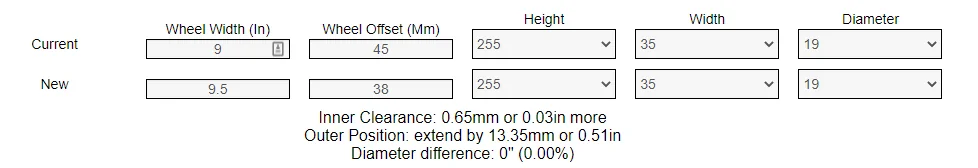

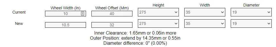

At the end of the month I will be putting an order in for new wheels. I am a little confused and need a little bit of help understanding offsets.
I have ordered the Burger Motorsports 13mm spacers for the front and 15mm spacers for the rear. This would bring the tires pretty close to flush with the fenders based on what others have said with the stock wheels.
The sales rep recommended going with 19x9.5 +25 offset wheel with 255/35R19 tire on the front and 19x10.5 +32 offset wheel with 275/35R19 tire on the rear. I assume this is plus the 13mm and 15mm spacers.
The rep said I should get a similar outer wheel location to the stock wheels with the spacers. So why does this say the outer position is going to be out almost the 0.5" wider for each of them. Do I not need the spacers on the new wheels? Help. This is all new to me. Am I adding numbers together wrong?

The different offset means the spacers are "built in" to the wheel. So you won't need them if you get the right specs. Spacers push the wheel further to the outside of the vehicle, as does a lower offset by placing the hub deeper into the wheel.

Ok. I realized what I have been doing wrong. I was thinking the spacers helped increase the wheel offset which is not true. The spec I got from the sales rep was for not needing spacers to achieve that flush fender look. This is what confused me. I thought I still needed to use the burger spacers in addition to the new wheels. The outer position for the front is about 13mm and the back is about 15mm, so no spacers needed.

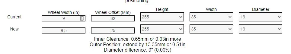

so running +25 on fronts is good no rub? what about +35 on rears? would the 2mm be a big difference?
I have seen people running 19x11 on the rears so maybe not a big difference? It took me too long to understand my offsets so I wouldn't know.

IF you're buying new wheels, you don't want to incorporate spacers. Many of the premade wheels are spec'd for great fitment with no spacers needed.
19x9.5+22/19x10.5+35 is the popular te37 combo.
