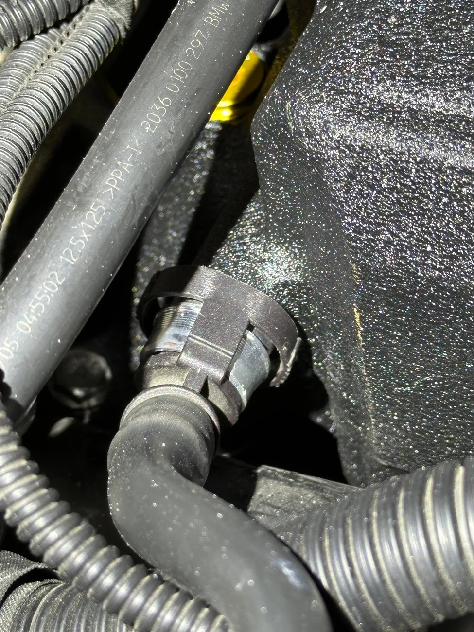

Recently installed a new intake manifold and have a leak coming from the crank case vent tube that connects to the manifold. I think the o ring is bad but I can’t find the part number anywhere for it. Anyone know what it is? I know CSF provides one with their kits but the brand I bought did not include it.

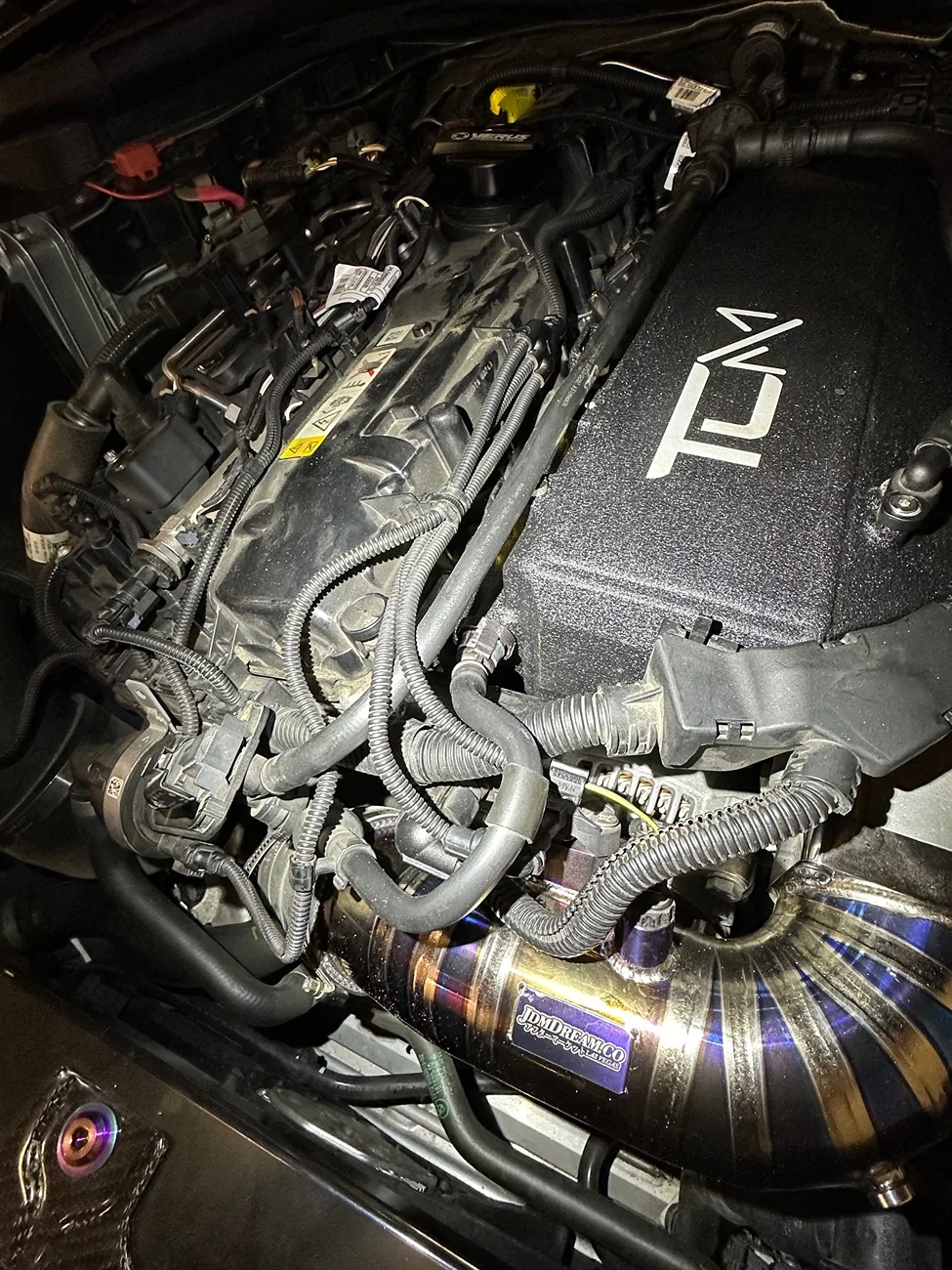

Here is a couple photos. I contacted CSF and they sent me a couple o rings. Seems to have fixed the problem.
