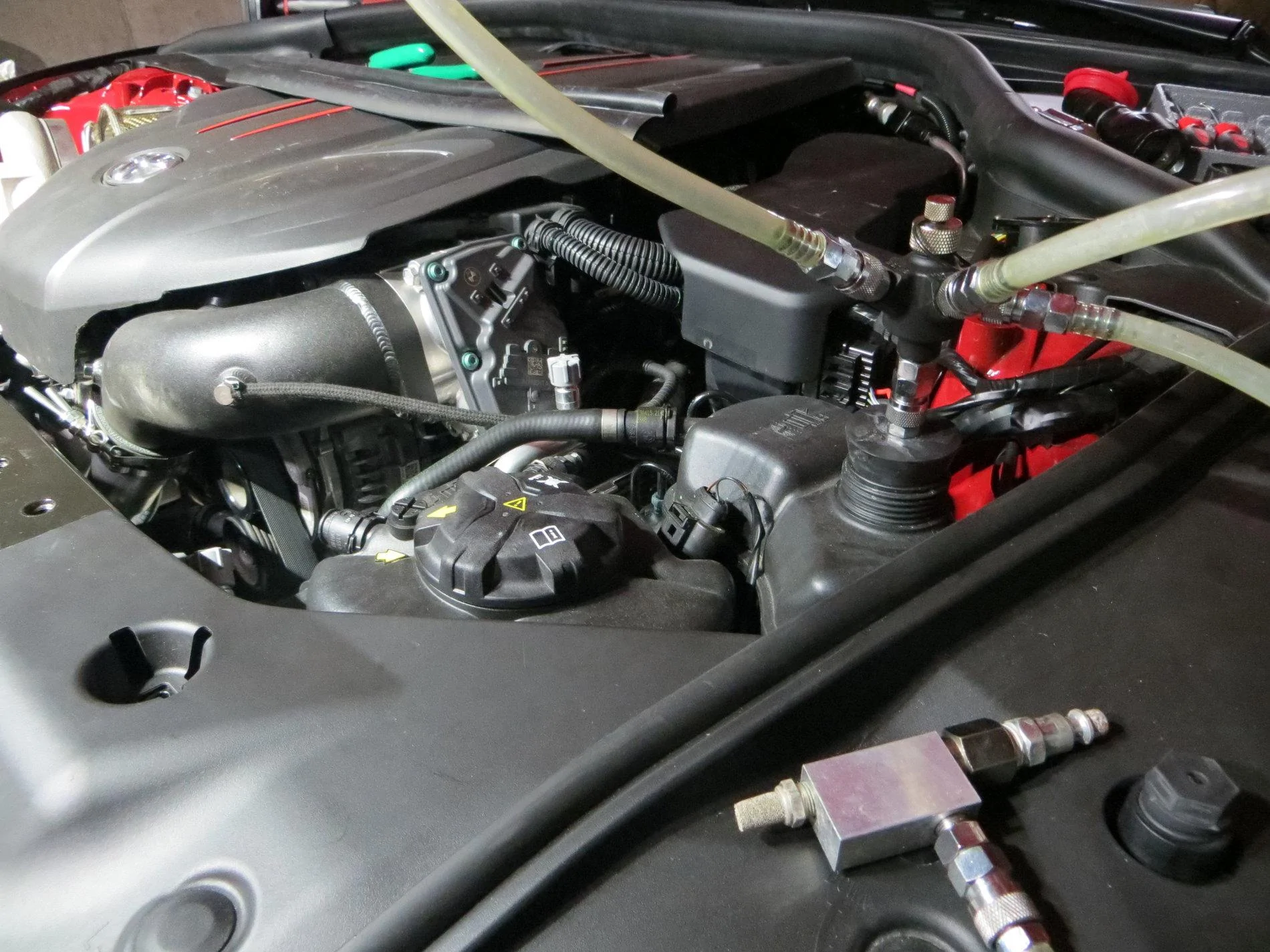

I seem to be having a hard time finding any dealer that carries the FROSTOX HT-12 the part number doesn't seem to be coming up. Does anyone know if the BMW one is pretty much the same or what I should get? Additionally does it need a 50/50 mixture? Lastly for the bleeding of the system I saw this in another thread. Not sure if anyone has done it and can confirm its accurate. I've done other BMWs before and it didn't require the engine to be started just the pressing of the pedal to initiate the process:
open bleeder on overflow
fill overflow to top
close bleeder and replace overflow cap
close hood, make sure car is on ground (not on lift or jacks), apply parking brake
put car in diag mode (ht start button 3 times)
turn on low beam lights, and hazard lights
put heater control on max hot, blower on lowest
hold gas pedal down for 10 seconds (dont step on brake)
release gas pedal and start engine
instrument cluster displays message about service function starting
engine will rev up on its own for 11 minutes then return to idle
let engine cool all the way back off and check overflow tank
Would love everyone's thoughts.
Regarding the bleeding system. The process you outlined is for the high temp/ radiator. For the low temp / intake and turbo you step on the gas pedal until it says service made activated, and you don't start the engine.
