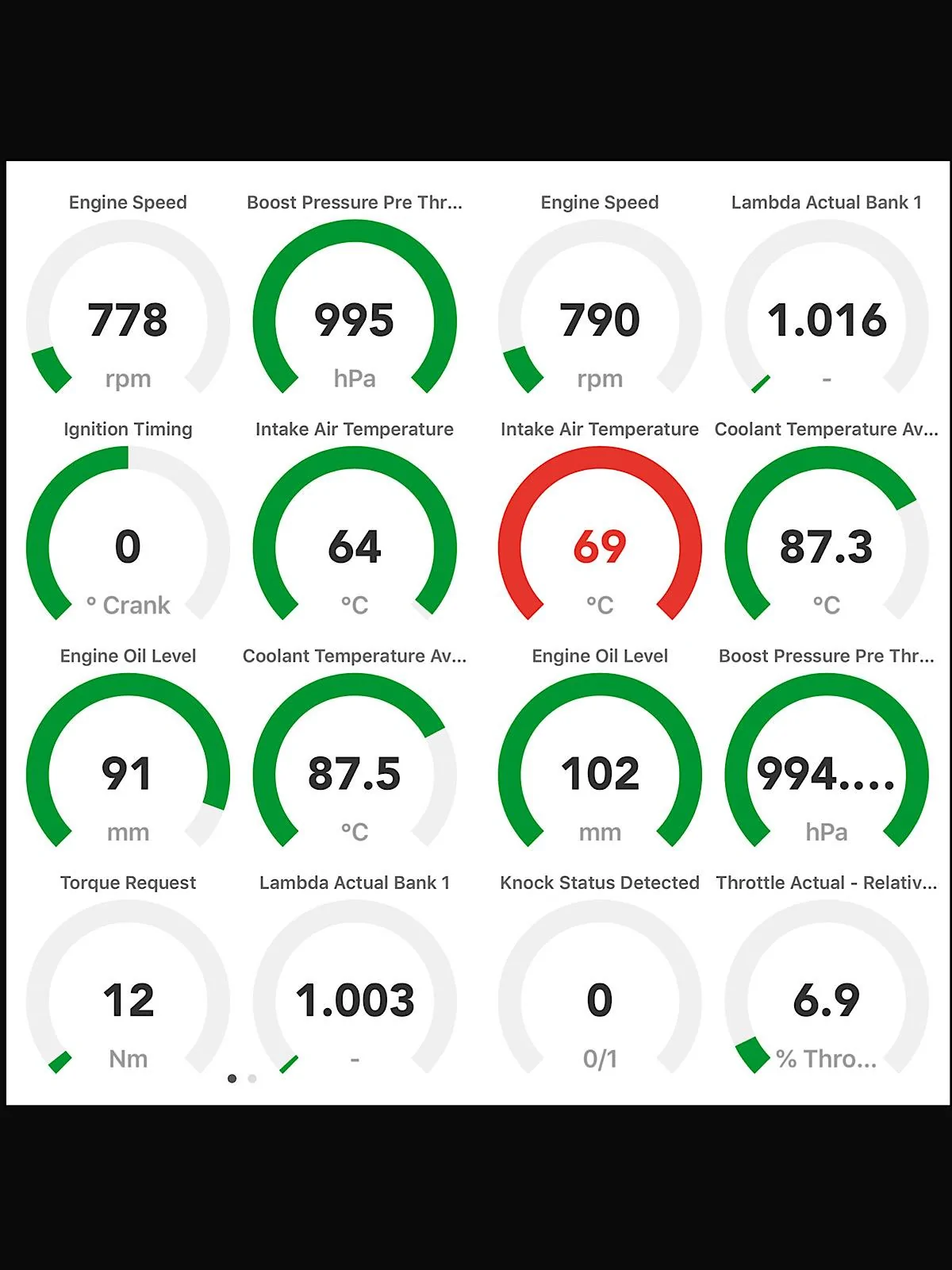

Humidity cleared and wanted to compare IAT in stop & go traffic dry weather both days 48C temps
Left: CSF
Right: OEM
5C temp difference between the two :thumbsup:
