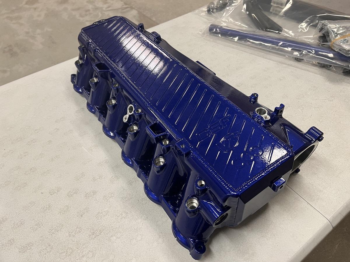

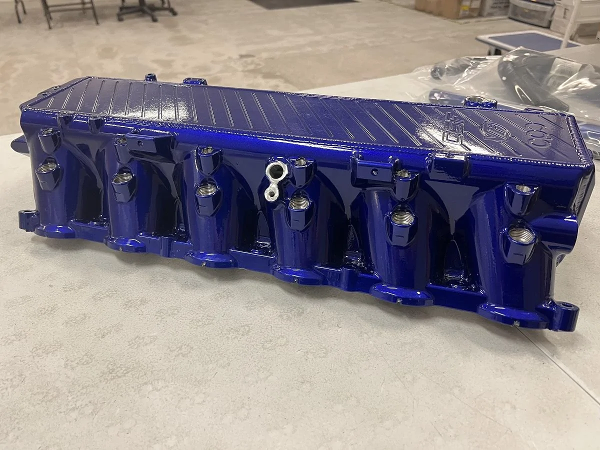

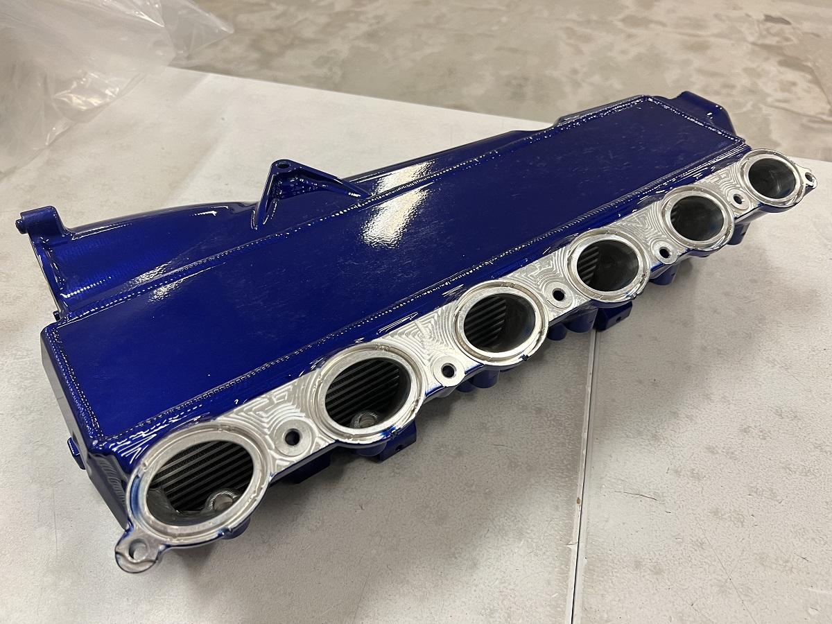

this is a custom product that was sent to a customer. They sent it back, brand new.
The customer had a Gen 1 and this item fits a Gen 2 only.
We are selling this item for lower than our cost as we do not stock customer products.
The retail price is $4599 , selling price is $3599 shipped
First come first serve
DOES NOT FIT 1ST GEN B58 MOTOR
