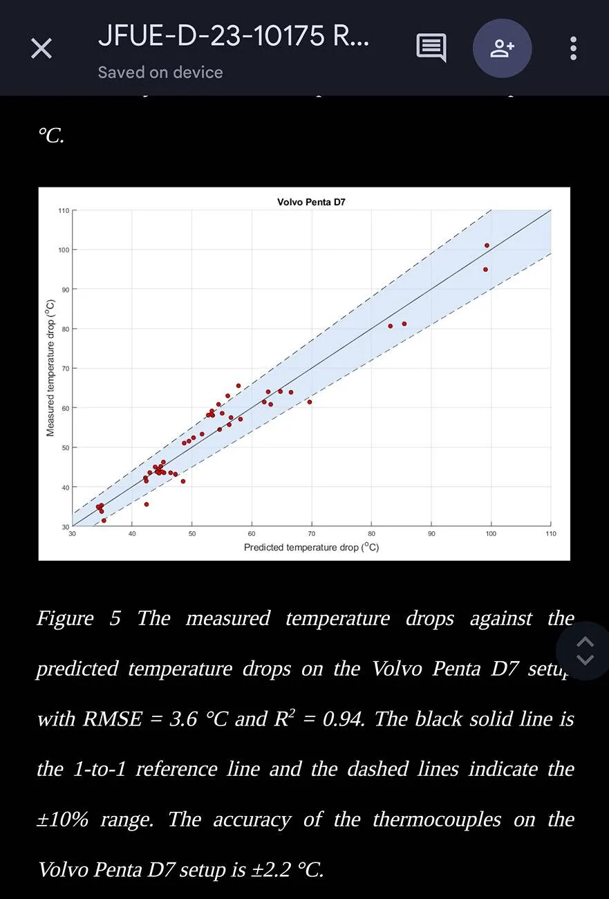

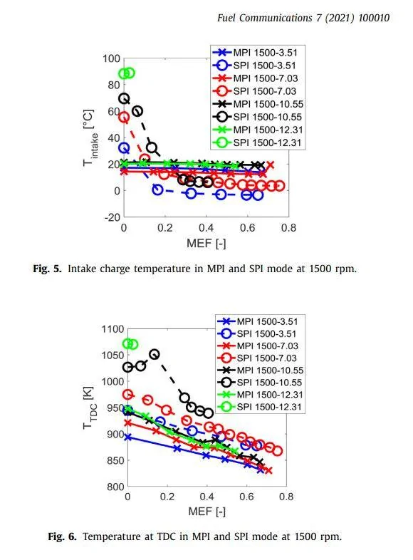

Let's maybe keep the sea water cooled marine boat diesel engines out of this discussion. ;)
I suppose you're right, methanol would vaporize even better in a road-going SI engine, boosting the in-cylinder cooling effect more (even if that's not being measured here). That being said, I don't know the flow rates of the meth systems that people install on B58's, if they approach 20% of the energy fraction needed for that cooling.
8,688
17,031
What I really want to see is a datalog showing 25F *under* ambient IAT's on a B58TU. As claimed. Theory and white papers are cool, but real world data is where it's at.
