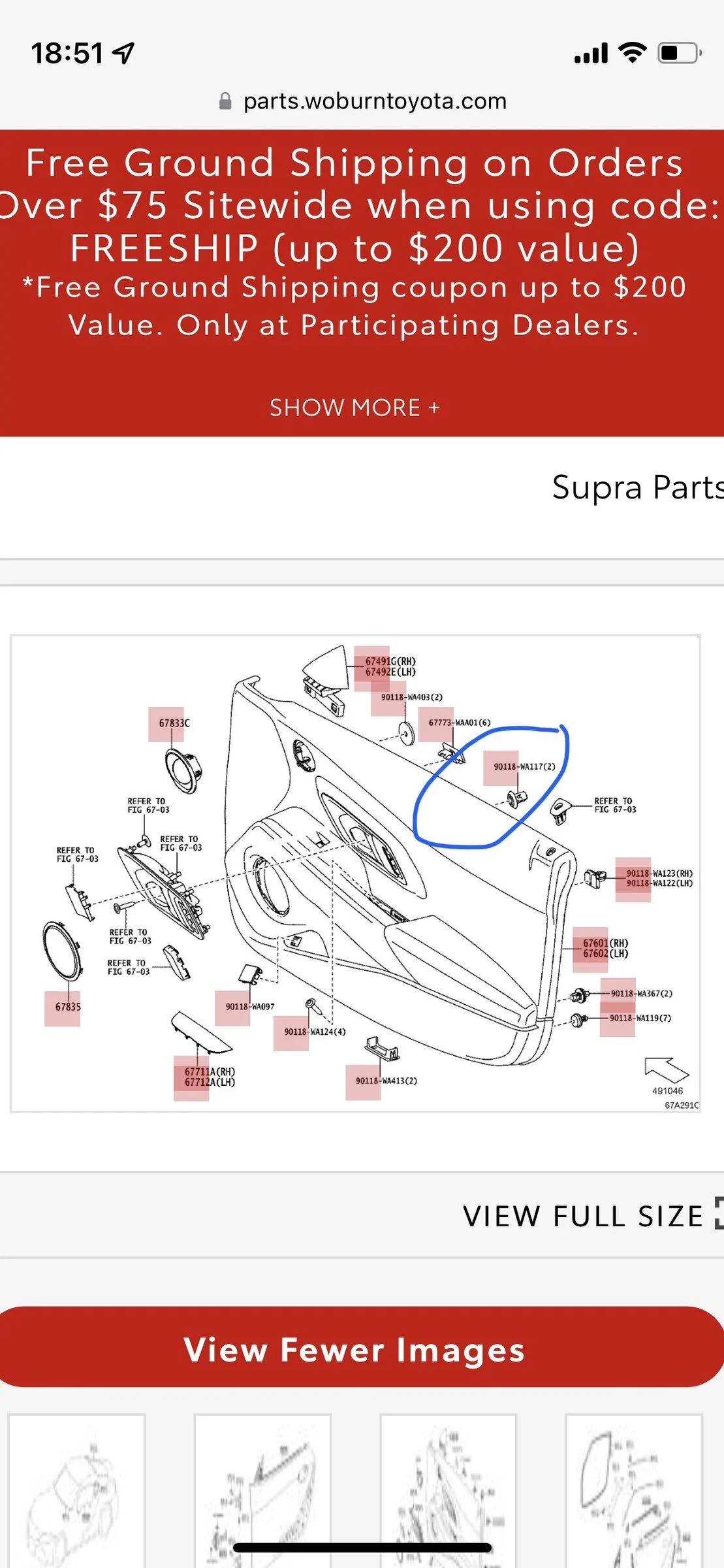

Can’t help with getting behind the speakers but is this the part you’re talking about?

I took off my door panel today and that part(90118-WA117) is spinning freely. Any suggestions?

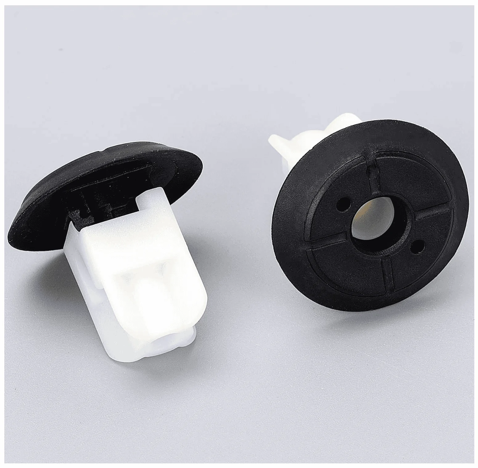

Same thing happened to me. I think this is the one we're talking about, right behind the interior door handle? Mine broke after spinning and all I was left with was the black rubber part.
I think the part number is right, but I just ordered some through Amazon:
Great! I’ll order this. Any ideas on freeing the screw? Currently the screw is spinning freely.
