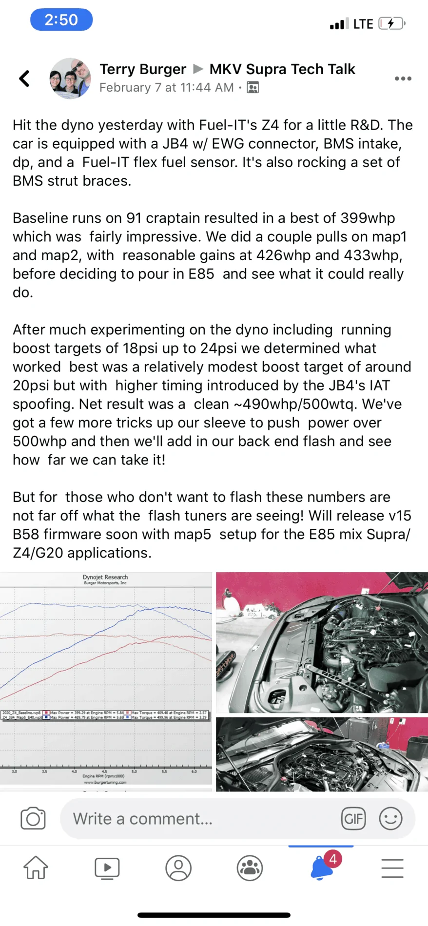

Anybody following this? Map 5 with E85 blend.

Very impressive numbers. I'm currently running Map 3 with E30 and the car is absolutely savage. I'm running a catted downpipe, HKS drop in and the Jb4. Has no trouble lighting spinning the tires at this power level. Can't imagine another 4 psi of boost on top of where it is now.
On map 3 the logs are showing ~15 psi of boost and 15 - 16 degrees of timing at redline. No ignition timing corrections either. Just a smooth ramp up in timing as RPM increases. Pretty impressive.

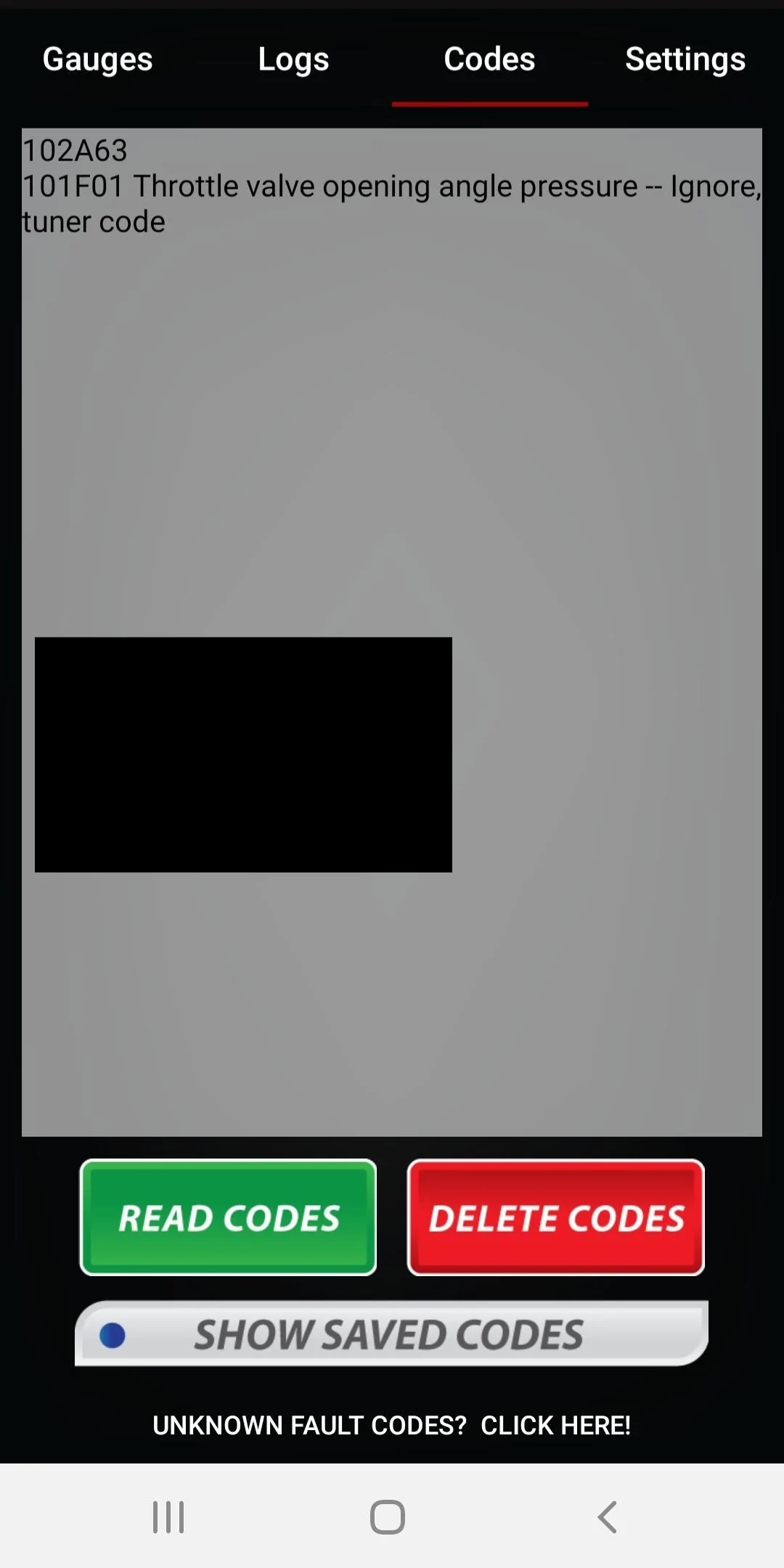

I'm running JB4 map3 with MST CAI and catless DP. It's giving me these codes. I also got the DWP set to 75. Is this normal? Thanks.
