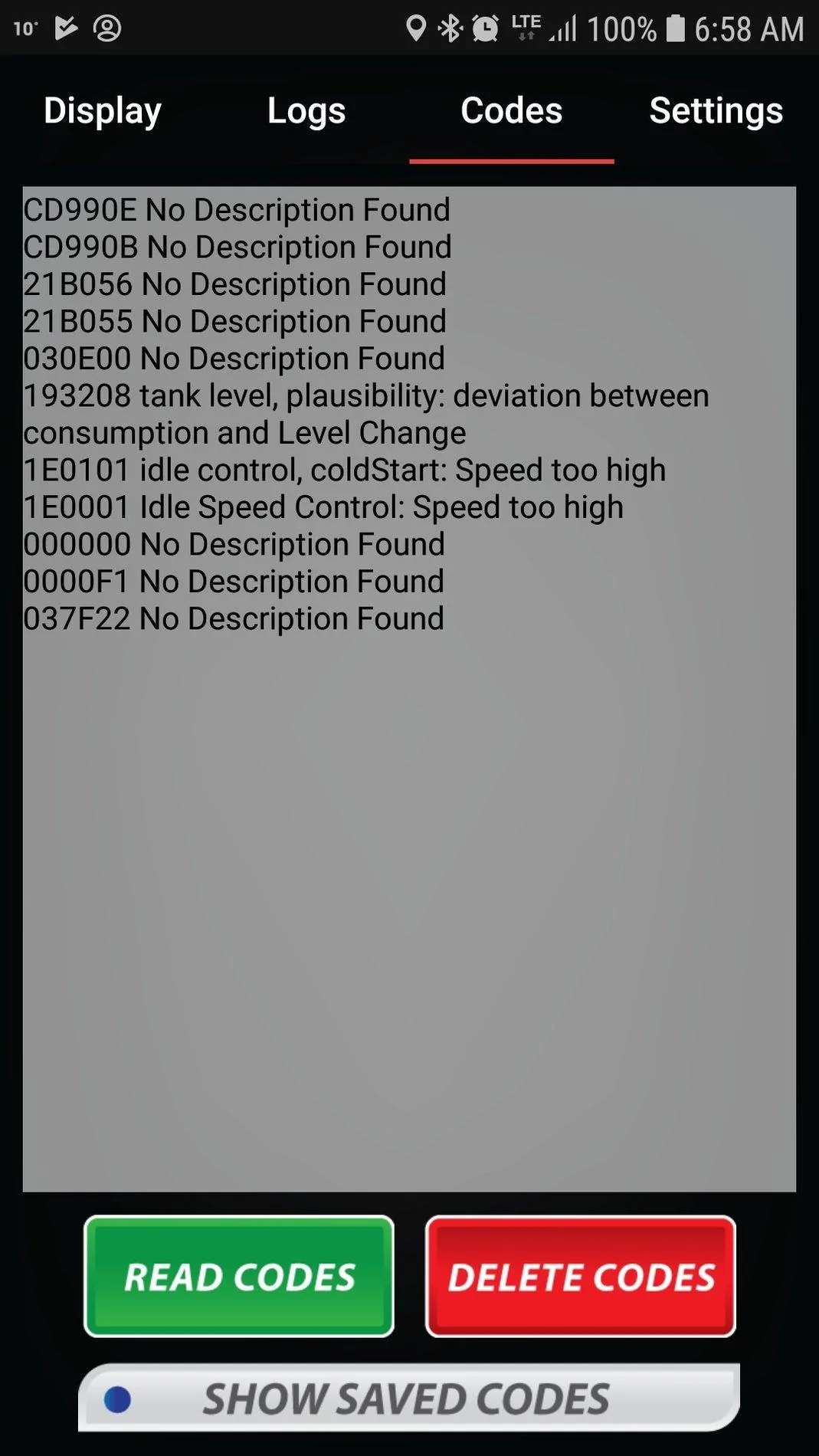

Got CEL today and I sent an email to Terry to see if this is related to the map 3 mapping pushing higher idles. Will report back when he gets back to me.

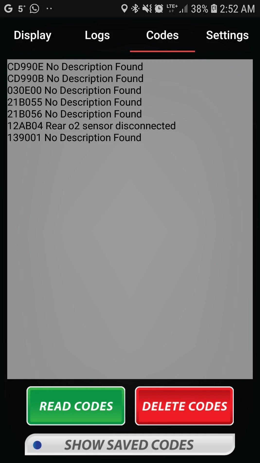

He said it's probably the catless downpipe. I cleared the code but got another one again saying O2 sensor disconnected.

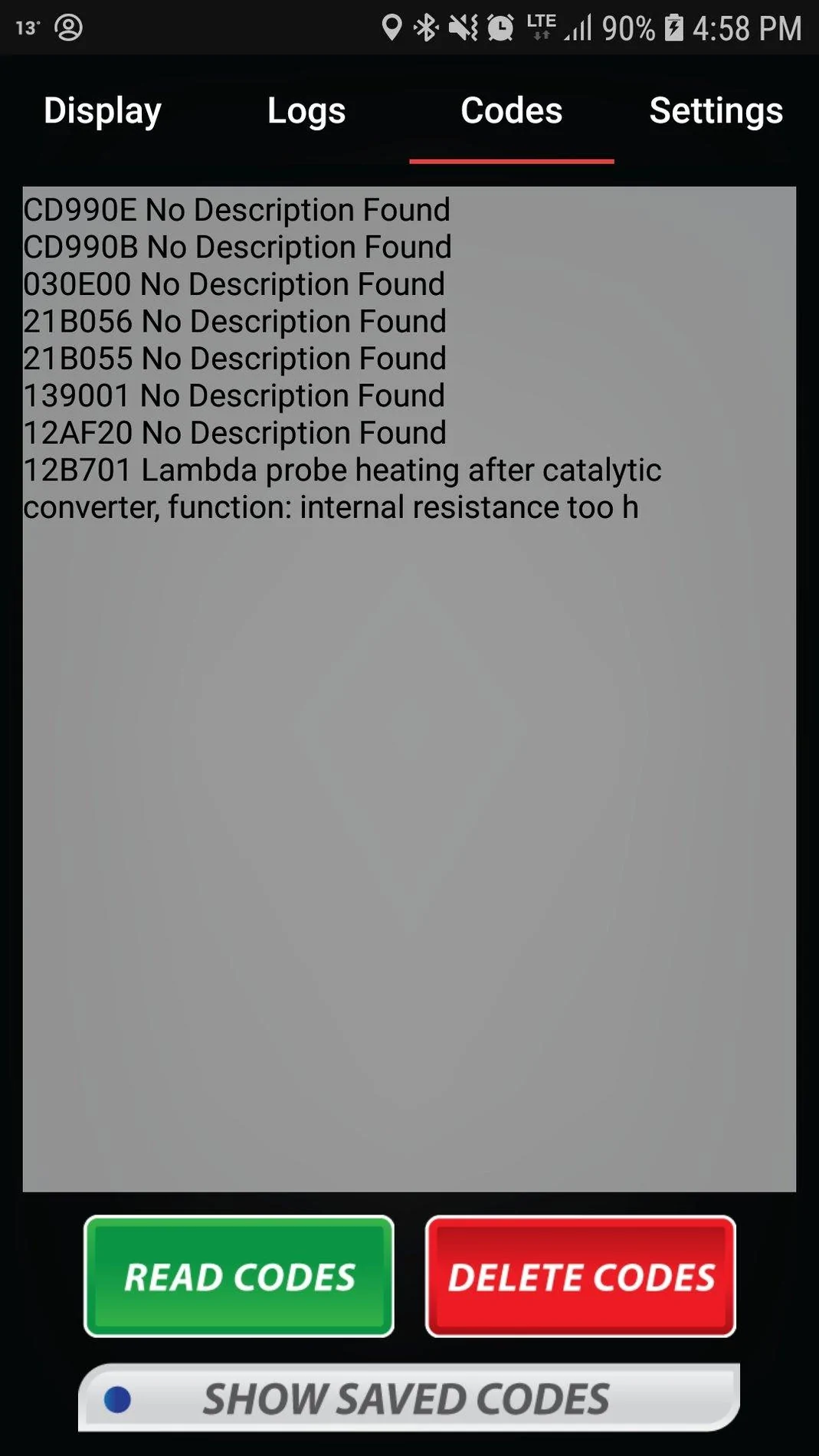

Another CEL showed up today.

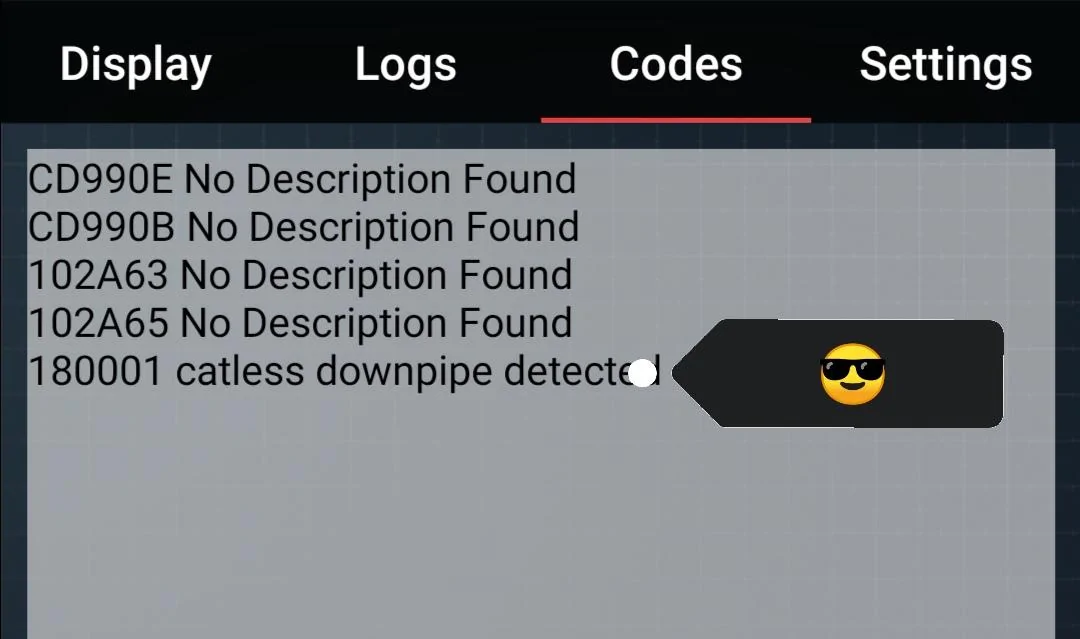

Hey guys, I got something new for you all, so after 50 miles from popping In my Titan downpipe, I got this code.
Man these cars are getting super smart on us, I bet this code will get latched so the dealer can spot it even though I was able to clear it with the JB4.
It's the first time I see this code anywhere online!
Your thoughts?

The BMW fault code for this is actually stating: -> Catalytic converter: Efficiency too low
I am sometimes having the same code when daily driving my car, haivng also a downpipe. But thats normal as we have a front-cat in our EU cars
