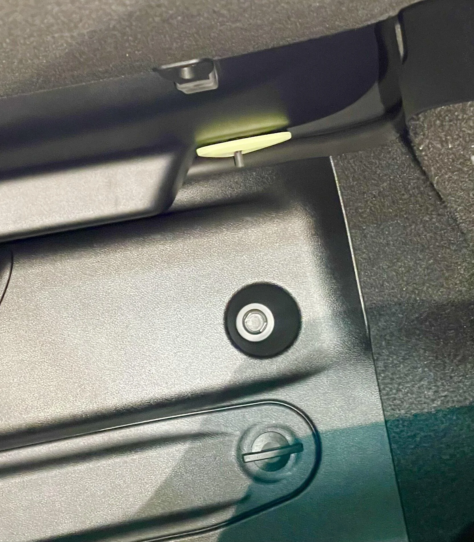

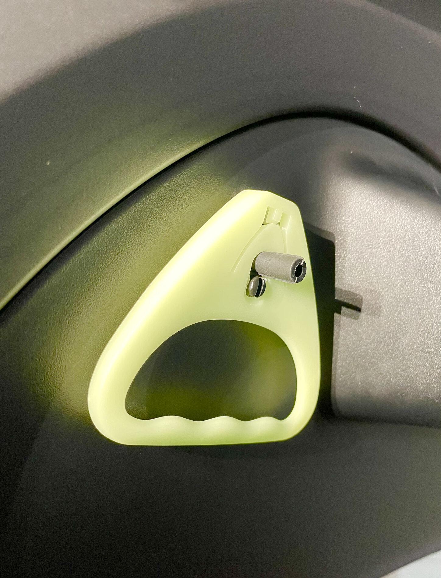

Hey Everyone, here is a quick fix for that emergency trunk latch problem.
The latch falls off easily and gets lodged between the trunk lid and the body of the car. If this happens its a visit to the dealership for repairs.
-RJM

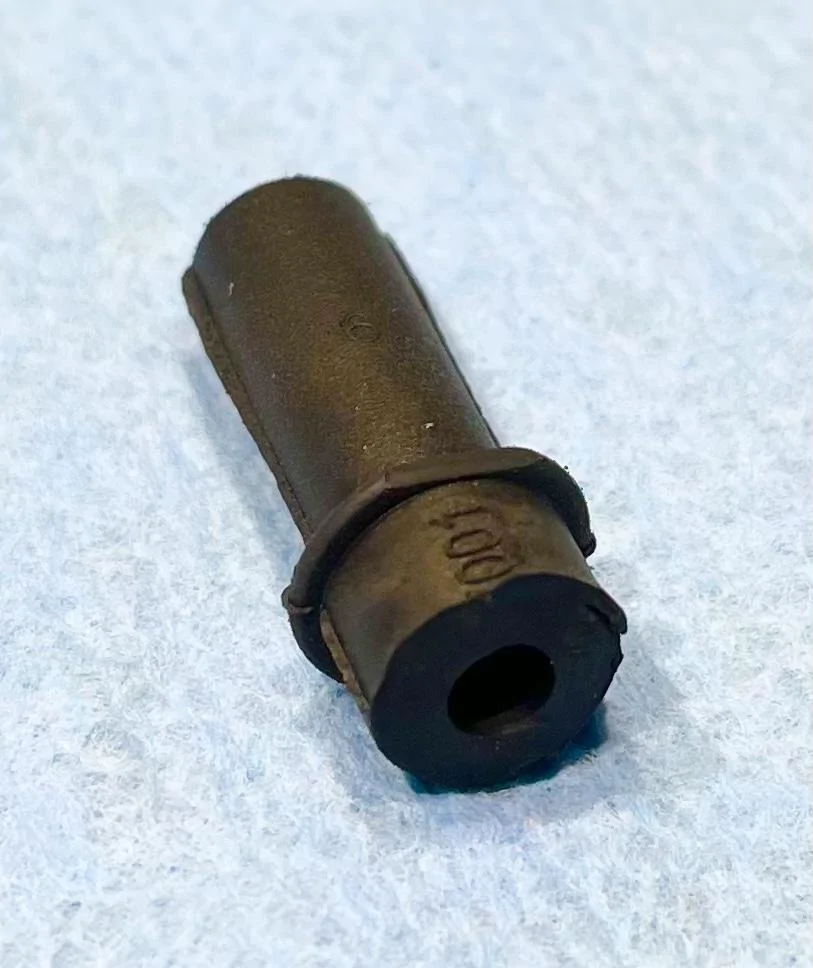

Here is the trimmed connector.
Here is a close up of it installed.
And here is what it looks like with the trunk lid closed.

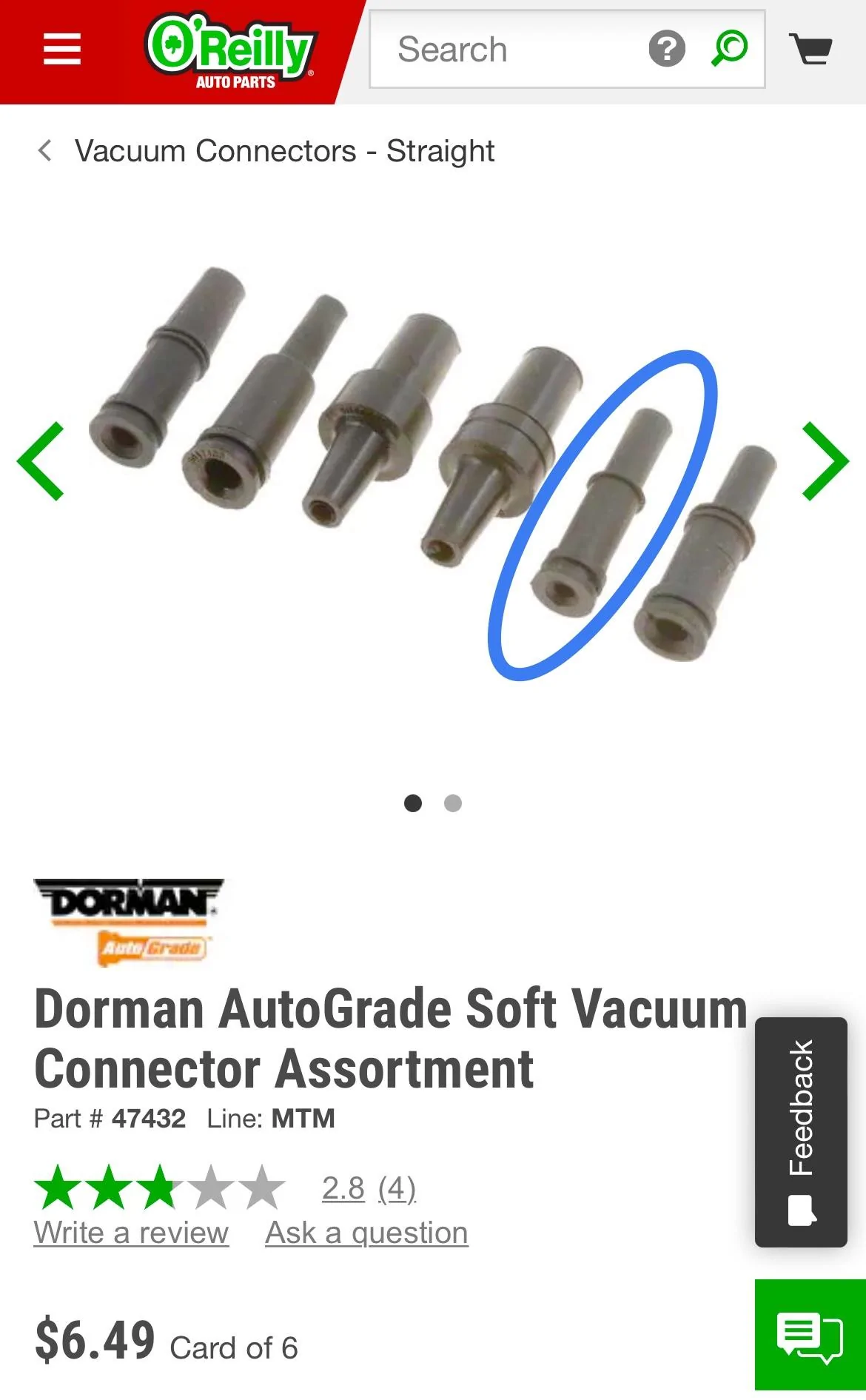

Here is the Doorman part number.
https://www.oreillyauto.com/detail/...-vacuum-connector-assortment/dag0/47432?pos=0

Updated original post with Dorman part number.
