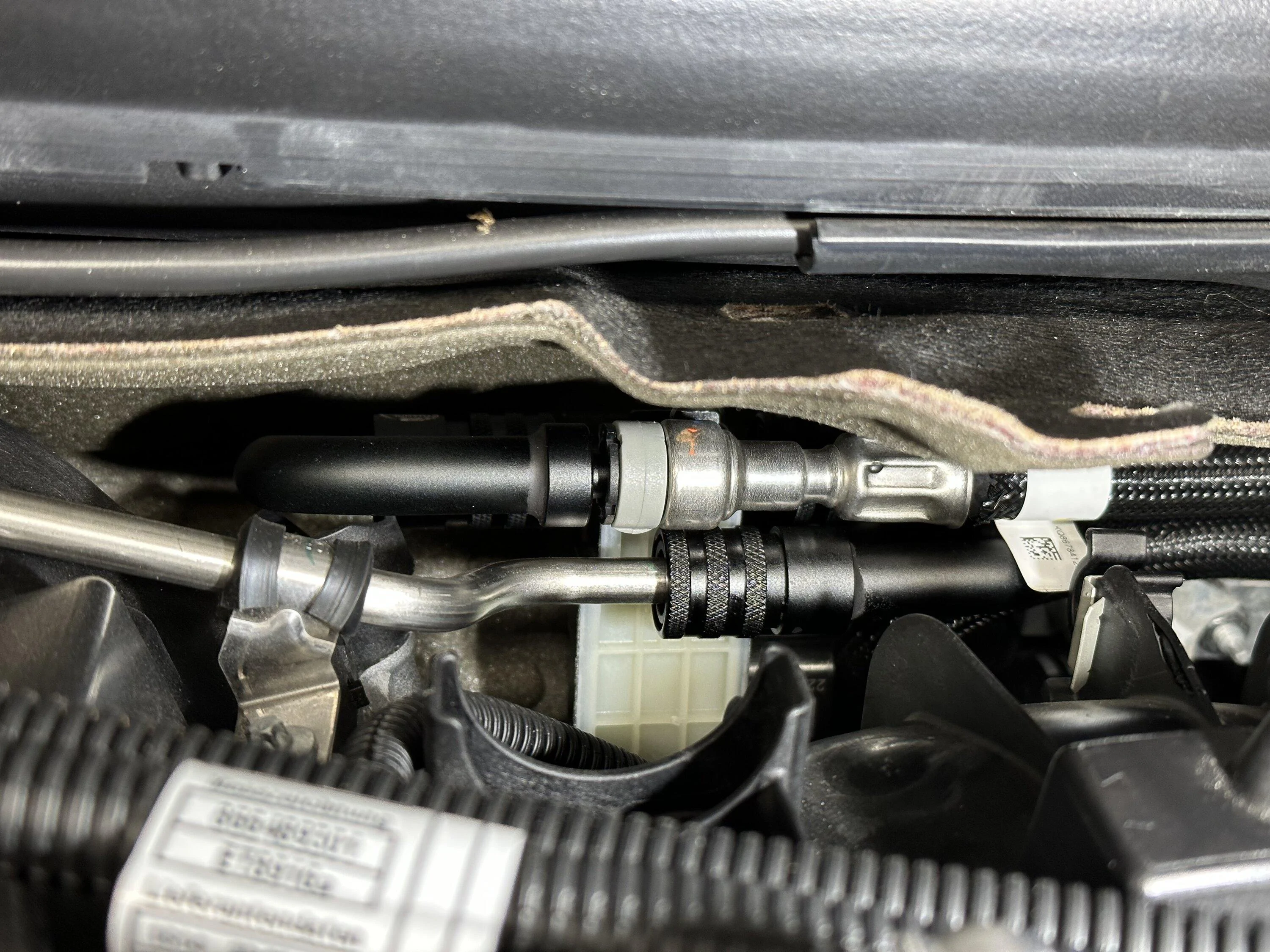

360 fittings work great with the stock fuel line. I installed them recently, zero issues:
