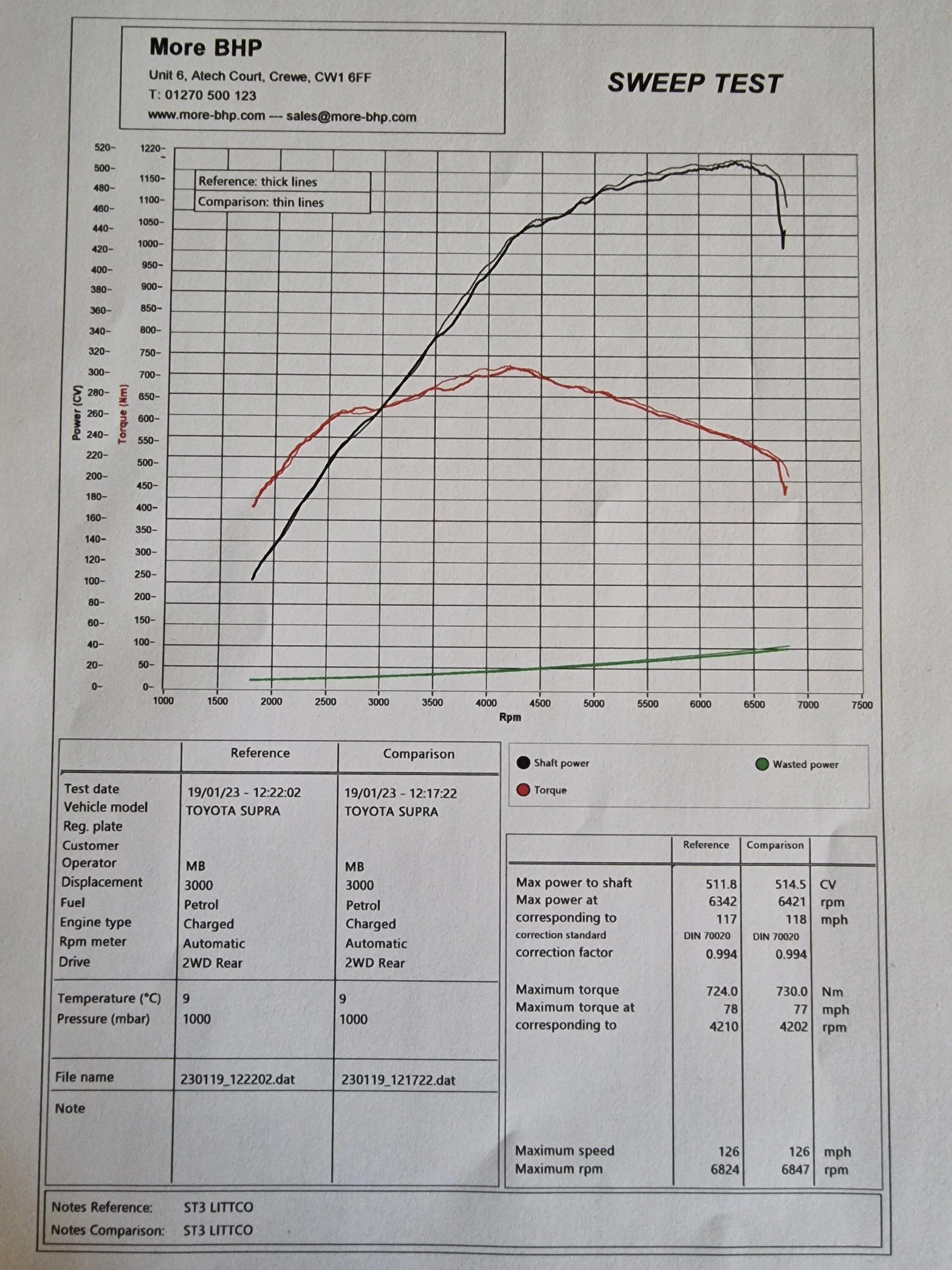

What is the power/torque curve like with the current setup?
Are you pursuing 600bhp for a specific reason?
IME chasing a number results in a lot of £££ for something that can be quite peaky and unpleasant to drive.
This is my graph
BrettMRC
Brett
Jul 2, 2023
214
195
UK
2022 GR Supra, Defender, Rx400h
I'm certainly no expert on the B58, but that graph looks like a very nice delivery - the obvious thing there is the way the torque peaks at mid RPM and drops off. That to me is an indication that you are not able to get air in and exhaust gases out fast enough.
I've seen a few aftermarket intake plenums that may assist with getting volume into the engine, not sure if they require an upgraded fuel flow/injector setup as well though. (assuming the turbo itself isn't unduly restricting the exhaust owing to a poor manifold design etc)
IMO you might be able to squeeze more peak power by changing the mixture, but fundamentally the engine isn't able to move gases through fast enough as it is.
Again - only my opinion, I've been out of the big HP turbo game for about 10 years and only just getting back into it.
