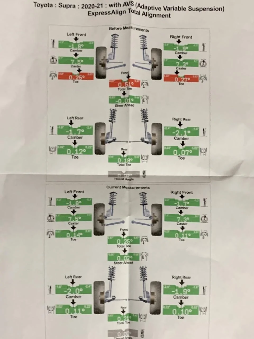

Had my friend check my alignment as the steering wheel was slightly off center, although it did track straight. Car has 150 miles on it, so either off from the factory or during transport.

With 3000 miles, I just had the car aligned. For those don't know, there's a real problem with the factory alignment. 3 of the 4 wheels were out of alignment. You have 12 months/10K miles from the date of purchase to have this covered under warranty. I missed it by two months. <argh!>
