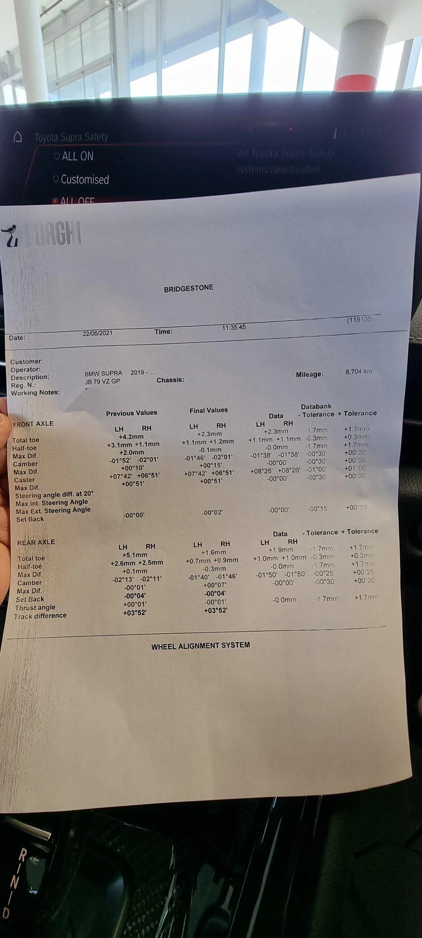

Feedback on my alignment sheet

Hi there...this is my first post on the forum so I hope it's ok that I request feedback regarding my alignment sheet .My car is lowered on tein springs and some spacers
I just want to find out if the settings looks accurate or good? I'm from south africa and the system the service centre used said bmw z4 and he did do some manual tweaking !
Appreciate any comments from the suspension gurus

There isn't anything wrong with those numbers. Personally I would have had him keep rear camber around -2 deg. He pulled you all the way back to around 1.7ish. The specs for the car are 1.7 to 1.9 to begin.

Dude, each car reacts differently to given alignment specs; other peolpe's opinions cannot match the way the car feels when you drive it...Go drive and compare befor/after!
