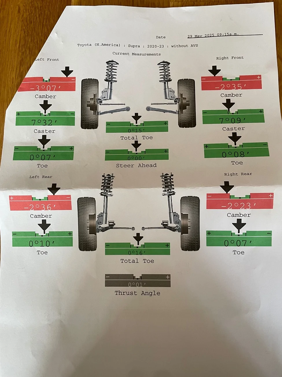

Mine if you want to add it.
Would be interested in any advice.
None of it is adjustable and I’m considering getting some suspension secrets bits and changing it but not sure what to aim for?

Not as far as I know. Had it for about a year.
think it’s been lowered in a previous life
In that case, I would pop off the strut cover on that side and see if there's a secret camber plate hiding there. Otherwise, if the lower control arm is stock, something's bent
